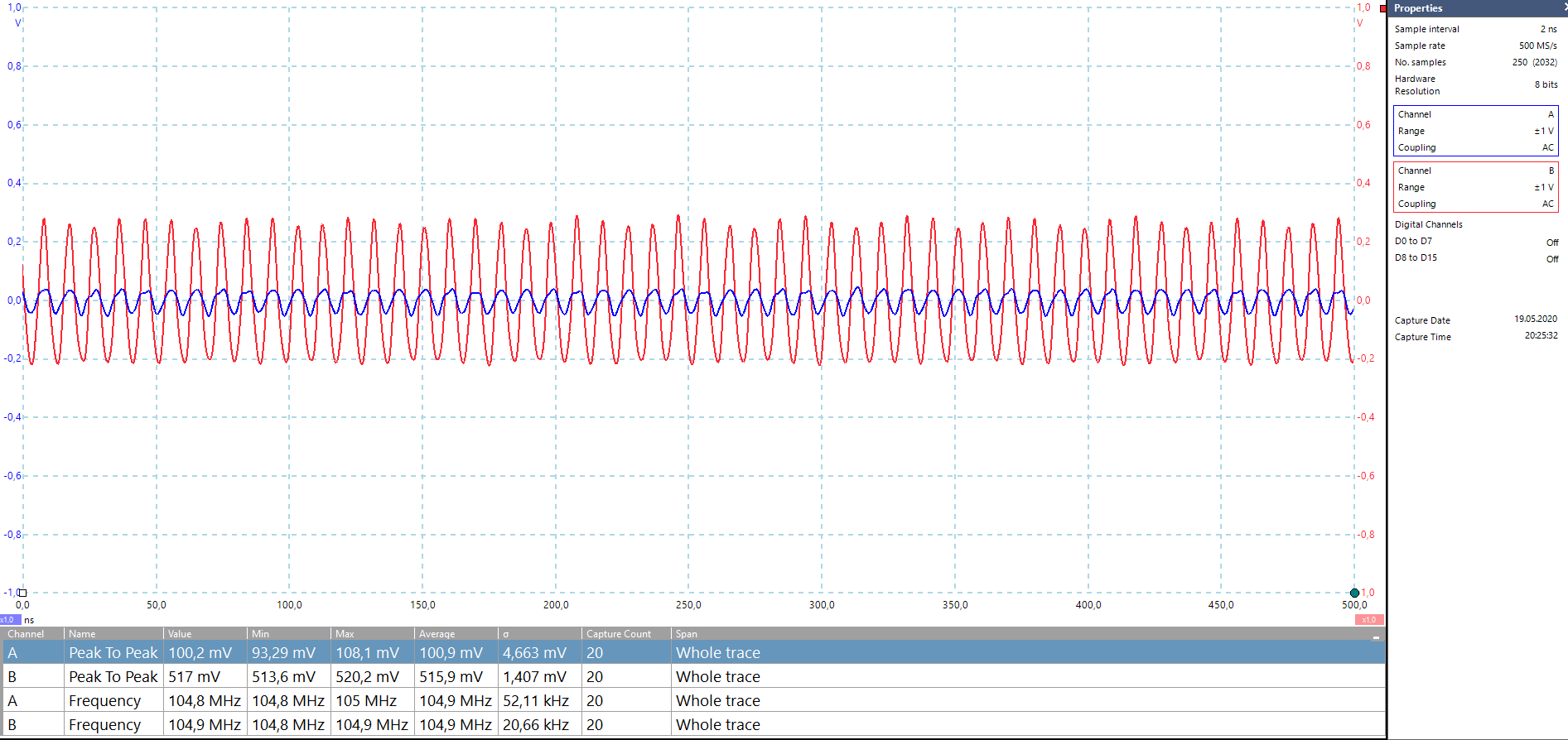

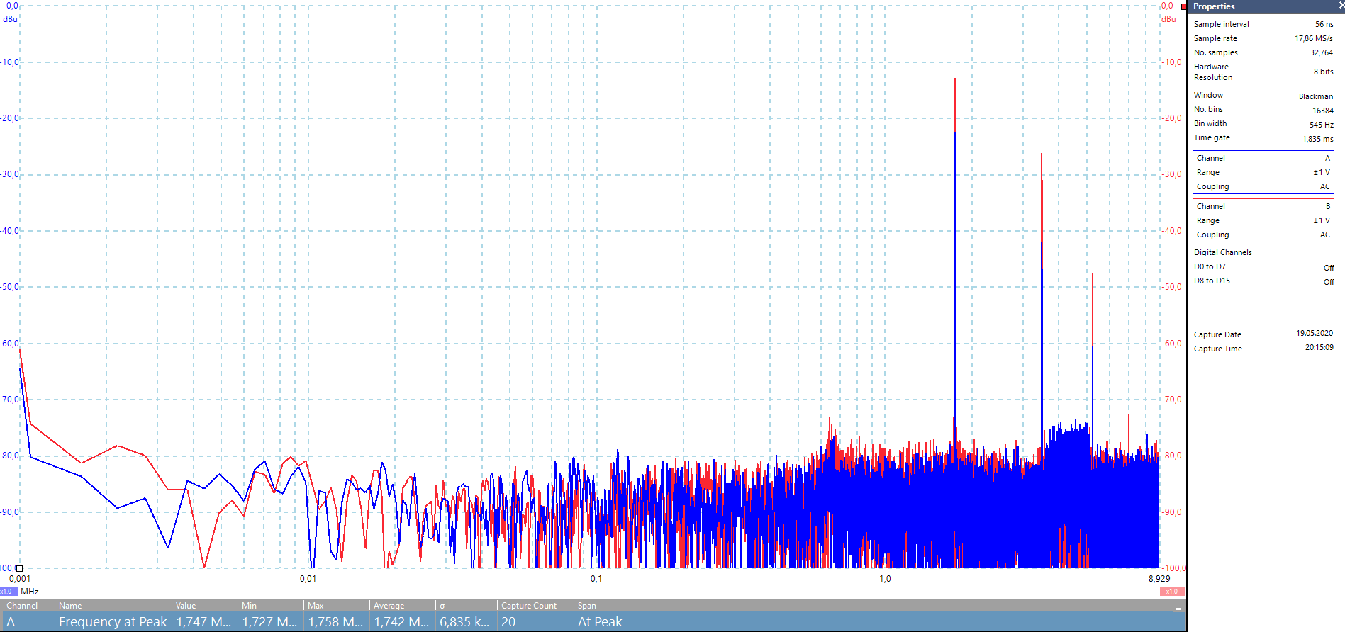

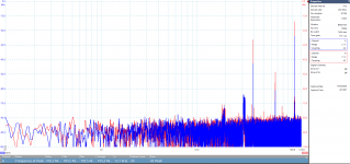

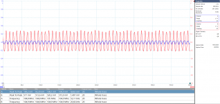

Chasing the osc
Digital oscilloscopes are handle little tools. I have a PC type (Picoscope 5444D). But I just experienced the under-sampled alias, and think this may be of interest. Most of us know about this digital limitation, but it is so easy to forget in the comfort of easy measurements. So this post is not about curing the oscillation, just to show how digital scopes can give bogus results.

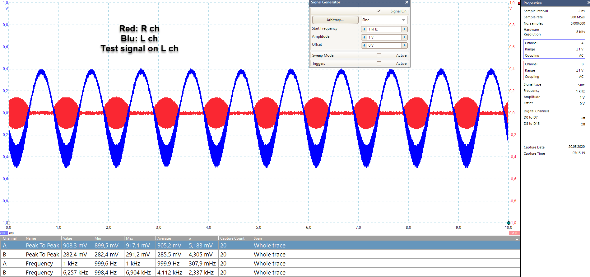

So I fired up a new build, and of course instead of a fine and thin line the trace is wide and varies sporadically. Inserting a 1kHz test signal on the left ch gives weird bubbles on the right ch.
(This is a 6AS7 amp with a folded cascode input/gain stage. The measurements were with the output section not installed, only the input stage is active. The cascode transistors are 2SK1381, pretty fast devices, so no surprise regarding oscillations).

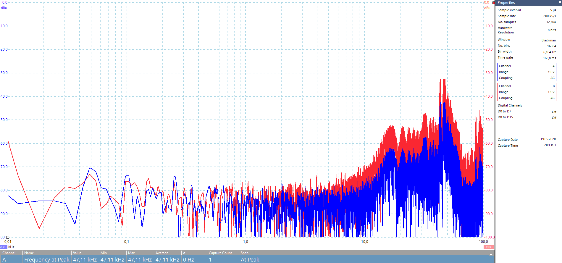

So I switched to FFT mode to pin point the oscillation frequency. The sample rate is 2x the max frequency selected for the FFT view. So if I select FFT to 100kHz, the sampling is 200ksps.
The FFT up to 100kHz shows a wide band (almost noise-ish) burst oscillation. Peak is 47kHz.

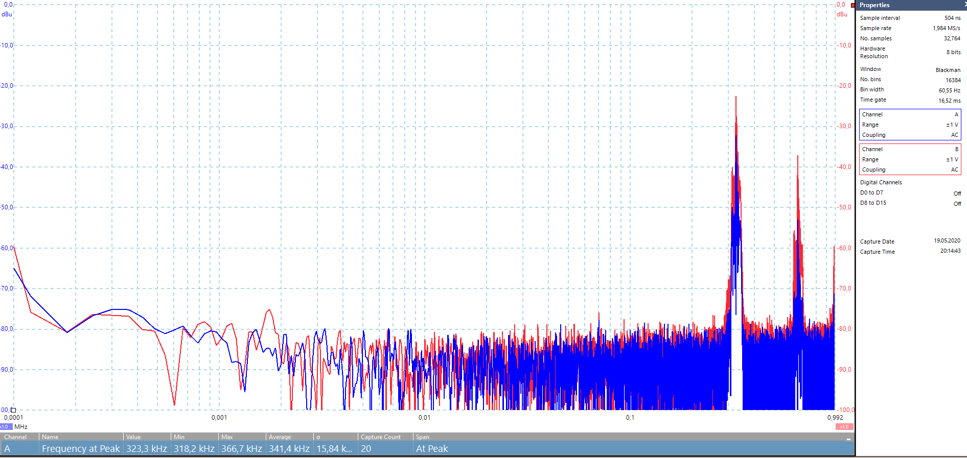

Increasing to 1MHz (992kHz really) FFT the peaks go up 323kHz and above, relatively wide band still. The sampling is now 1.984MSPS.

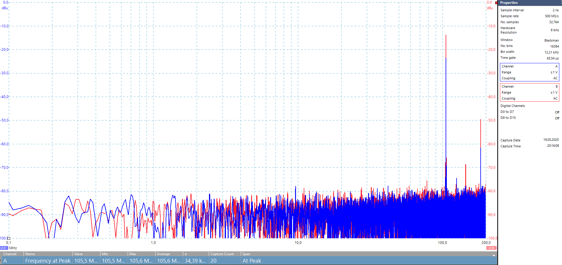

Going up to 8.929MHz, sample rate 17.86MSPS, the highest peak is at 1.75MHz.

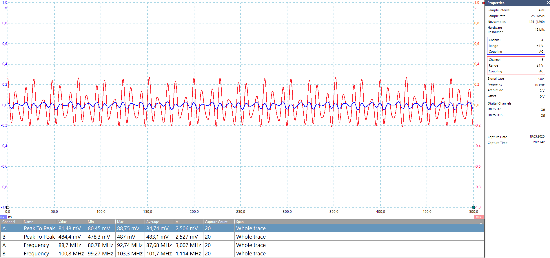

Up to 125MHz, sampling 250MSPS, the peak is 105MHz. There is some wide band peaking here and there.
The scope's max range is 250MHz, sampling 500MSPS. The peak is still at 105MHz, but it is not dead solid.
Obviously what I am seeing is under-sampling. The time domain view set to highest sample rate shows a relatively stable 104.8MHz but I suspect this is under-sampled and the actual oscillation frequency could be higher.
Are there any simple formulae that lets me calculate what the real frequency is based on the sample rate, and supposed frequency peaks shown at the given rate?
So now it's troubleshooting time...

For instance the 105MHz signal (which is probably correct as the 'scopes front-end amp will roll off from 250MHz quite severely) = 6 * 17.86MHz - 1.75MHz
The undersampling spurs for a tone at frequency f will be at n*Fs +/- f, where n is an integer and Fs is the sampling rate, as sampling is like RF mixing. You would have to guess n though, so the best strategy is start at the fastest timebase setting and work down.
Expensive 'scopes do proper rate-conversion and don't show such under-sampling artifacts. This also gives you free sample-averaging to obtain higher ENOB. It takes quite a lot more hardware to do this though as digital filters are needed running at the full sample rate and various sub-multiples of it too. Other tricks you see are tracking the max and min samples so that you can see there's signal present even when its faster than the current timebase would display. Sometimes that's annoying though as it can just be HF noise.
With lots of memory depth this processing can be done off-line, as no realtime
processing needs to be done, other than filling memory - but then the refresh rate can be disappointing.
