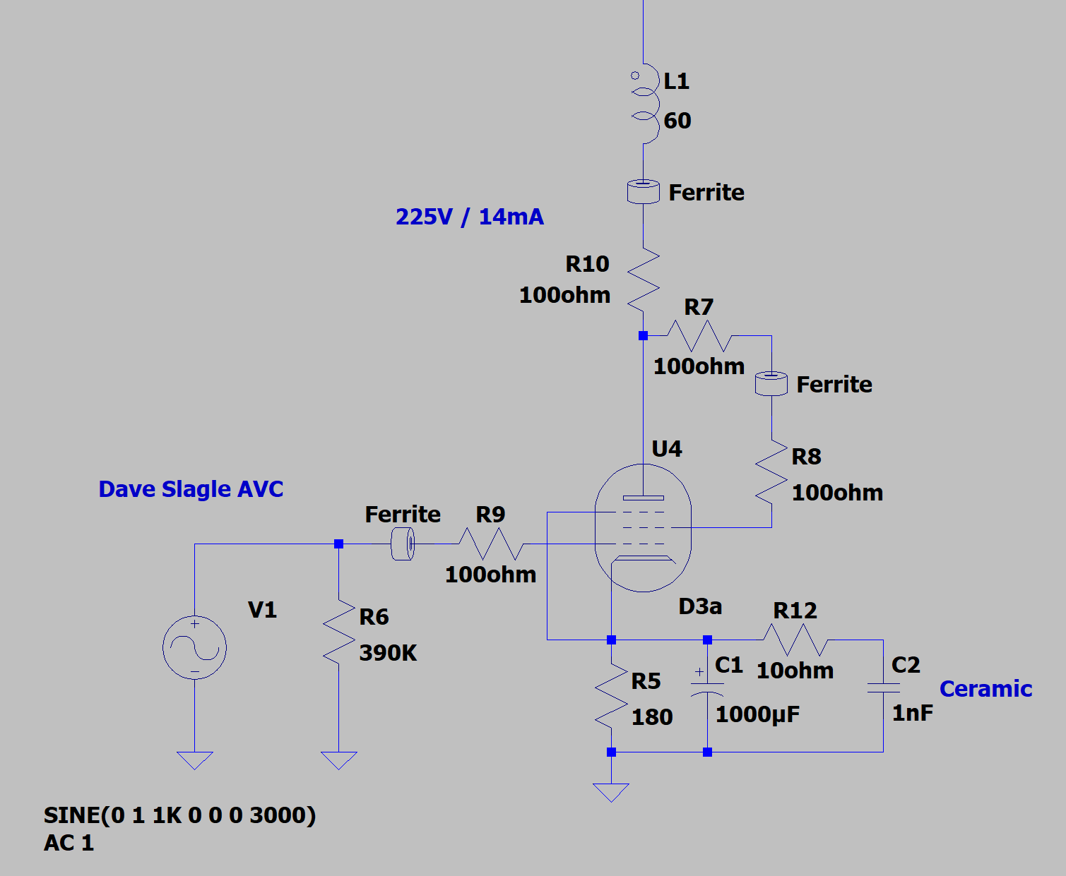

Simple changes I made this morning - removed cathode ferrite, reduced G1 stopper to 100ohm, and placed a slip-on ferrite between the two 100ohm stoppers on G2 yielded similar results, still oscillating. I have some 10ohm 1/8W CC resistors on the way.
In regards to placing 10ohms in series with the 1nF bypass on the cathode, I assume you mean like below as a HF RC filter, as opposed to using 10ohms unbypassed as a cathode stopper.

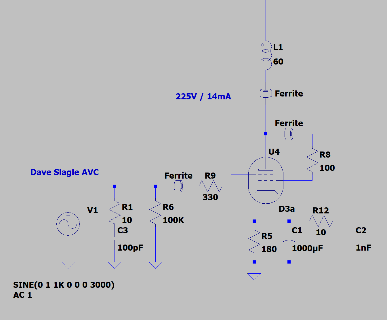

I tried 56pF in series with 10ohm across the grid leak resistor without improvement. Will try some other values as well, believe I have some 100pF caps on hand.

If that doesn't get me anywhere, I may try operating points similar to the datasheet - i.e., putting a cap on the input, putting a 9V battery under the grid leak resistor, and increase Rk to 820R, as below. I've read a few comments across the forum that this may help stabilize.
![HY69 Schematic.png HY69 Schematic.png](https://www.diyaudio.com/community/data/attachments/1164/1164038-5aac1730438cfa7f0626ba8e2d4afe55.jpg)

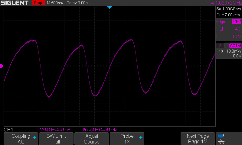

I did a number of things and collected some data, the oscillation persists.

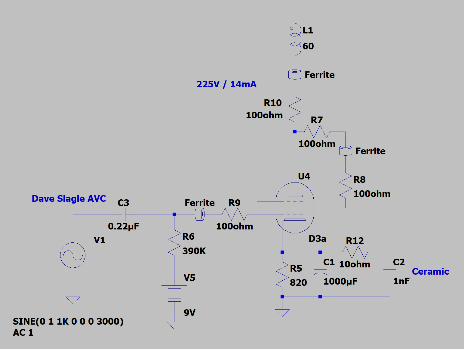

I added multi-turn ferrites to the plate and G2 to plate connections. Also added a 10R (metal film) to 1nF RC to the cathode as discussed. No change after those moves. I then I added a multi turn ferrite to G1 and increased the G1 stopper value from 100R to 330R without any improvement. Then replaced the 1nF cap in parallel with the grid leak to a 10R to 100pF RC. Again, no change.

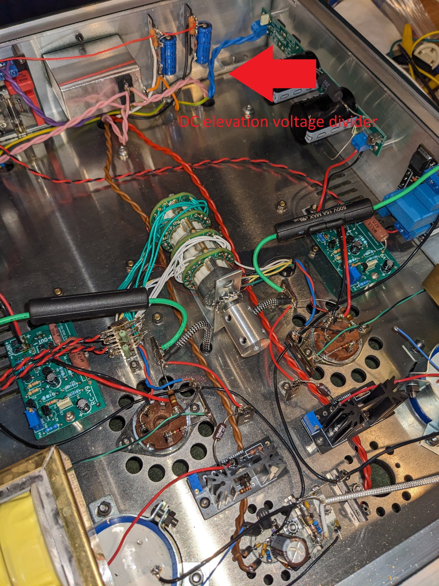

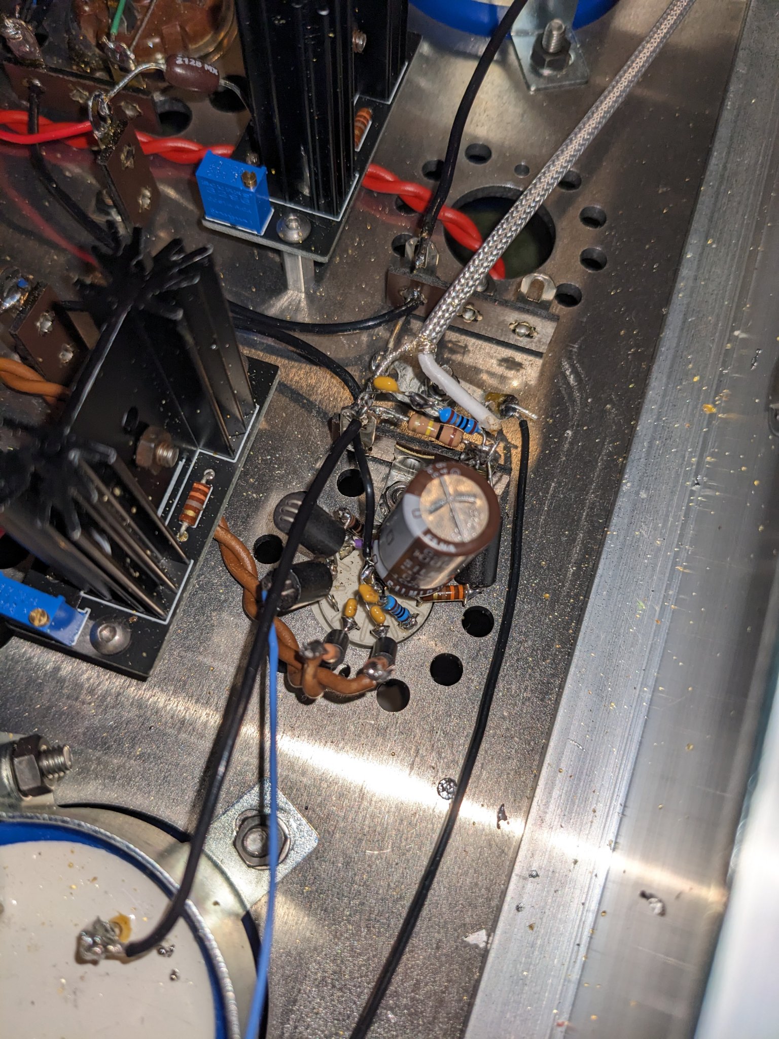

Here's how the socket is wired currently.
Next, I moved toward ruling out the Maida regulator. I added 10R series resistors at the output of the regulator and from the D3a stage cap to the interstage transformer. No change. I took it one step further and removed the regulator from the circuit - I fed the amp directly from the reservoir cap bypassing the regulator with the same oscillation pattern. So I feel very confident now it is not the regulator.

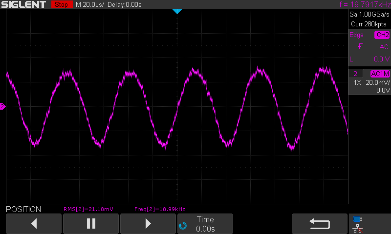

Then I worked out nailing down the higher oscillation frequency. With the scope probe on the HY69 grid, if I pulse the amplifier with a 1kHz square wave, the audio frequency range oscillation is easily teased out.
Looking at higher frequencies, I saw that when the amp is connected to the DAC/ADC I use for testing, I see a mix of frequencies in the 600kHz - 1.7MHz range.
Interestingly, these don't show up when connected to my signal generator, only the DAC/ADC. But again, a square wave pulse from either results in audio range oscillations. I did detect some 150-200MHz hash but it is present whether the amp is on or off, so I think it is simply noise, whereas the 600kHz-1.7MHz frequencies are only present when the amplifier is powered and the DAC is connected to the RCA input.
So perhaps I should be targeting a lower frequency range with my efforts. One thing I have not pursued is DC heaters. Right now the heaters are AC, but DC elevated with ferrites at the leads and bypassed to ground with 1nF ceramic caps. The leads are quite long though and the grounding point for the DC elevation voltage divider is in the back of the chassis.
![HY69 Schematic.png HY69 Schematic.png](https://www.diyaudio.com/community/data/attachments/1165/1165400-ffd12e610ad110e2ddb35002778cc0bc.jpg)
![PXL_20240108_234659982.jpg PXL_20240108_234659982.jpg](https://www.diyaudio.com/community/data/attachments/1165/1165401-40ed3793a41b54aa6667e18dbdb0c429.jpg)
![SDS00027.png SDS00027.png](https://www.diyaudio.com/community/data/attachments/1165/1165402-4bb9e4fa725c66d80400251ab6475cde.jpg)
![SDS00020.png SDS00020.png](https://www.diyaudio.com/community/data/attachments/1165/1165403-d2aec2c1e0673677112daaa991fb5759.jpg)
![SDS00023.png SDS00023.png](https://www.diyaudio.com/community/data/attachments/1165/1165404-e9446b92fc89b55076e2cef9e5e36b7f.jpg)
![Voltage divider-2.jpg Voltage divider-2.jpg](https://www.diyaudio.com/community/data/attachments/1165/1165416-aa84790d4f0ab6421d03d1df1d3f8f0a.jpg)

That's too low a frequency for ferrites to be of help, and unusual for self-oscillation.I see a mix of frequencies in the 600kHz - 1.7MHz range.
If it only shows up with the DAC, is the loading on the DAC capacitive? Long cables? Many opamps lose phase margin under fairly small C loads, unless there is a 51 ohm resistor at the opamp output.
Could also try rolling off the gain of the D3A stage with a RC across the IT primary.
