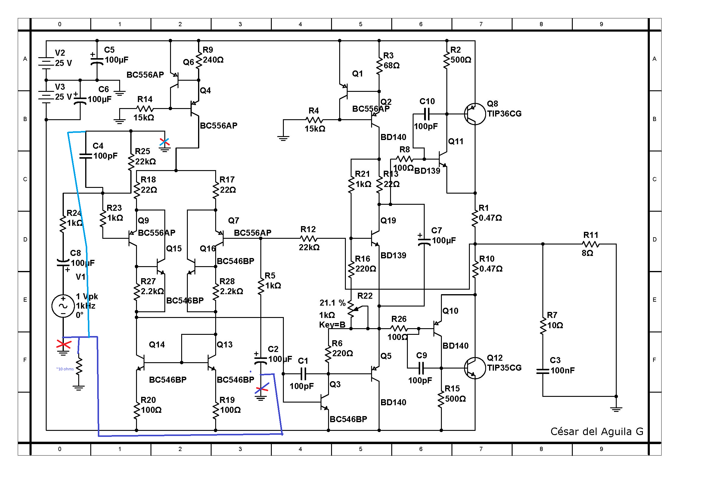

Here is the schematic:

OK so it's similar to a P3A amplifier. Those wires to the output transistors are far too long. CFP output stages are tricky at the best of times.
Where is Q19 mounted ? It doesnt appear to be in thermal contact with anything. It should be mounted on top of one of the driver transistors.

I think it is very different in detail, mine doesn't have a bootstrap in the VAS, mine have a CFP everywhere... and long wires as you say for the output power transistors, but they are in this way because are for testing the board. They should be in the board, this is true, but I think it doesn't explain the oscillation.
They will be in the next board.
And Q19 should be in contact with the drivers, I didn't do it this time, with this board to make it faster. But again it doesn't explain the oscillation.

But Jaycee is right, a CFP stage (you have them both at input and output) can get pretty tricky to keep stable. And those leads to the output transistors are trouble -- if you have to have them long, maybe try twisting just the C and E leads together like that, with the B lead not so tight with the others.

You have to many individual ground connections /wires.
Combine C6 ground into C5 and take one wire away from C5 to the power common .
Combine C2 ground and R25 /C4 ground into R14 / R4 ground and combine with C5 at the pcb .
Keep the signal ground wire ( the one twisted with the red input wire ) this becomes the signal ground .
Keep the individual zobel ground wire .
This should leave you with:- one wire from C5 to power common
one wire from zobel to power common
one wire ( the one twisted with the red signal wire ) to signal ground .
PS C8 is reversed.

Insulate the trannies first .
Nicely spotted. That will be making the problem even worse too - those heatsinks are effectively antennas directly connected to the transistors collector. The CFP output stage will amplify that a treat.
