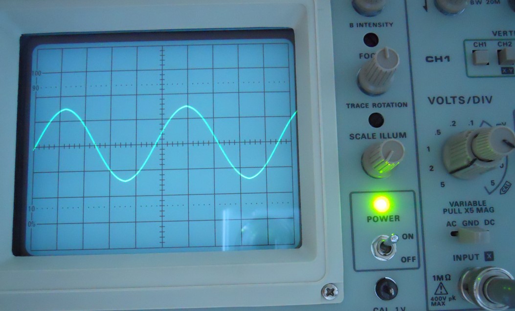

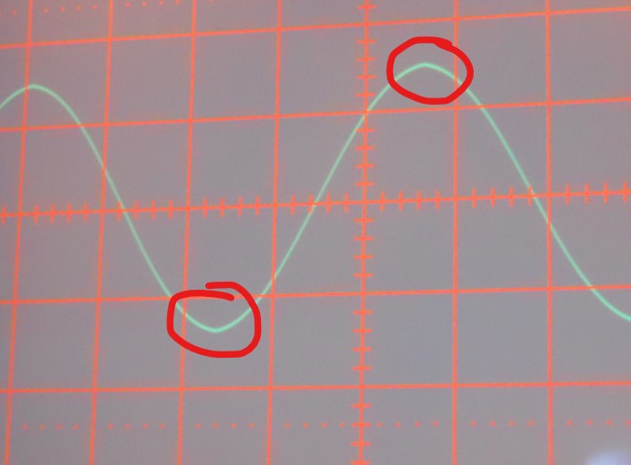

Image #1 and #2 are taken by me today and show a 1kHz synthesised 'sine' from a function generator. In real life on an analogue scope the distortion at the peaks is clearly visible. What sort of specs would you need in a digital scope to resolve that?
Image 3 is from the web and shows what looks like a small amount of HF oscillation around a zero crossing point. What sort of spec would be needed for that?

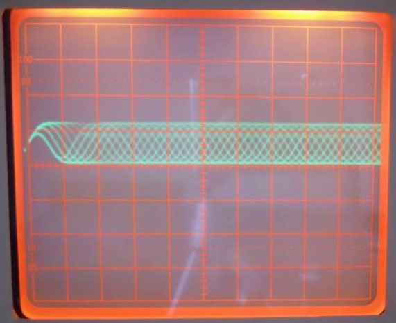

Image 4 is the classic RF or eye pattern found in CD players. This is one of mine from a long time ago. Again, what sort of minimum spec would be needed for something like that with a digital scope?
As I say, I've grown up with and continue to use analogue (at the moment anyway 😉) and don't really know the answers to this.

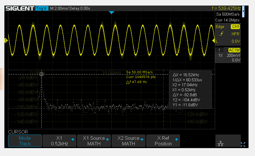

An SDS1104 owner here, configured for 200MHz with all the features. I've used basic analogue scopes many years ago as my Dad was into electronics and would bring home a scope on the weekends. Size of the 1104 was part of the reason for me too - it fits on a bookshelf unlike the analogue scopes I've used in the past!
A scope is a microscope and the ways you use/get the best out of digital or analogue differ.
Analogue will give you immediate infinite resolution realtime capabilities. The triggering and speed will be faster than a digital scope in displaying.
Digital, at this price range, gives you what's on the screen and that resolution is 8bit with some offset and scaling. The 1104 does start to slow once you start creating larger acquisition of data. Think more 'capture, process then display'. It takes a little getting used to - but a digital tends to have more features in t he triggering and maths.
Slightly annoying with the 1104 is that you can't do compound maths - for example use the four probes for maths as most of the maths functions only operate on two channels and you only have one maths function. You can still use the two other channels when using maths but not apply a second maths function to those channels.
What you will find is that frequency analysis is also important if you're designing and repairing so a spectrum analyser is useful but those can be created from a sound card. The FFT does work in the 1104, it gives a good finger in the air and you can zoom in etc but as people have indicated the bit resulution of the scope (fast rate low resolution) vs an analyser (slow rate, high resolution and wide spectrum) will start becoming apparent. However it's good enough in the most for audio to help diagnose a problem or two.
Lastly - function generation is useful. Most scopes at this price range don't come with a AWG inbuilt. If you want to bode test on the scope for example you will need something to make the noise as instructed by the scope. More expensive scopes have basic generators built in. You can pick these up for 100 or less but I would have it scope controllable.
From my limited experience I quickly found the 8bit resolution limits but you will need to plan around those a little. If you're doing power/tube amps then you will need a higher voltage probe in your budget. A 100x or 1000x. So digital definitely does have limits in terms of resolution and you'll not see between the samples, but it also has the advantage of being ~80% of usefulness for 20% of the size and weight. Also sample rate - 1Gs/sec but as you add channels and maths this rate drops so you may not see with the full resolution any issues that analogue may show. Precision but only if that issue and the sampling period collide so less samples means you need to think a little if you're trying to detect some issue or so.
I just worked out this morning how to get cursors to work with maths function output:

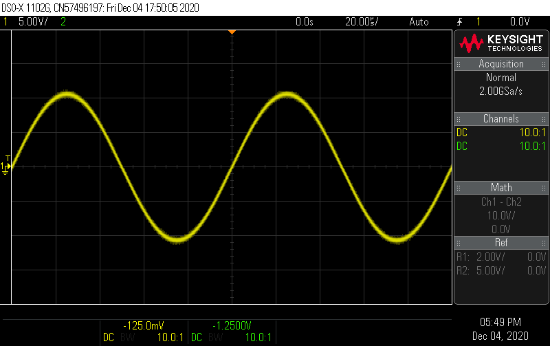

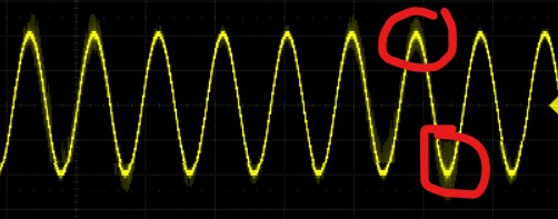

That's useful Nick. Your showing only 500Hz there and the sampling is very clear to see if you look closely.
Also what are all the other things. On analogue you would look at that and say the signal source had HF instability but I'm guessing here those are display/sampling artefacts and not present in the original... or am I wrong on that?
If that sine were at say 50kHz or 500kHz would it look even more 'quantised' or not?

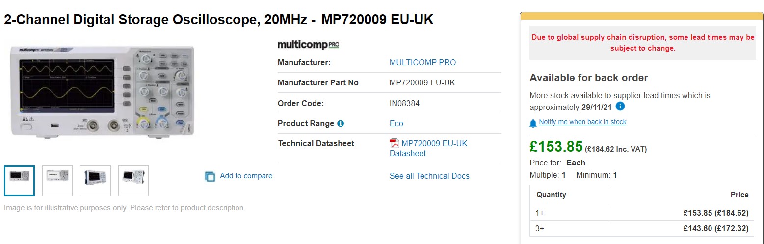

The Keysight I would call a kind of upper midrange product... a very nice scope 🙂 but how do you think those two images of yours might look on a 20Mhz budget type scope which is what a lot of beginners look at.
Something like this:
https://cpc.farnell.com/multicomp-pro/mp720009-eu-uk/digital-storage-oscilloscope-20mhz/dp/IN08384
https://www.farnell.com/datasheets/...221.453228295.1594006635-611634051.1579231713
