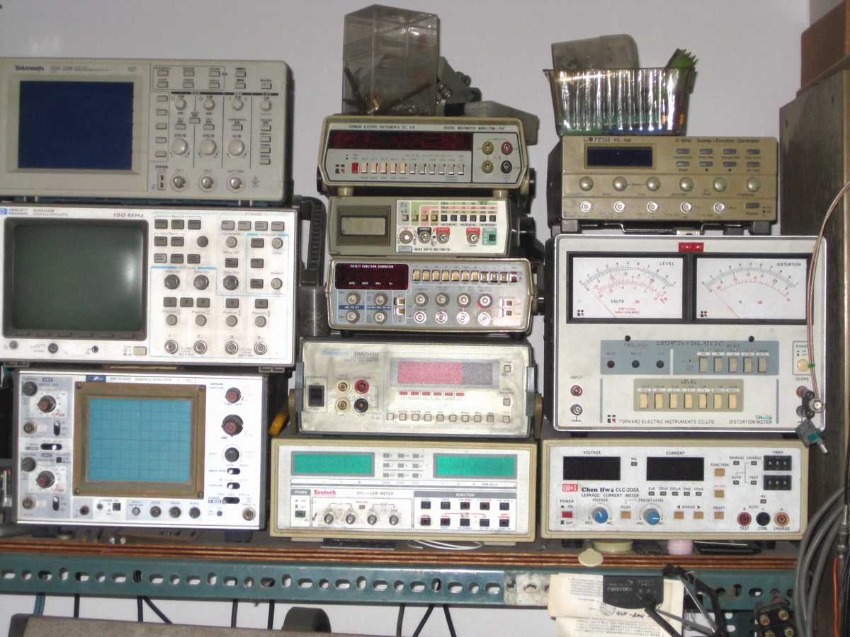

Having made do with an ex university Tektronix 502a with 2 no. differential inputs for 30 years, (and only 1MHz bandwidth!) which in the time honoured fashion had a control for every parameter,
I recently treated myself to a popular Rigol 4 channel digital scope.
On one side the new one uses less power, takes up much less space, makes less noise and is portable (not trolley bound) but I don’t like it. Sure it has better bandwidth and I am beginning to appreciate the one button auto function, but I don’t like the general usability what with all of the twist and press controls that somehow jog on to the next setting requiring you to repeat the action and button presses which lead to sub menus and more button presses, argh!
I am currently on the look out for a nice example of a late tektronix analogue scope, 100 or 60MHz or a Japanese scope of similar era and spec. I have fond memories of our firms’ lab scopes of this type, easy to operate, good quality with a sharp trace. I recall a really nice mains/battery operated Hitachi 20MHz model too, not the last word in sophistication,but nice to use and really handy.
A case of Rose tinted glasses? perhaps and maybe it’s because that’s what ‘I grew up with’ but sometimes you just click with a particular instrument.

if you just need a nice, inexpensive, old fashioned analog scope for basic audio, you'd be hard pressed to do better than a Hitachi V-665A in good condition. Because of all the low priced digitals being sold, you can probably find these for <$100......
I am currently on the look out for a nice example of a late tektronix analogue scope, 100 or 60MHz or a Japanese scope of similar era and spec. I have fond memories of our firms’ lab scopes of this type, easy to operate, good quality with a sharp trace. I recall a really nice mains/battery operated Hitachi 20MHz model too, not the last word in sophistication, but nice to use and really handy.
i'm speaking from experience - i purchased a new one in the 1980s as my first scope, it's still going strong and continues to earn it's place on my bench alongside some fancier ($$) products. at some point, i'll hand it off to my grandson (if I don't croak first 😉)

When my Philips analogue scope annoyed me enough becaue of the failing power supply (common), I bought a Tektronix digital scope.
* It survived only a few weeks: the input range is 35 volt, so with a 1:10 probe they supply, it can handle 350V. Of course I once in a while did not use 1:10 and maybe that was the reason so the scope died. It got all kinds strange screens, moire effects. Luckily Farnell gave me the money back.
I now bought a refurbished analog Tektronix drom 1970: there is still a factory repairman here in Holland who does that - sort of as a hobby.

I own a HP54602 150M & Tektronix TDS220 100M for years. In my opnions:Buy analogue withs readout.

I think you are both correct, for my purposes a nice rehab 2ch analogue scope would be great. The issue for me is the logistics of finding one. I don't live near a large city where there is likely a brick and mortar store. Does anyone have a suggested online site you trust or ebay dealer that you would trust? The draw to the new digital scopes is a warranty and return policies if purchased from a reputable dealer if something goes wrong.
Theirs a nice Hameg HM-604 on uk ebay for [COLOR=rgba(17, 24, 32, 0.87)]£33.00 atm, they seem to go for £[/COLOR][COLOR=rgba(17, 24, 32, 0.870588235294118)]100~200, these even have a in-circuit component tester like a huntron tracker if you need that type of thing[/COLOR]
