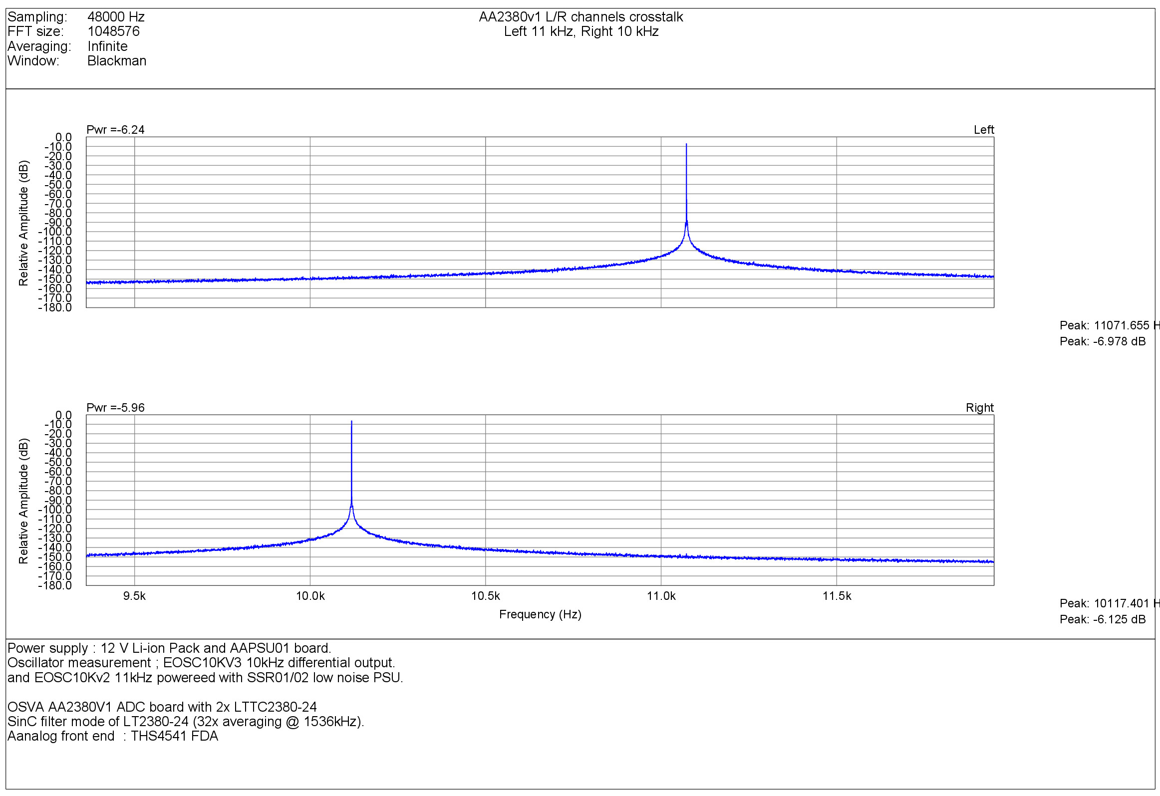

Below the FFT result of 2 sines 10kHz and 11kHz on both channels
to see cross-talk.That look fine...
AA2380V1 - LTC2380-24 ADC based channels cross-talk.
