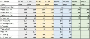

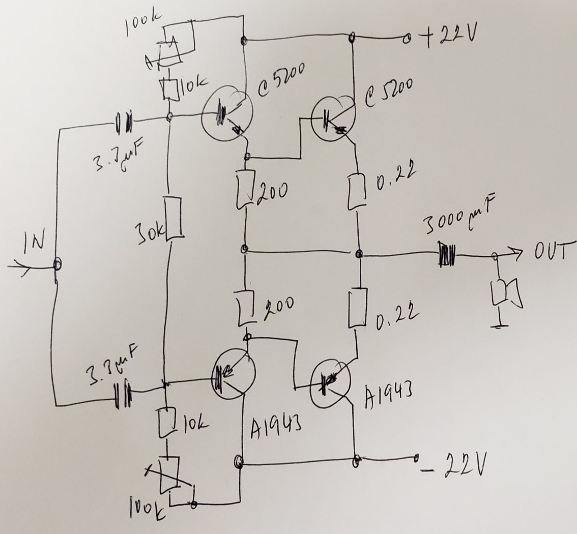

I created two fully finished buffers based on c5200/a1943, one based on one output pair, one on three output pairs.
Now i want to experiment with other power bjt for outputs.
I got c3263/a1294.
I got w1302/w3281.
I got w0281/w0302. (I typed it incorrectly)
I hope i typed it correctly. (turns out I did not)
Which of these would be most suitable/linear?

It doesn't matter what final trz you're using as long as its driver can charge and discharge quickly its capacitances and that means that the driver is as important as the final transistor. You'll often see a ferrite bead on the base pin of the final trz in Harman Kardon's rather slow power transistors.Old timers used 1X 200MHz 30 watts drivers for 1X 50...60 Mhz 150...200Watts final trz for the lowest distortions as an example.You can also help a slower output and driver trz placing them inside a rail bootstrap keeping it at constant VCE as in Kenwood l-09M.

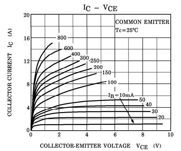

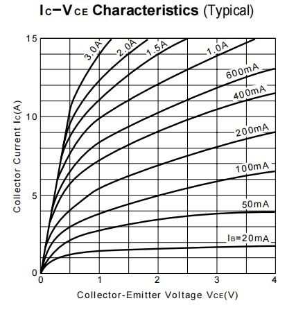

There's not the same scale and amount of detail in the charts, so not easy to compare. But I would say the C5200 looks very linear, look at the spacing between the curves for increments of 10mA of base current. Very evenly spaced = good linearity.
Which one is more linear as an emitter follower is best found experimentally, I think.
