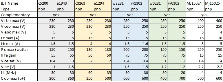

I made some corrections in the table. I made typo in one transistor, I do have NJW0281 (not 0381 like I typed). So I do have this complementary pair. I suppose I may use the pair used in Pioneer A-09 and see.

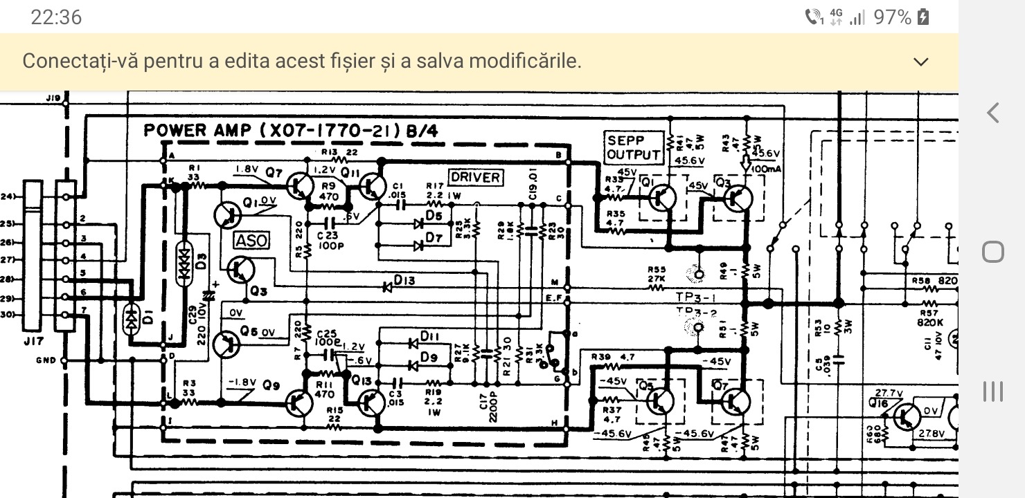

Now if you're in love with both diamond buffer and no global feedback there's hardly a better design (except Accuphase'a of course) than the one in Pioneer A-09 brought to our attention by Ciufolli.
Thanks for the info about the Altmann's web page, yes, that's what I have seen in the past.
That Pioneer A-09 is a beast.
But both of these approaches are only half of the solution. Even they do not use global negative feedback between the input and output transistors, in Altmann's case, there is still feedback up to the driver/and or one first output.

What do you mean with linearity ?Gents, let's discuss the linearity of output transistors, mainly bjt, for power buffer.
I got c3263/a1294.
I got w1302/w3281.
I got w0281/w0302. (I typed it incorrectly)
I hope i typed it correctly. (turns out I did not)
Which of these would be most suitable/linear?

hfe versus Ic or Vbe versus Ic ? Both are important, and dependent on temperature.
Cascode configuration is seldom used in transistor power amplifiers. Try it.
Make a spice simulation for different combinations of output transistors and quiecent currents.
By linearity I mean lowest distortion (at ~0.4A).
I did not get through the thread that far. Besides I run my buffer classA at ~0.4A per output.Not garbage by later measurements, but MJL3281/MJL1302 keep the crown.
Accuphase have an nfb free amp? News to me. Which one?

I mixed two things in onr sentence...I don't know any accuphase without global feedback, only that they extensively make use of diamond buffers...Accuphase have an nfb free amp? News to me. Which one?

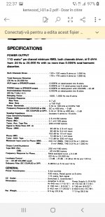

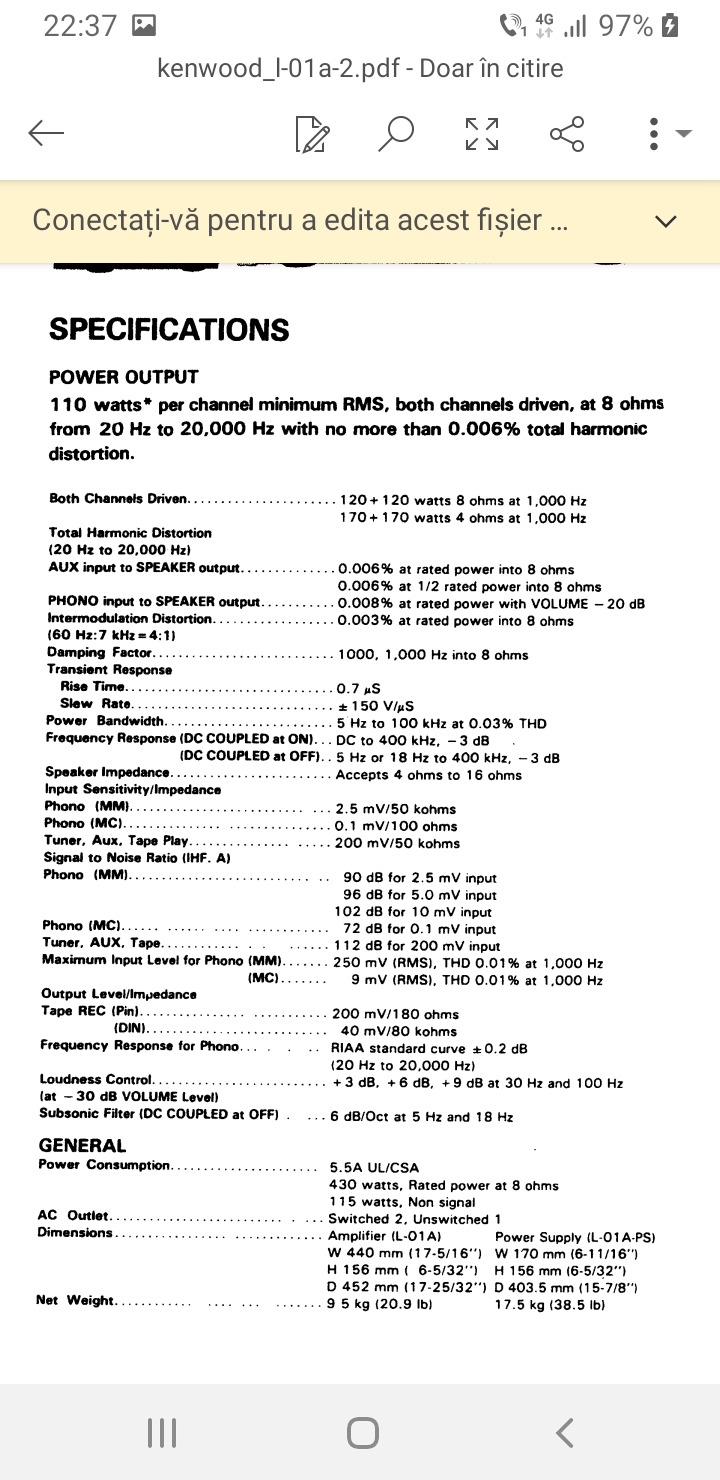

In all the output stages I simulated this was the most linear on 2 ohms and you also have the 1980's amp's specs :This is perhaps a question of taste which i also share. Practical considerations, the need for decent damping factor and the ability to drive low impedances with reasonably low distortion often take precedence. If your speakers are easy and efficient paralleling always sounds worse, especially at higher frequencies. In input stages too.

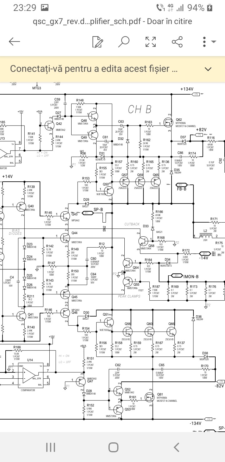

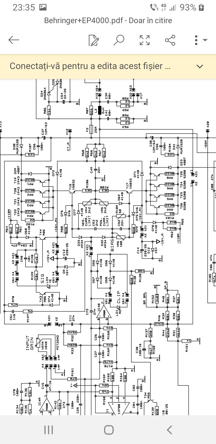

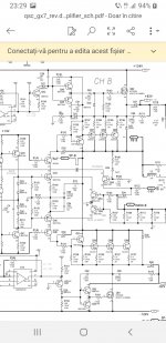

There shouldn't be any secret that the true king of driving lowest impedances in live concerts was and still is QSC with its szyklai pairs using capacitors to form a virtual ground and even the 2022 winner behringer ep4000 is actually a 1990 QSC clone...
Just google for top 10 power amps for live reproduction and almost all the important places are qsc amps or their clones...3EF output stages seem to be a thing of the past...
There shouldn't be any audio enthousiast that doesn't know anything about QSC and I know that all the big names in the "audiophile " industry have sworn to keep their lips sealed when passing by QSC, but they all know QSC is the true ellephant in the room of audio domain even if they never say anything publicly about it.
