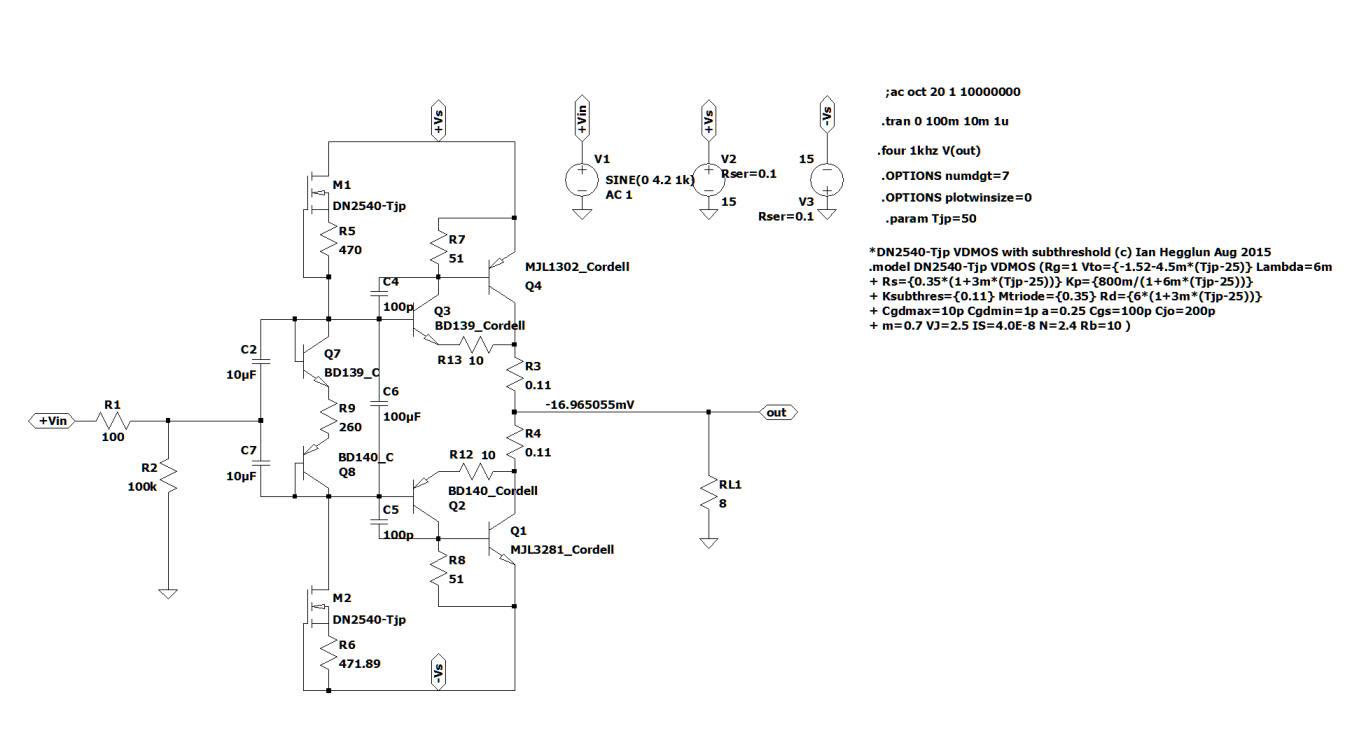

I'd go for a classic triple with TO92-MOD, TO220 and TO3P. Adason, I think you need to run your drivers hotter, I have 28mA with the single 68 ohm resistor and 700mA bias at the output. 20 volt supplies. Only simulated for the time being.

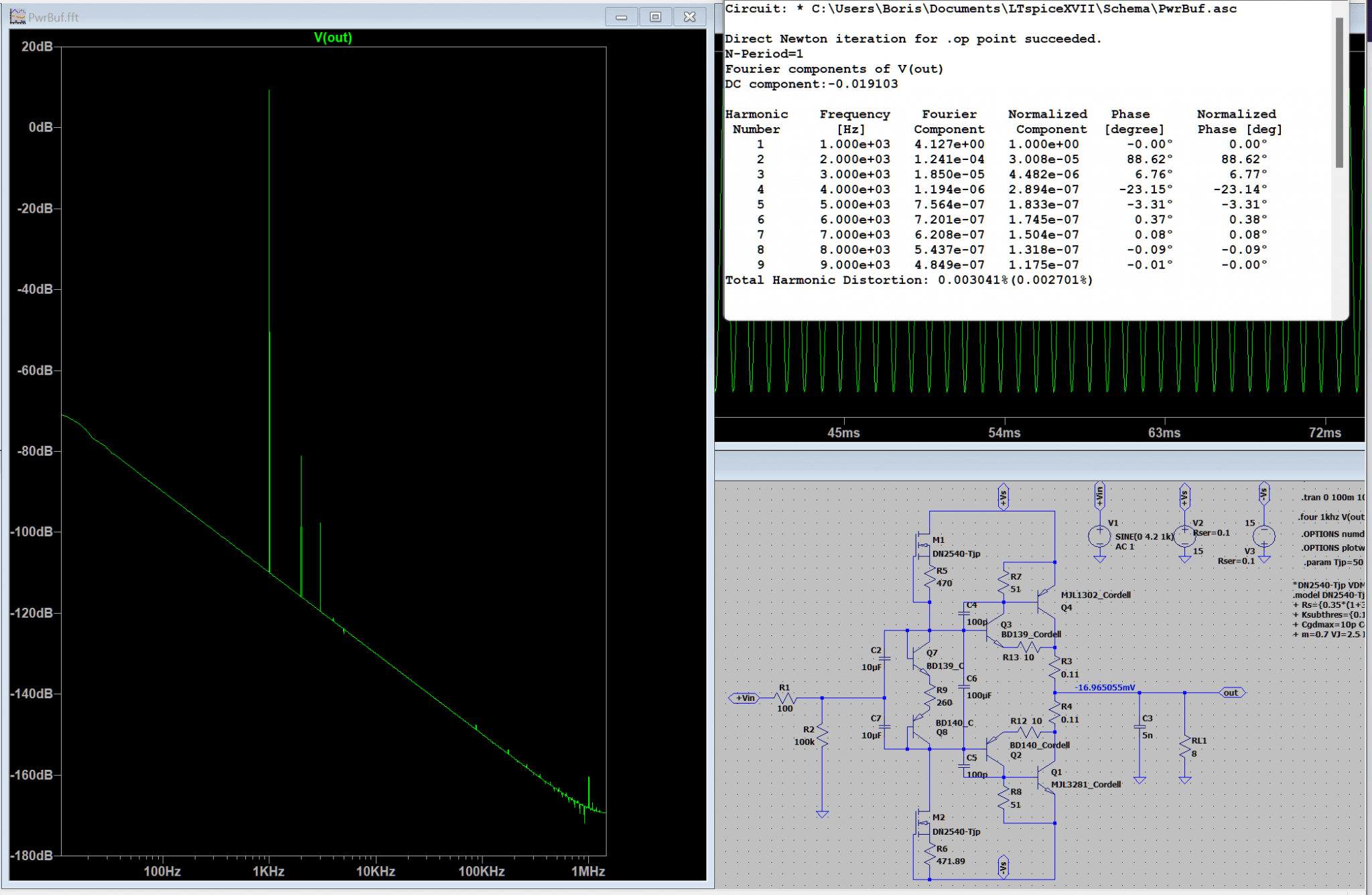

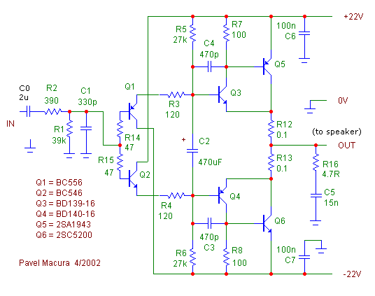

I’m in design evaluation phase and this design is candidate for an actual test build. It can work from +- 10V to -+ 30V. With 1A Iq and +- 15V supply, it will provide up to 8W/8 Ω @ 0.015 % distortion, never leaving pure A class operation. At 1W, distortion is 0.003 %. Harmonic profile is always H2 dominant. Frequency response is up to 6 MHz.
As for the proposed MJL21193/MJL21194, they produce 4x distortion compared to MJL1302/MJL3281 at the same conditions.
I have neither. If we are to believe LTSpice simulation with accurate Bob Cordell models for all BJTs, 21193/21194 are producing much more distortion. For circuit with NFB, it could be different.I have nothing against 21193/21194

That is nice enough however there are nfb loops around Q3/Q4 and Q1/Q2 which need Miller capacitors C4 and C5 for stability which reduce the frequency response.I’m in design evaluation phase and this design is candidate for an actual test build. It can work from +- 10V to -+ 30V. With 1A Iq and +- 15V supply, it will provide up to 8W/8 Ω @ 0.015 % distortion, never leaving pure A class operation. At 1W, distortion is 0.003 %. Harmonic profile is always H2 dominant. Frequency response is up to 6 MHz.
I mentioned these transistors because for the meantime they can be bought over the counter here and probably in other parts of the world.
In the proposed circuit the latter have fT figures much lower than BD139 and BD140 so the pole frequency of Q3/Q4 and Q1/Q2 would be due to the the power devices to the point where C4 and C5 could be omitted. In that case their frequency response then could be much the same as quoted for MJL1302/MJL3281.
The simulation takes no account of the increase in temperature above 25 C degrees of running a current of 1A will cause an increase in hFE. The values of resistors are not to suit biasing MJL21193/MJL21194 which have lower hFE anyway and need a little more base current drive current.
hFE (Beta) is not a good yardstick of what the increase may be. There is not much difference if emitter current gain (Alpha) is used instead of base current gain (Beta). Looking at respective datasheets for hFE Alpha would = Beta/(Beta +1) for each.
The result is always less than 1 but the percentage of that is not significantly lower. The gap is lower than many would think.
C4 & C5 are there for compensation on capacitive loads and Siziklai pair stability. There is no gain peaking with capacitive loads up to 10 nF and a very small with 100 nF. They reduce frequency response, but I don’t see an advantage in having more than predicted -3 dB at 6 MHz.

First, you will need to define input DC for Q7/Q8, otherwise the output DC will be floating according to NPN-PNP non-symmetry and temperature. Simulation will probably not show it, and also the 4x times distortion reduction with 1302/3281 is not achievable in a real circuit. Re stability, 21193/4 are easier to work with.I’m in design evaluation phase and this design is candidate for an actual test build. It can work from +- 10V to -+ 30V. With 1A Iq and +- 15V supply, it will provide up to 8W/8 Ω @ 0.015 % distortion, never leaving pure A class operation. At 1W, distortion is 0.003 %. Harmonic profile is always H2 dominant. Frequency response is up to 6 MHz.

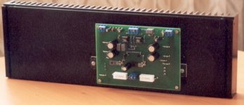

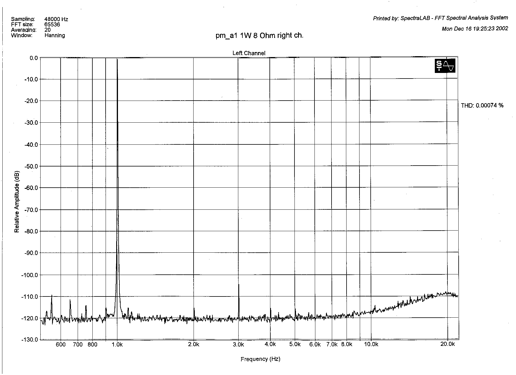

I built (built, not only simulated) a similar class A amp 20 years ago.

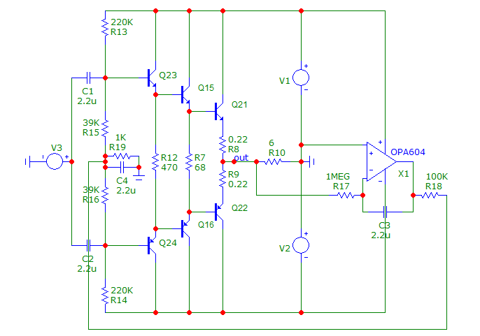

Yes, I know. This is just feasibility checkup, not exact circuit to build. If breadboard version will deliver good results, proper build will likely use DC servo. I had some fun with inverting version here.First, you will need to define input DC for Q7/Q8, otherwise the output DC will be floating according to NPN-PNP non-symmetry and temperature.
You’ve probably built more than most members merely simulated.

You might like to split R9 (260 ohm) into two 130 ohm resistors and put the R1R2 common point just there. It should have same parameters + DC stability.Yes, I know. This is just feasibility checkup, not exact circuit to build. If breadboard version will deliver good results, proper build will likely use DC servo. I had some fun with inverting version here.
I have checked this option as well because it makes DC coupled amplifier. However, it was put aside as bias setting is very inconvenient and affects DC offset at the same time. For a fixed Iq value it would be OK and I might end with that solution.You might like to split R9 (260 ohm) into two 130 ohm resistors and put the R1R2 common point just there. It should have same parameters + DC stability.
