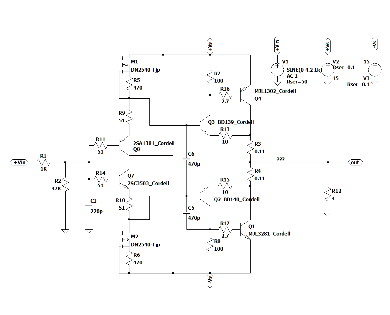

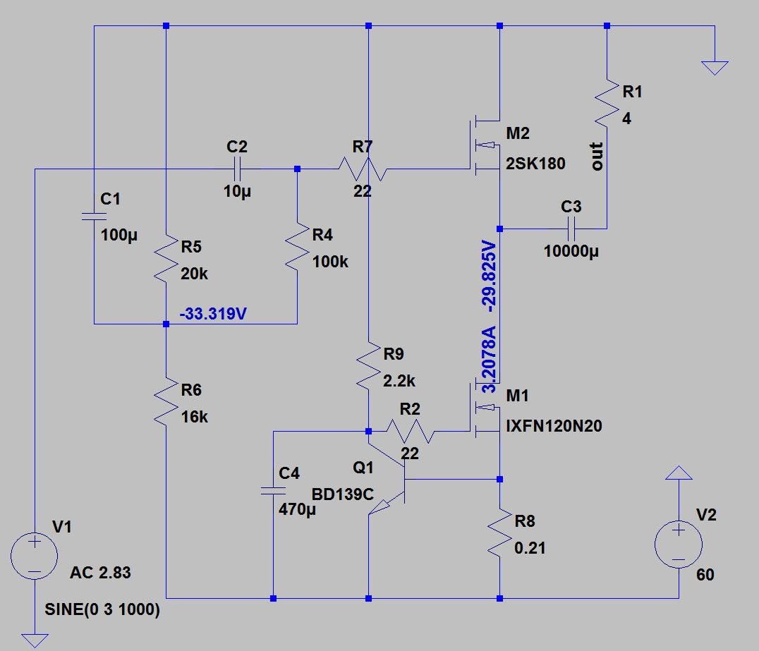

Hi Vunce,
this one is from the LTSpice with actual values as on the prototype. R5 & R6 are 500 Ω trimmers. I didn’t fire up KiCad yet. :)
Will check before if circuit behaves better with JFET CCS instead of DN2540.

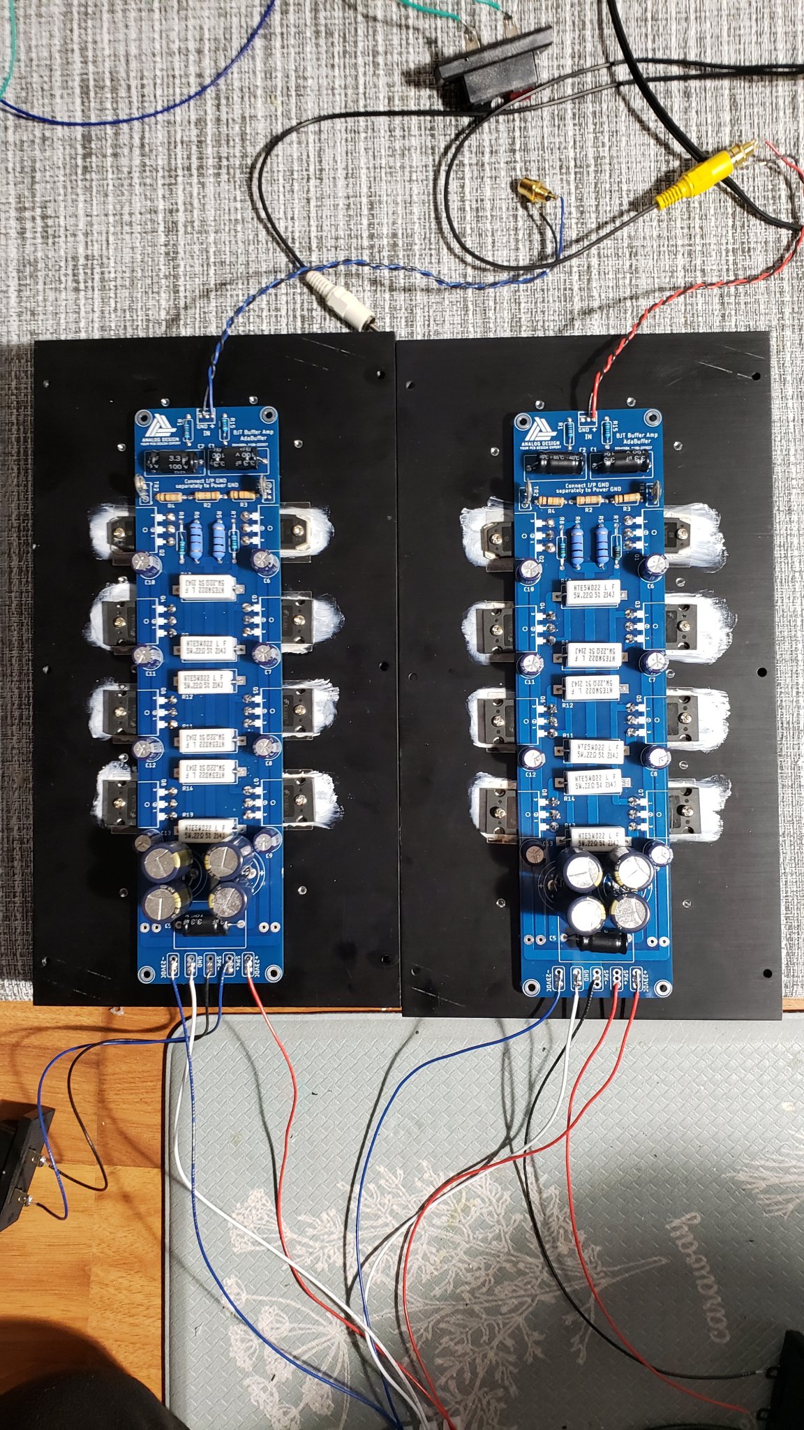

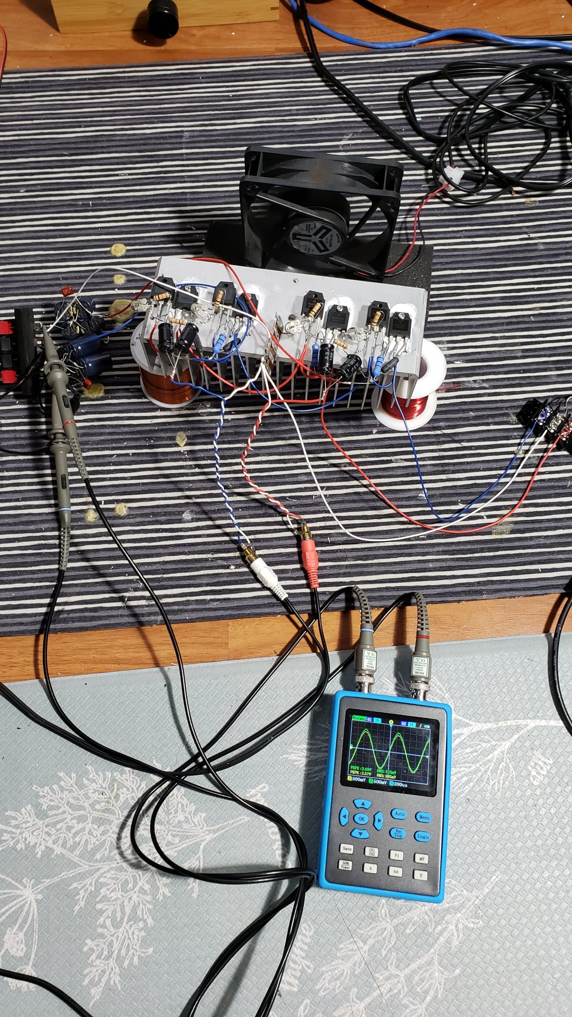

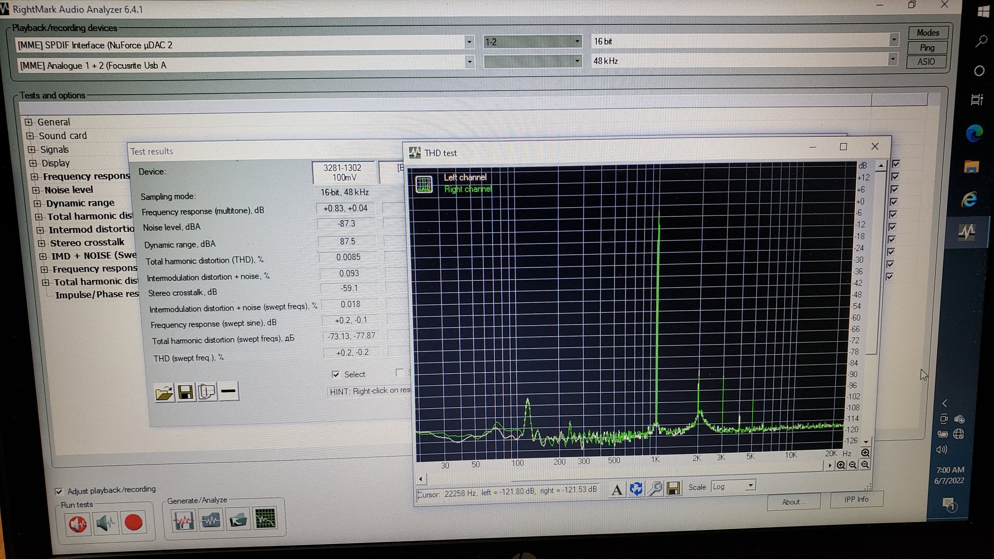

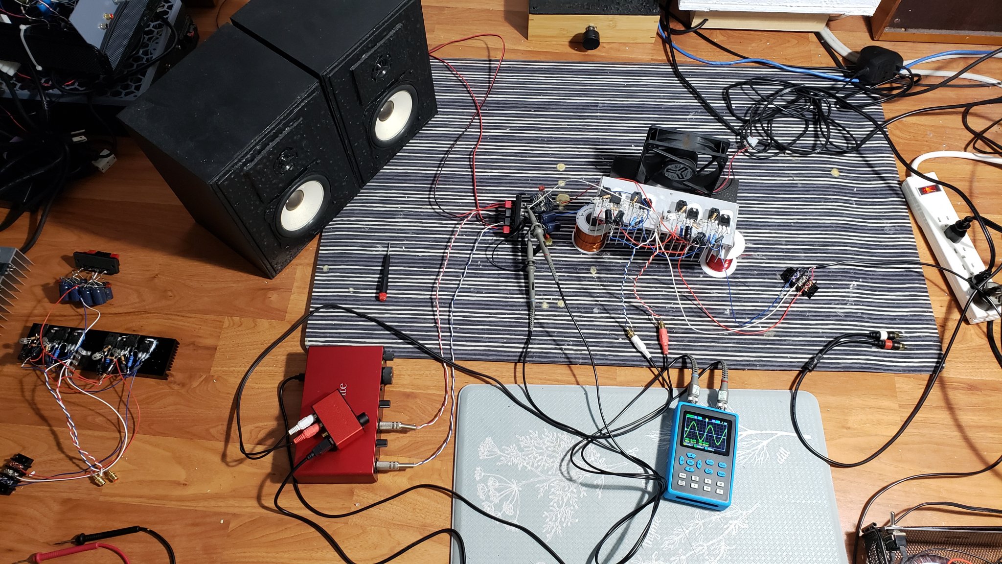

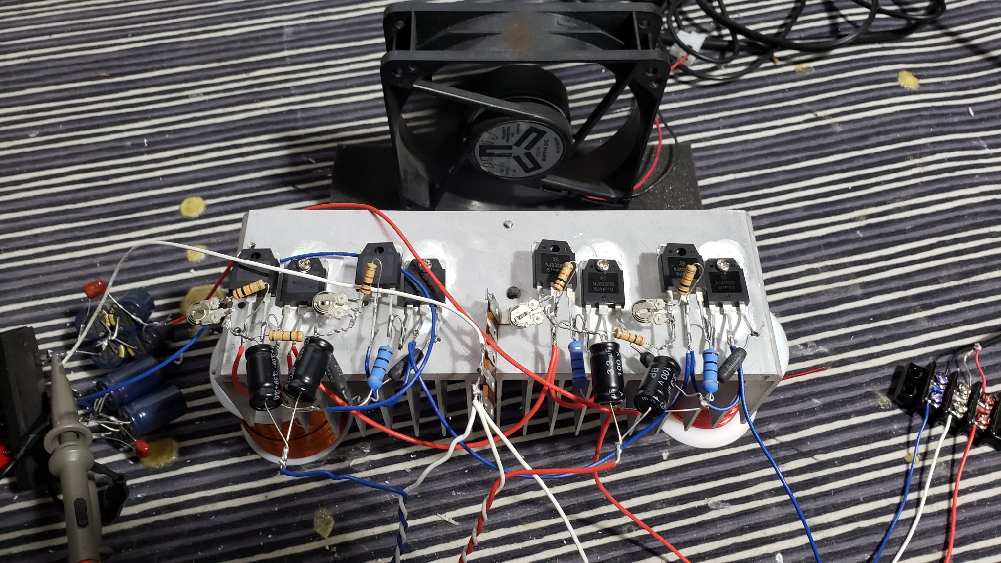

Back from vacation, finished the buffer with 3281/1302. With +/-22 volt power supply, took the bias to 100mV on 0.22 resistors, which translates to 0.454A. Took some measurements at 2.69Vpkpk, or 914mV rms into 6 ohm real speaker.
music soothes the savage beast
Joined 2004

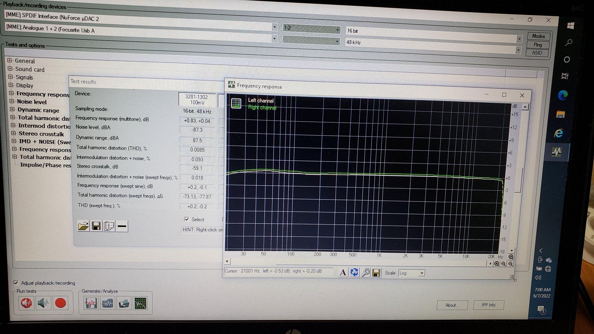

Offcourse had to use forced air for now based on the size of heatsink. Btw, adjustment for these outputs could use bigger trimmer or 10k increased. Each type of outputs is slightly different.
Interesting thing, I noticed slight hump, really slight, just a dB, on low fr response, not sure why. Otherwise the buffer sounds very good, surprisingly good, considering just test bookshelfs for now.

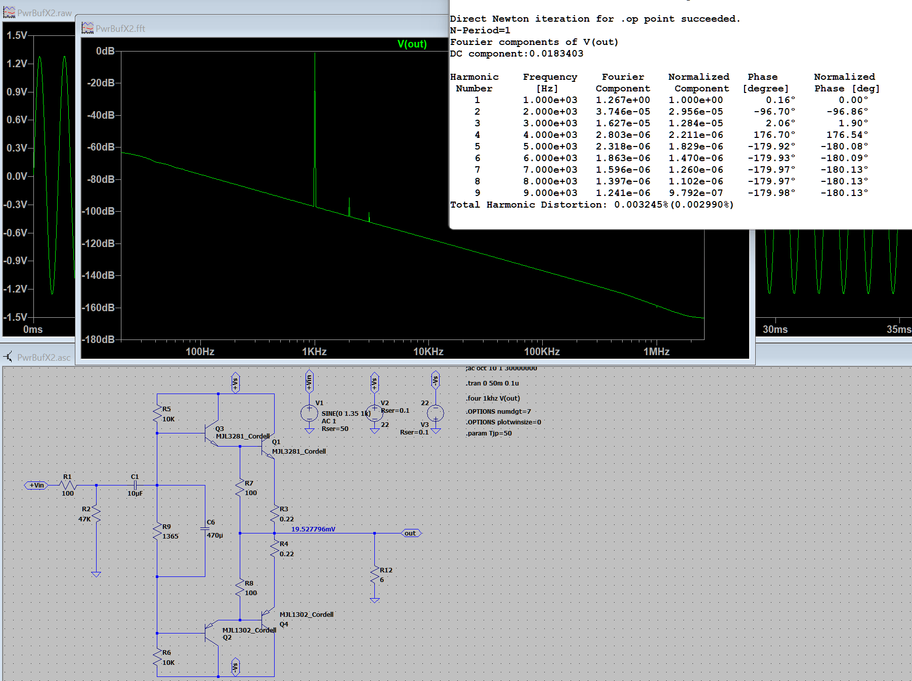

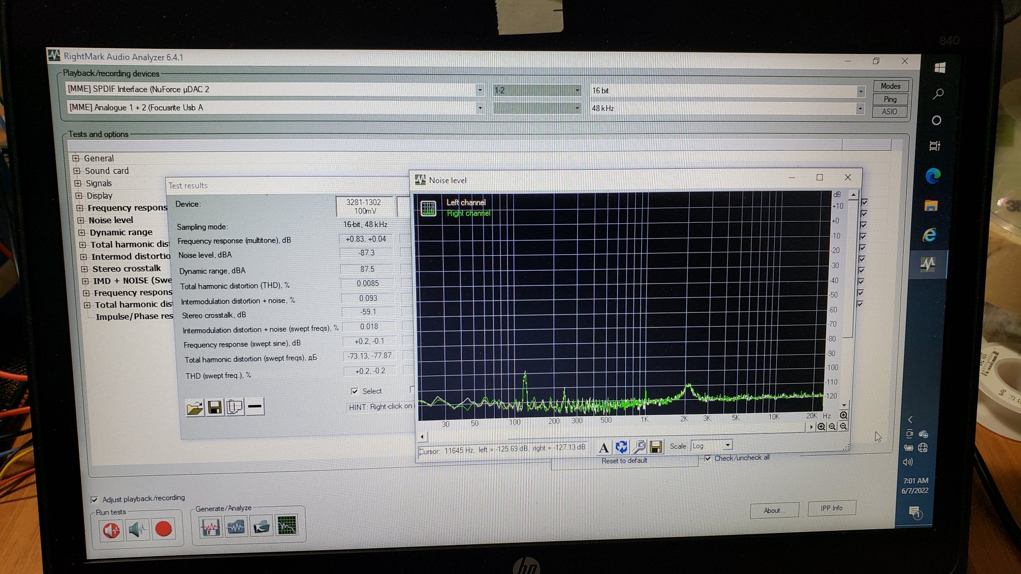

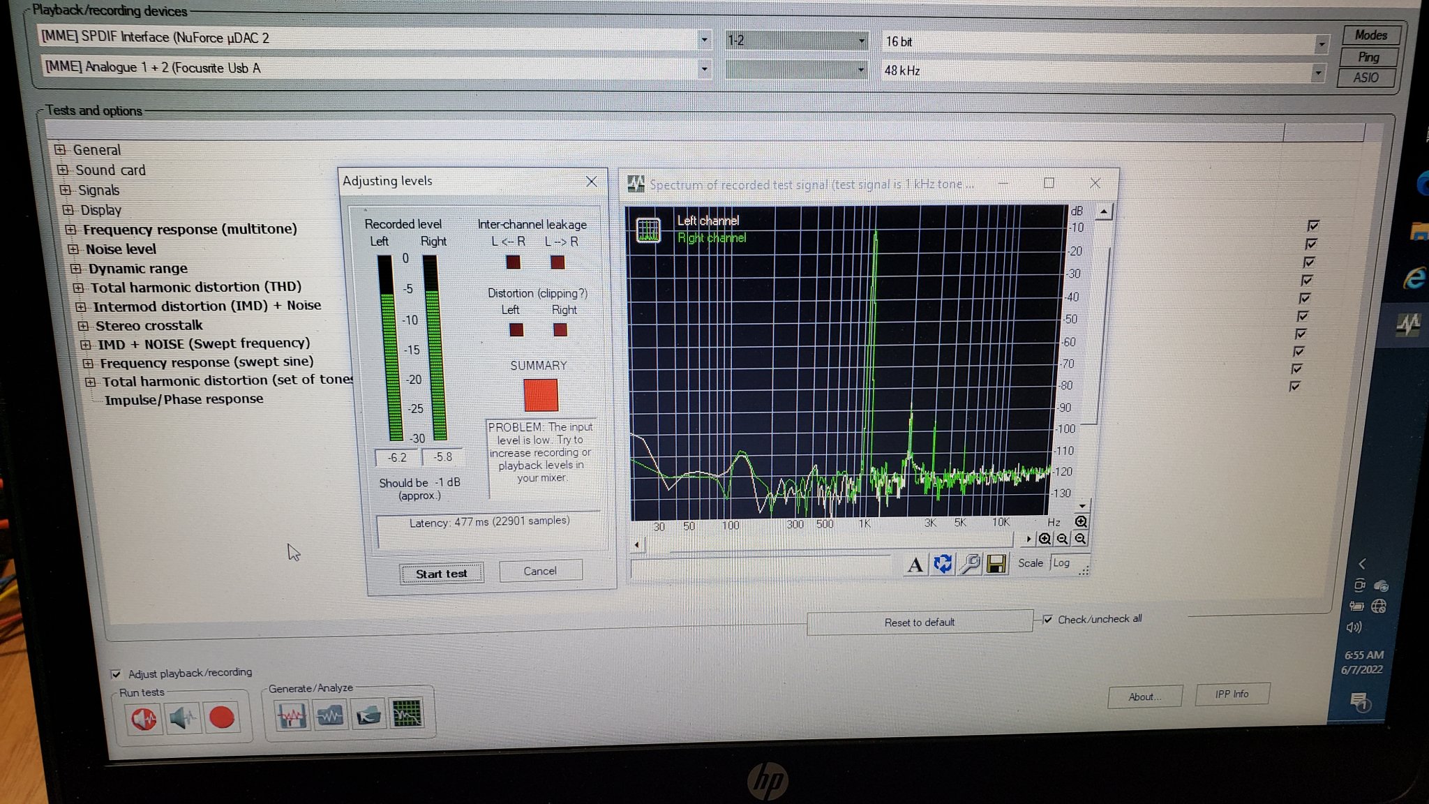

It measures impressively low thd 0.0085%, which is likely lower, had to use nuforce dac, as rta software refused to with with just focusrite alone.
I agree that distortion is likely lower. LTSpice simulation calculates for 2.7 Vpp to 6Ω load, 0.00325 % distortion at 0.46 A Iq. As LTSpice distortion calculations with Bob Cordell BJT models are pretty close to measured ones, distortion is probably less than 0.005%.
My listening session continues and I’m more and more convinced that there is some very high hidden quality in this simple wide power bandwidth, high slew rate, low distortion and no GNFB circuit. I’m occasionally rewarded with undiscovered soundstage gems.

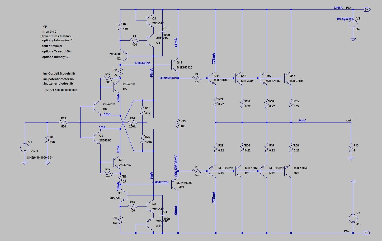

I sort of share some of the concerns above, but also find it difficult to make hard generalisations.
As it happens, the two most recent amps i have built and enjoyed are both followers, but more different than alike. Both are built as mono blocks.
The first one is based on a THF-51 SIT running at around 3A/30v with a CCS underneath, so a 60v PS. Two coupling caps, a polystyrene Multicap at input and a 10mF Cerafine at output. No pcb. Separate transformer/rectifier/regulator for setting the biasing voltage.
The second is a diamond buffer with 4 pairs 3281/1302 based on a circuit by diyaudio member SandyTodorov1. No coupling caps. 2.2A @ +-34v
Both have very low distortion at low power, and the SIT gradually increases in distortion towards its terminal 15W 4ohms while the PP amp preserves sub 0.01% distortion at higher powers. Tried running the diamond buffer at various currents between 1.6 and 4A before settling to 2.2A. The highest current did not sound particularly pleasing to me.
So, how do both amps compare at low listening levels but into a pretty demanding load which occasionally dips below 3ohms?
The SIT certainly has a charm and highlights voices and cellos. Does not do particularly well at either of the frequency extremes, has a narrower soundstage and significantly less detail. Still, very enjoyable.
The PP amp has a slightly cooler tonal balance, still does justice to voices and can suit a wider selection of musical genres. It also sounds faster, taller and wider but perhaps shallower.
There are some build differences between the amps. The SIT uses 4320 based rectifiers while the PP amp has the cheapest chinese bridges money can buy.
Some of my prejudices like SE operation and coupling caps seem to be justified in this comparison, while others are not. Neither the plastic cases, nor the multiple parallel devices, nor the pcb with a mask seemed to subtract enough from the PP amp performance. Ditto for the emitter degeneration resistors.
I intend to still try 4320 and Ge rectification in both amps and also to build a version of the PP amp with Sanken outputs instead of ON semi.
Below are the general circuits used.
