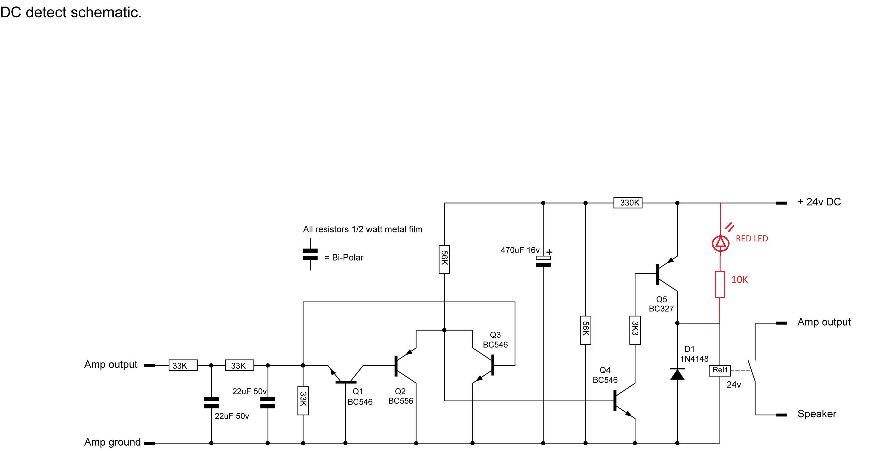

Speaker relay / on-delay /DC-protection

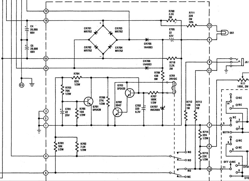

Hello maxpou,
have a look into the MARANTZ 1200 service manual page 37. There you'll find a simple but perfectly working schematic which I used since years in many power amplifiers (Rotel and Bryston clones). Only a few components are needed. I have a pcb-layout combined with optional soft-start relay available. If interested ask!

Hi Byron,
I want just the relay, because I have this circuit for DC detect. Thank you! Maxpou

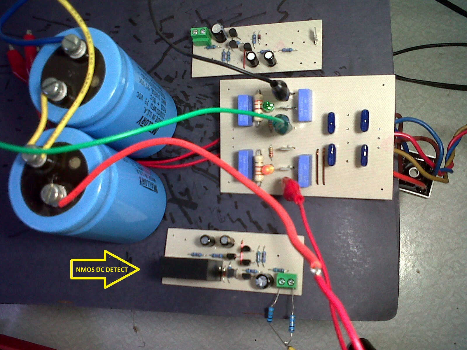

Was this the circuit from QUASI NMOS power amp?, I built this circuit in monoblock and while I was working on a PSU I did a quick check on my built unfortunately I did it in the evening so no power amp included..
Anyway am I doing it right? I'm not so sure 'bout the values though...I haven't tried to test the LED.
- output relay for power amp
