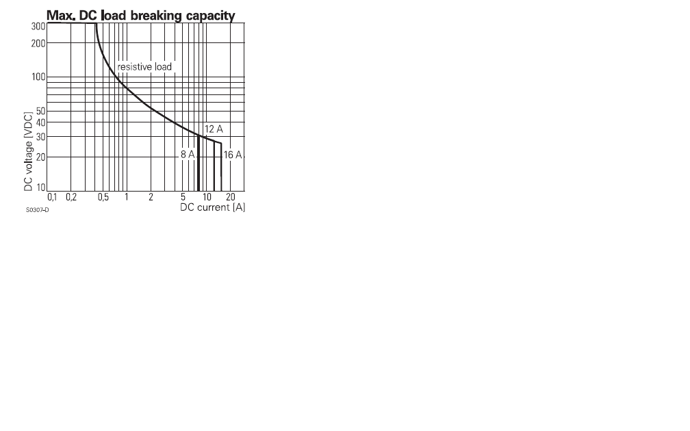

My 250 watter blew a channel this weekend . . .and took the bass units out on one of my B&W 703’s. As it went out, there were sparks and noises coming out of the of the amp and then a smell like burnt varnish from the speaker.
I was and still am mightily pissed off.
At first I thought it has the Vbe multiplier that had opened up, but after removing the module and checking the components, it seems an MJ21194, MJE15033 and an MJE15032 blew short. The pre-drivers, VAS and all the small signal components were ok, although the driver emitter resistor was badly burnt (this is a 27 Ohm that connects the two driver transistor emitters together – both drivers were short, so this resistor had 140V across it before it too open circuited). The 0.22 Ohm 7W emitter ballast resistors on the output devices made it though – even on the 21194 device that blew s/c. It looks like the output device failed short, put about 75V across the speaker, causing the bass drivers to fail.
Then I wondered why the MCU based protection controller did not kick in and open the output relays as soon as it detected an output DC condition. I took a look at the relays. Well, one set of relay contacts was ‘stuck’ (i.e. welded) in the closed position and the cover was smoked over in the vicinity of the contacts. So, it looks like the other two relays opened correctly (or dropped out when the power was pulled).
In my wisdom, and against everything I was always told about paralleling relay contacts, I had put 3 sets of relays in parallel (Tyco RP3 16A 250 VAC devices) in the interests of low output resistance. The MCU probably tried to do its job, so relays 1 and 3 opened up as the fault protection kicked in, but the last relay to open up was #2. I don’t know at this stage whether or not the failed contact actually did open correctly, only to succumb to subsequent arcing, or whether it simply stuck because it was well outside the DC load capability.
If you look at the relay spec, it shows the DC load breaking curve as displayed below. At 75V, the DC load breaking capability of the relay is about 1.1A, or about 10% of the probable current that flowed during the failure event. This was probably enough to cause the contacts to stick together and blow the speakers.
The lesson to be learned here is that relay DC handling specs really do need to be adhered to. So, I will replace this relay and fix the module up, along with my speakers, but for all new power amp designs, I will go with a different appproach. Many people recommend using an auto relay, but I checked out the DC load switching capability and its not clear that they would reliably switch on a fault condition. I did some research and the Panasonic EP(AEP) series look like they may do the trick - the 10A PCB mount version.
Now, I have to work out why the damn output stage failed in the first place.

The problem here is how to handle a clean relay switch over with 75 or so volts across the contacts and in my case about 6 ohms DC resistance. I took the relay out last night and opened it up. The contacts are truly welded together. I stuck a screw driver between the contact surfaces to try to pry them apart. No chance. I've taken a long hard look at this over the last few days and if you want your relay to be able to handle the worst case 'up to your *** in alligators' problem, you really need a good relay.
I looked at the auto relay but they are spec'd for 13.5V and from what I've seen the relay DC specs, the current capability drops off quickly as contact voltage goes up. The Panasonic relays I referred to in my first post look pretty good. Single contact set rated to switch 10 at 100V. They also spec the relay for higher current switching, but with a reduced life.
