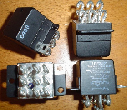

The Amplimo relay is rated at 50V/100A, makes 5000VA, not worth a lot at DC conditions, certainly not at 75Vdc.
Example of relays that do handle such heavy DC conditions, NOS spare parts for Leopard tanks, +2KW each.
=> http://www.diyaudio.com/forums/atta...lass-wasting-power-something-past-lre-bfr.jpg
(max of 27.5KVA at 115VAC)
