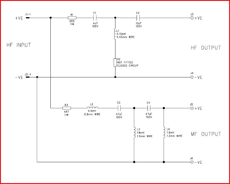

Power amp problem will be solved this weekend I hope. It's not overly complex BTW PMA. It's a classic fully balanced bipolar design and I am sure there are thousands similar to it out there. Like I said, sh1t happens, just like it seems to have done on the Marantz.

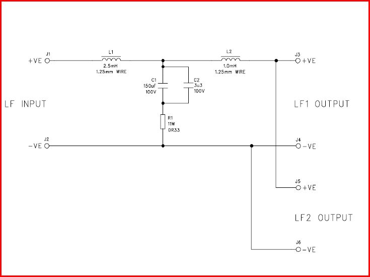

Are those the B&W cross overs Mooly?

Update. When I mentioned that speakers sounded different, it was because I had hooked them up to my Marantz PM7000 for a quick listen. Well last night I swapped the speaker connections over on the Marantz. Turns out the speakers (after the bass unit replacement) are 100% ok. It's the Marantz that is playing up. Looks like this new house I am in is jinxed for amps!
Yes they are...
