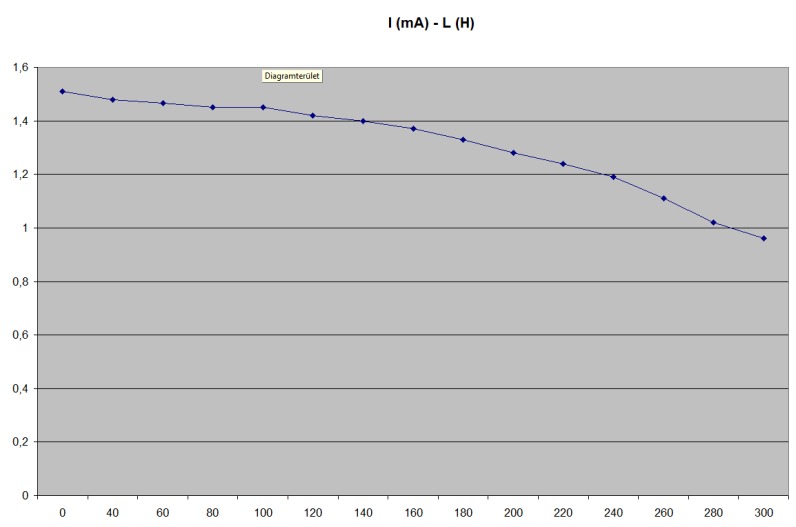

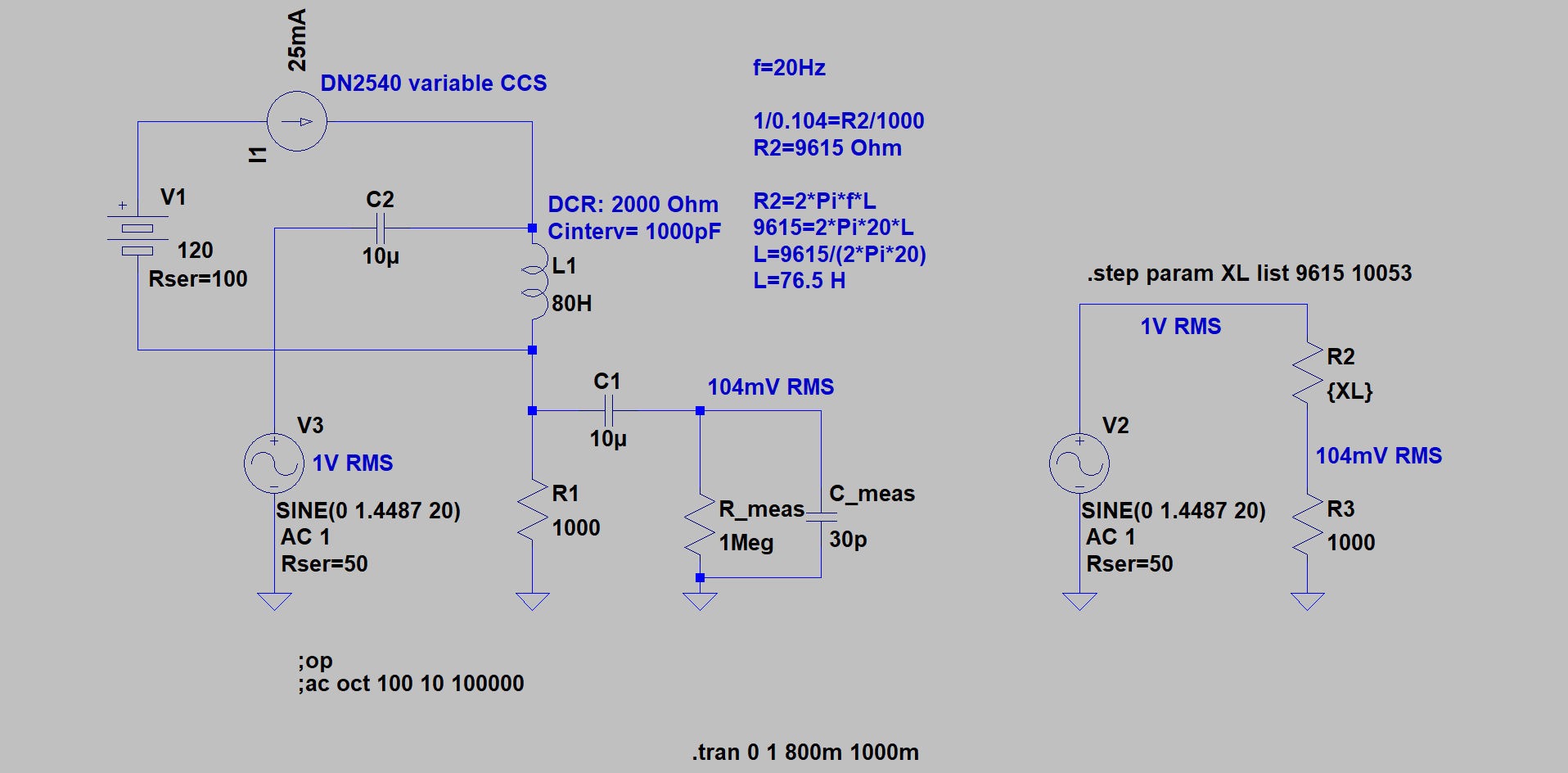

The whole idea is false , the inductance is not much lower at low level ... I wish to measure 25H with a LCR bridge ( very low sine level ) and to have 100H when the amp is giving some power
I want to measure the inductance at near full power. The turns ratio of my transformer is 20:1. The mains voltage over here is 230V. So what if I connect it to the mains, and load the secondary with a 50 Watt car light bulb? And then measure the phase shift of the primary current somehow, and calculate the inductive reactance from it? Do you recommend any alternative measuring method?Why don't you simply measure it and see for yourself?
Cheers
Ian
Sorry, I meant why don't you measure the frequency response of the amp as 1mW, 1W and so on to see if the response droops at low frequencies at low levels. Obviously you would need to disconnect any NFB from the transformer secondary but you are not worried about distortion.I want to measure the inductance at near full power. The turns ratio of my transformer is 20:1. The mains voltage over here is 230V. So what if I connect it to the mains, and load the secondary with a 50 Watt car light bulb? And then measure the phase shift of the primary current somehow, and calculate the inductive reactance from it? Do you recommend any alternative measuring method?
Cheers
Ian
