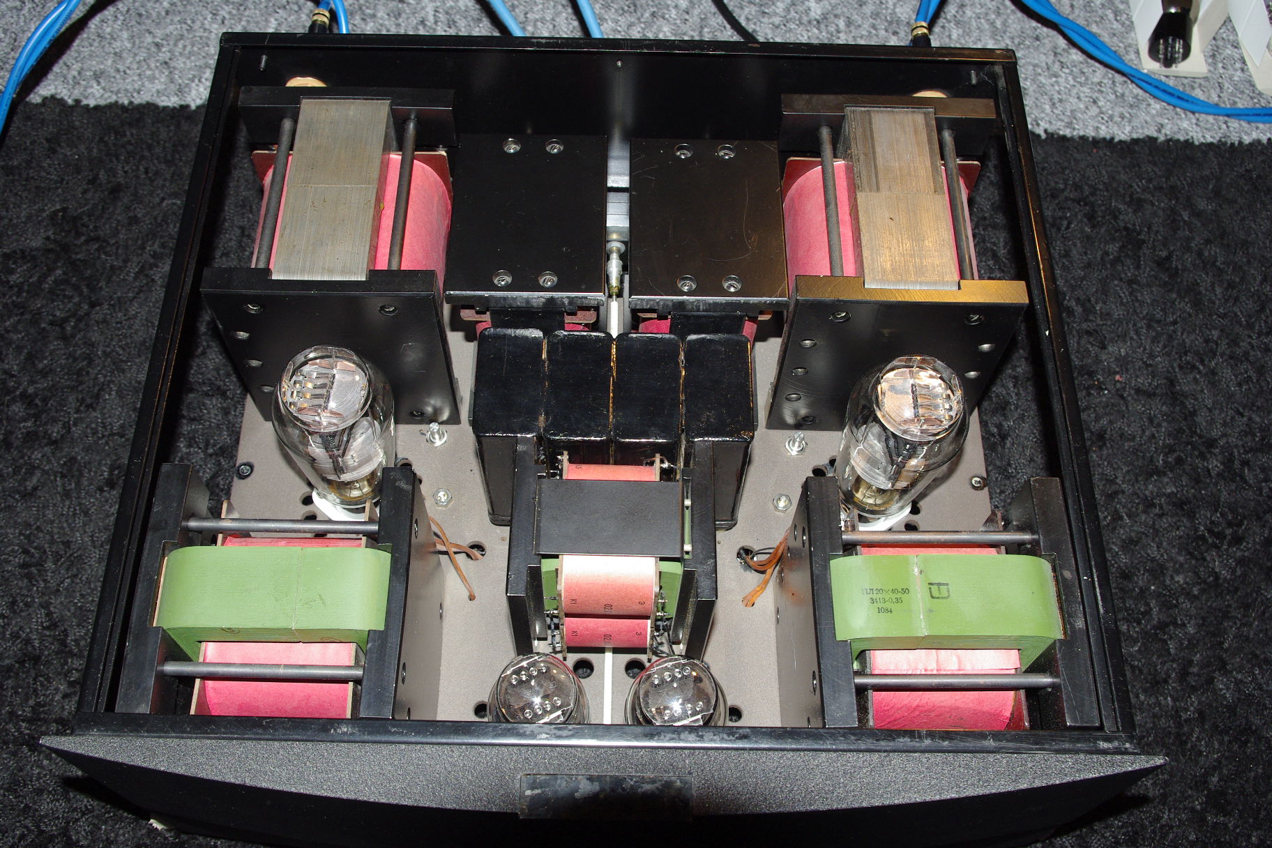

I was just reading this older post by Bud. I have a few OPTs including amorphous, and the one I'm using in my system is one of Bud's earlier commercial SE models. Sounds very sweet and natural. Fortunately I have one more SE of his as well, plus a pair of his PP. I respect his thinking.
I'm trying to do as above - work out the best option for a plate choke for the input stage. Dave Slagle for one can build with nickel and that's an option I'm interested in. Probably with a 10Y valve so needs 200H inductance.

You made a good point, so I tested it out. 10Y with a single 126C at 100H against 2 in series at 200H, used just as plate chokes.
Conclusion is that the 200H of two in series is clearly better sounding - more detail and clarity, better timbre, more treble definition and air. Better all round in fact. The single 126C clearly works, but it's rather flat and dead sounding in comparison, and with an audible loss of clarity. These are cheap units and anyone thinking of using them with higher Ra tubes like 26 and 10Y should, in my opinion, go for two in series. If I order a different plate choke for the 10Y I'd be wanting 200H on the basis of this test, but with a different make who knows - results might not be the same?
Andy, that's a great finding...I would never thought about this like this...I would have expected the opposite: Better bass response with more inductance, but a less engaging sound as the dc-resistance goes up like a cheap choke vs. an expensive one...
So, great finding, will try this
