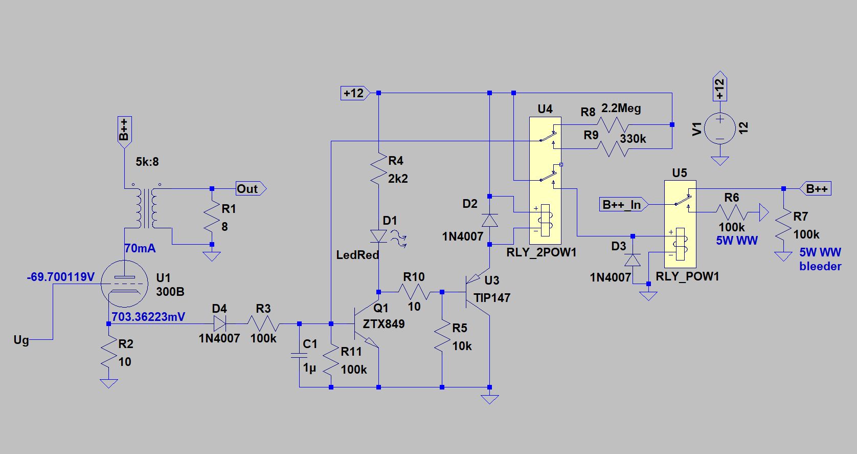

Few years ago (during the Covid) I played with fixed bias protection problem.
Simulated this schematic, but I've never tried it in practice.

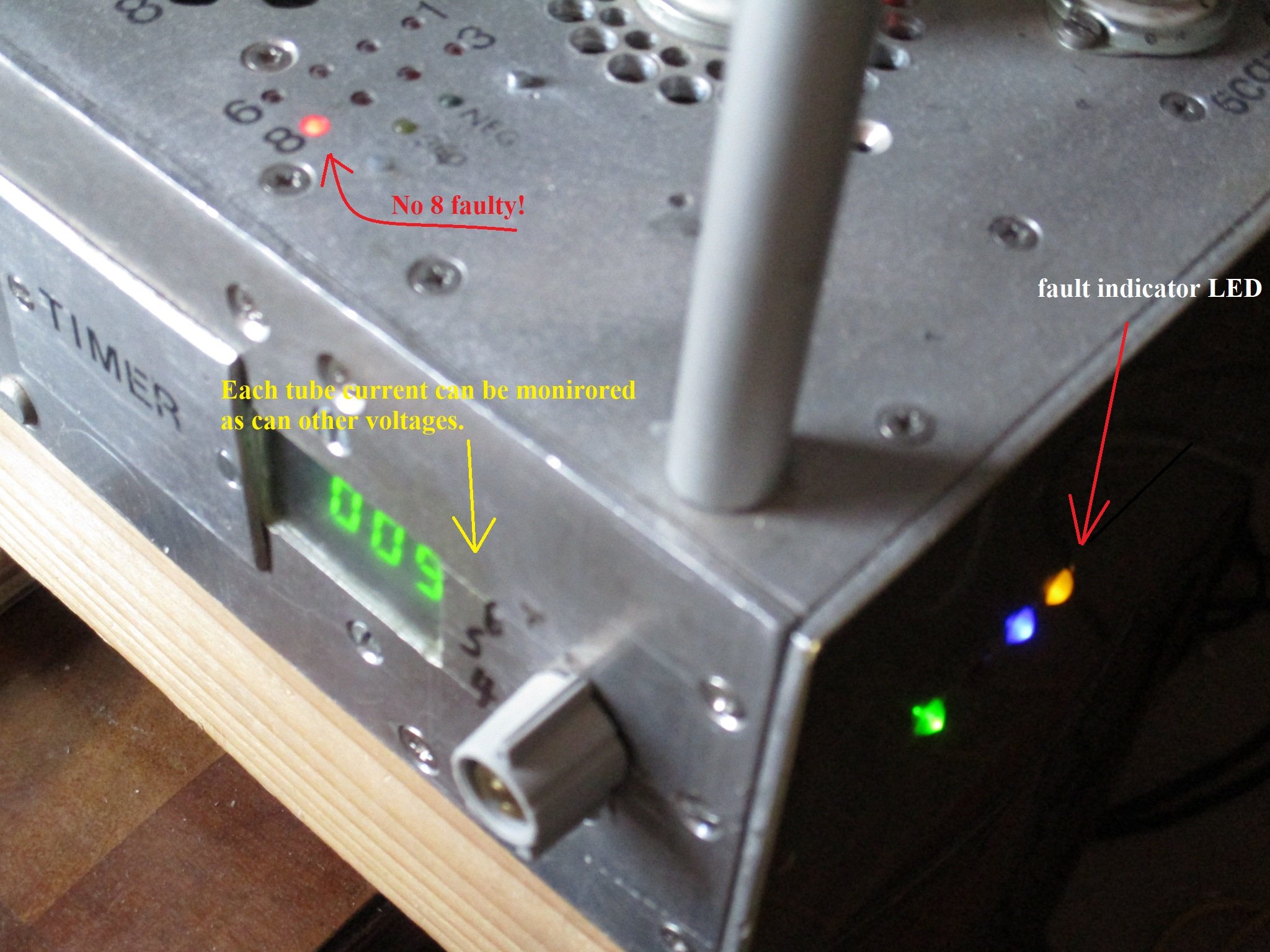

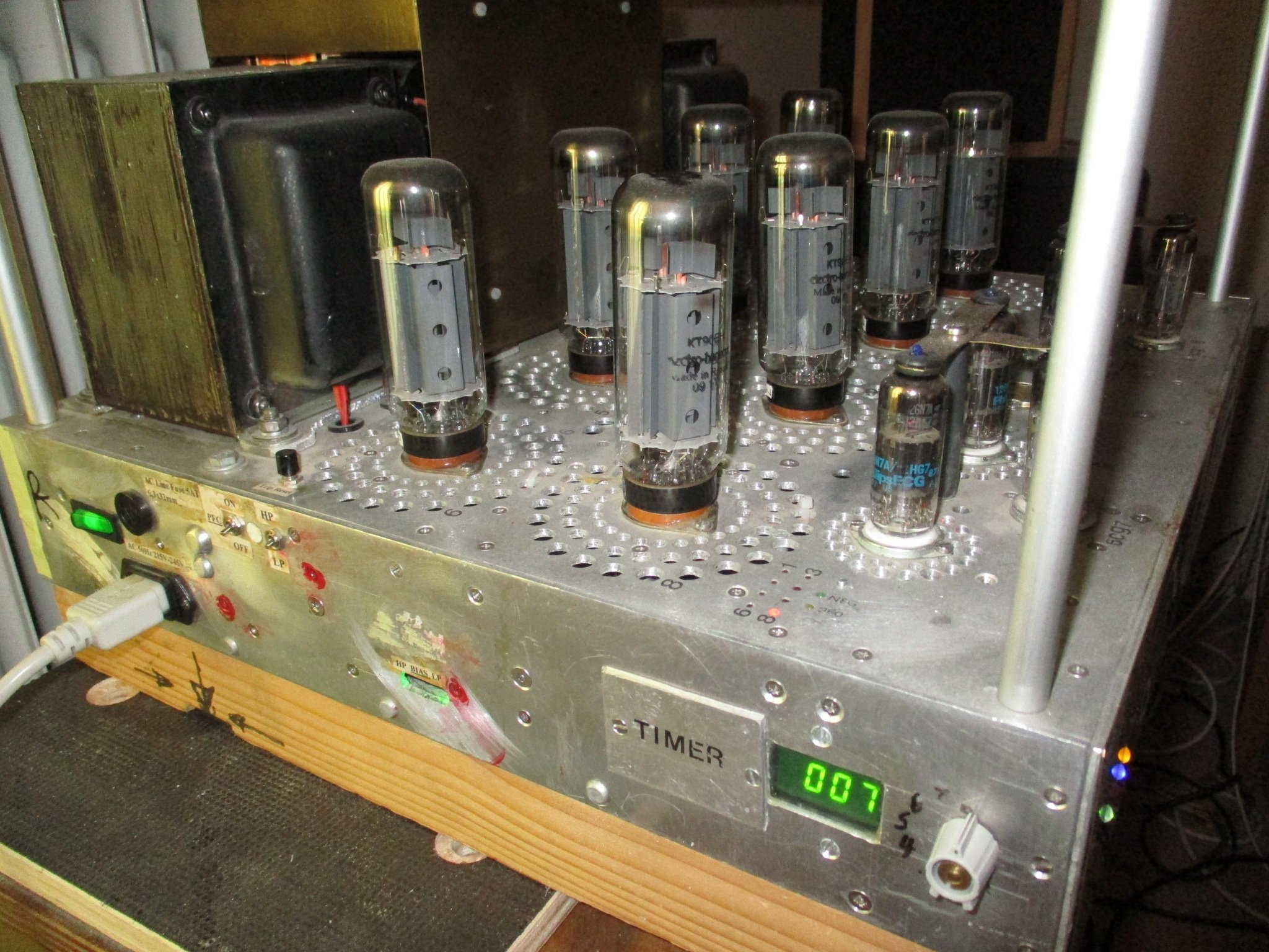

That´s why I use LM339 comparators set up as window detactors with SCR latches to monitor the differential between B+ and neg bias voltages on my power amps. That´s one method. .....all this dirt easy stuff but like Turner some can be fairly complex. The SCR latch can either switch-in a common cathode resistor or go for the whole hog disable B+ function, which is my preferred. This method also protects against a higher mains voltage, eventually a higher B+.The circuit made to reset by either cold or hot power reset. The other caveat to avoid false tripping or inhibit function when using SState sensing is the neg bias supply must appear before the B+.
Music wise, I´ve come across tube amp systems handling extremely heavy bass beat note headrooms that can easily overload an output stage which with other methods can result in false tripping.
One method I´ve used is current sense monitoring each power tube within a specific parameter and when drifting out of spec actuates a window comparator eventually to a flashing led ajacent to the suspect drifting tube. This requires a long TC integrator DC filter, plus trip voltage comparator but I found this method can be fooled by using loudspeakers with lower impedances. (Maybe not such a bad idea after all)
Tubes are pretty robust with abuse but reliability with fuses is not. As others mentioned, P Turner configured many circuit ideas on these issues.
The pics below one close-up of sensing section of the 500W power amp. A close up of the "fault" pic indicates No8 tube (deliberately fitted) has failed accompanied by a fault yell LED on front panel. This behemoth amp uses the total B+ shutdown function.
.........Ingenuity abounds......
