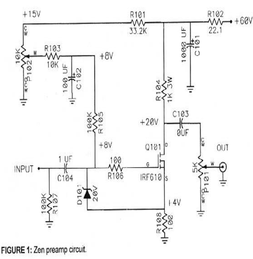

Anyway .... i will try, if i find it, to change some values in my bride of zen line preamp attempt in order to be able to use it with a 48VDC smps from Meanwell. I have already suggested that most of its noise is out of the audio range and i am curious to listen.
From what i have gathered the BOZ project is very useful to check the quality of a PSU having very low PSRR .... therefore all the noise reaching the mosfet will be presented at the output

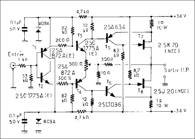

Where I can find the schematic of the a 8W Hiraga amp?

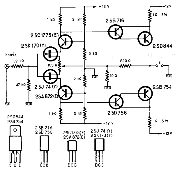

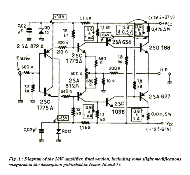

Hiraga amps ...
Hi ! thank you so much indeed 🙂 these are nice clean and simple i think
The fact that they sound good it is also very interesting.
This could be a very good option for a low power integrated i guess 🙄

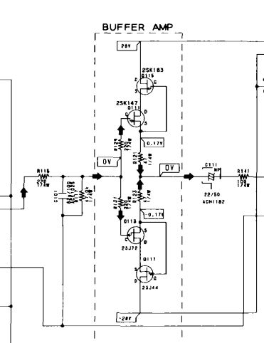

you missed the Pioneer's output diamond buffer which has no global feedback but has a different approach for that matter to keep distortions low enough, not very low though...
Audio research has another diamond output too

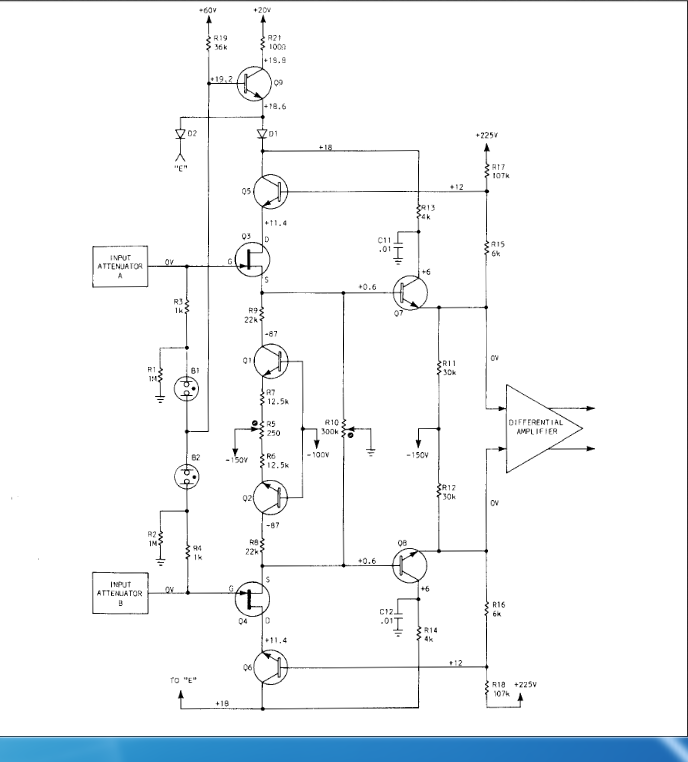

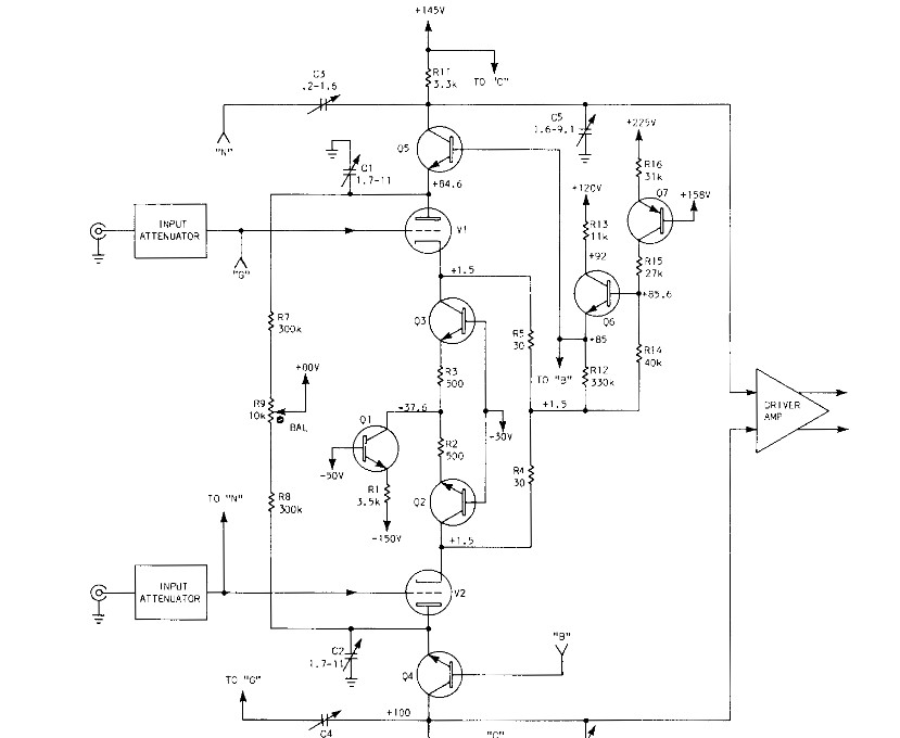

For the input buffer you might like to read this Tektronix manual who's bufferes were used by harman kardon in some designs i think .
https://www.davmar.org/TE/TekConcepts/TekVertAmpCircuits.pdf
