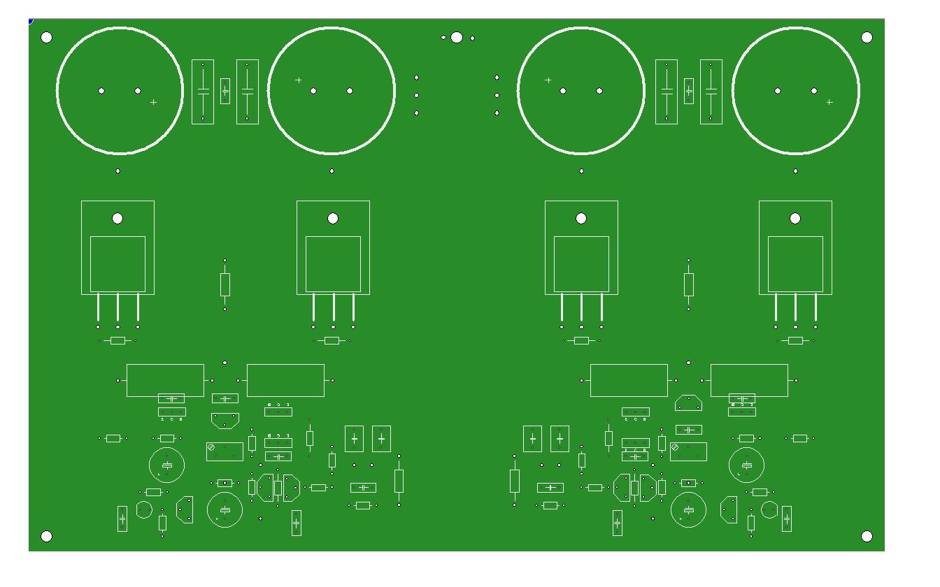

Through the economical crises .... been way too busy as usual but favorite projects will always consume some space in my mind ...
Box , case, chassis, looking good easy to produce but most of all in a reasonable cost was always the question in diy
Huge mistake everybody does including me is to design circuit and pcb and then look for the enclosure ...
Best way and more cost effective is to choose an enclosure and then built the pcb around it
With these in mind i made a new lay out ( i think now i should be in version 125 or so
) that features all of the above described goodies plus a couple new mostly in the power supply + some degeneration and its made to fit in a simple 2U chassis with drills onatop for ventilation and a simple but thick U shaped aluminum for heat sink ( given that bias will stay in a low to reasonable level )
Notice that transistors are mounted onatop but backwards so heat sink is directly screwed on them, the all board is to be secured on the chassis bottom ...
Will produce this pcb also , put it to work and evaluate the couple of new goodies and always post my findings here
