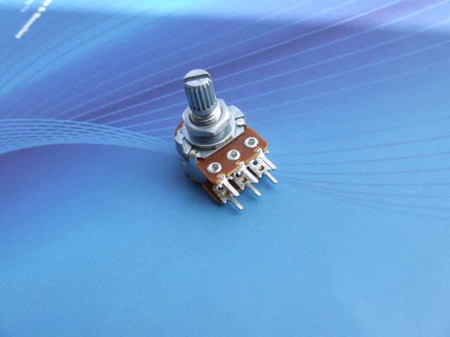

Sounds very encouraging! - did you try the P3A without a pre-amp at all, I thought it might have enough gain without one ?
I tried it with the 10k stereo log pot on the pic and Marantz CD57MK2. Don't know who is producer of the pot but it looks like exact replica of Alps RK16.
I usually don't like power amps with passive preamps (pot at the input) but P3A works fine in that configuration. The sound is detailed and open, not dull at all. But I still prefer active preamps. With passive preamps there is a certain lack of ultimate dynamics, the sound has less grip and authority, everything is a bit softened and bland. Passive preamps are for people that prefer gentler presentation of music but I like max drama and emotion, even if the price is somewhat more aggressive sound overall. If one doesn't have active preamp it is possible to use pot for some time if that's the only solution. Very few, if any, amps will give their best with passive preamps. I would always go for active and use small gain of 6-10dBs in the preamp.
I think that P3A will work excellent directly driven from PC sound card output, but using software controls is not practical for some people. The feel is much better when using the real knob than when sliding faders on the monitor.
