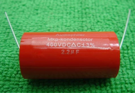

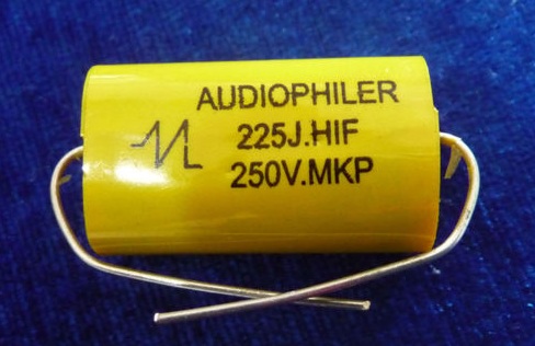

speaking of capacitors...... i am thinking of buying one of those lot of 10 from ebay. do they worth as input signal caps?
I have them but do not use them because the others sound better to me. I often say that as long as MKP, the difference is not critical. I still think so but to my ears even small difference is critical (if it is what I will have to listen to).
If I have to choose between those MKP and a good Nichicon NP (electrolyt) may be I will choose the latter for its small size (so to prevent noise pickup).
These are about the cheapest MKP (metallised polypropylene film) caps you can buy. They are Chinese made and I certainly wouldn't rely on them for passive speaker crossovers. Perhaps OK in standard filtering applications where the size doesn't simply cause them to be aerials for EMI and increase the noise level, spoiling any lower distortion advantage.
If they are input caps, keep them off the amplifier board and place at the input source or fit grounded metal shields, as necessary for any huge signal caps in noisy environments like AB power amplifiers.

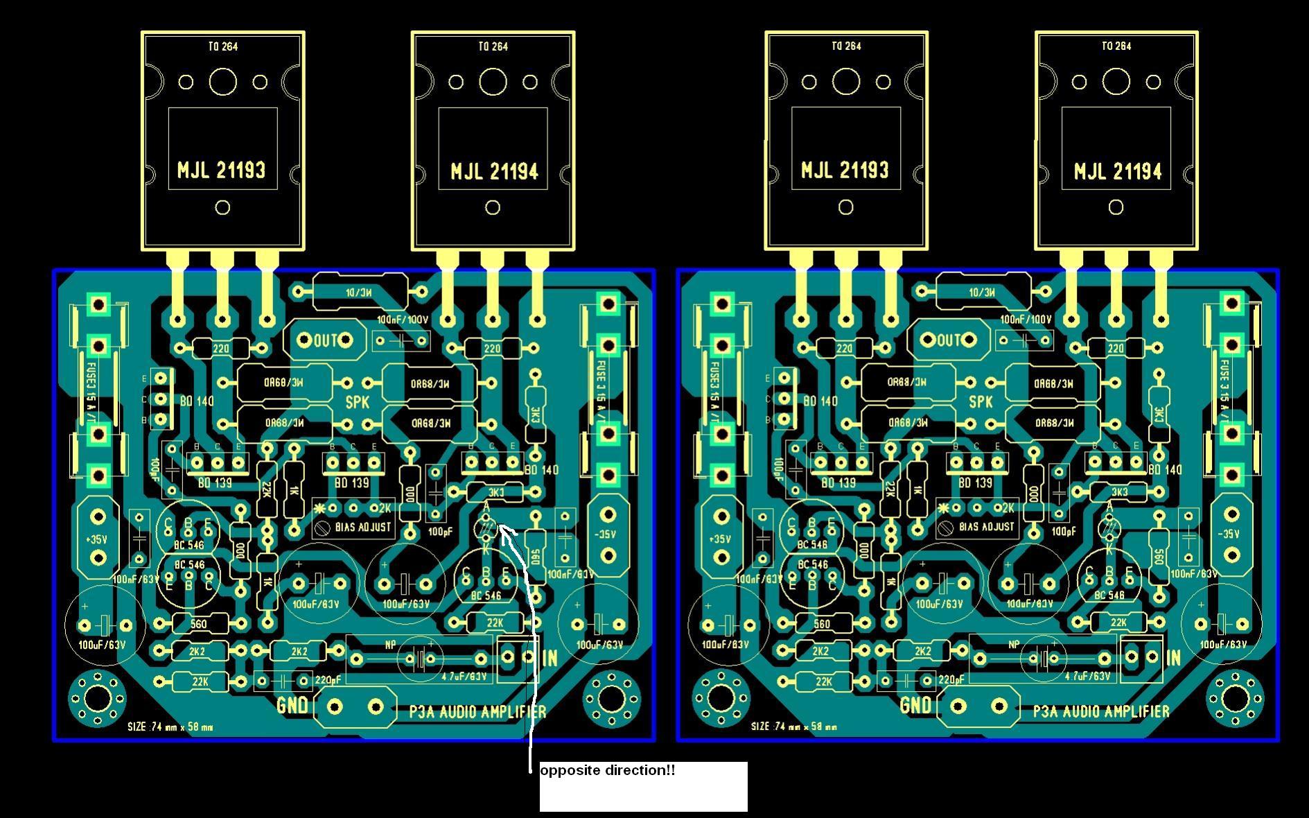

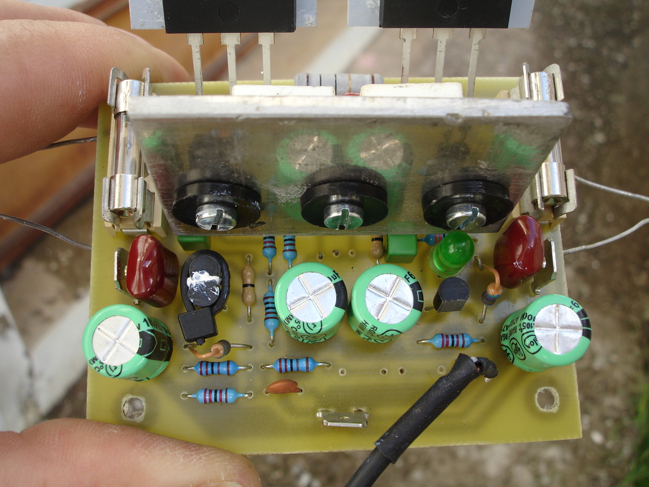

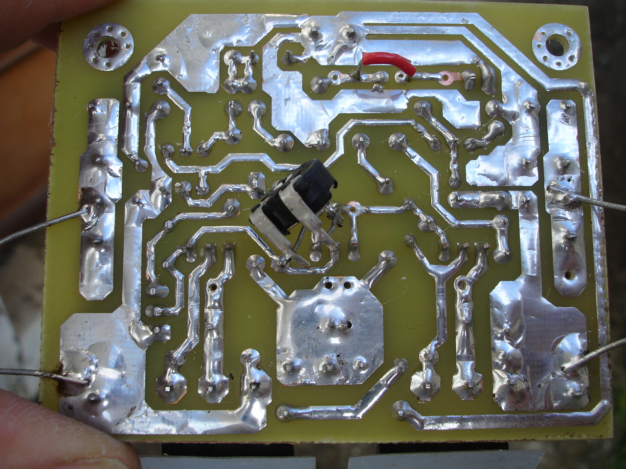

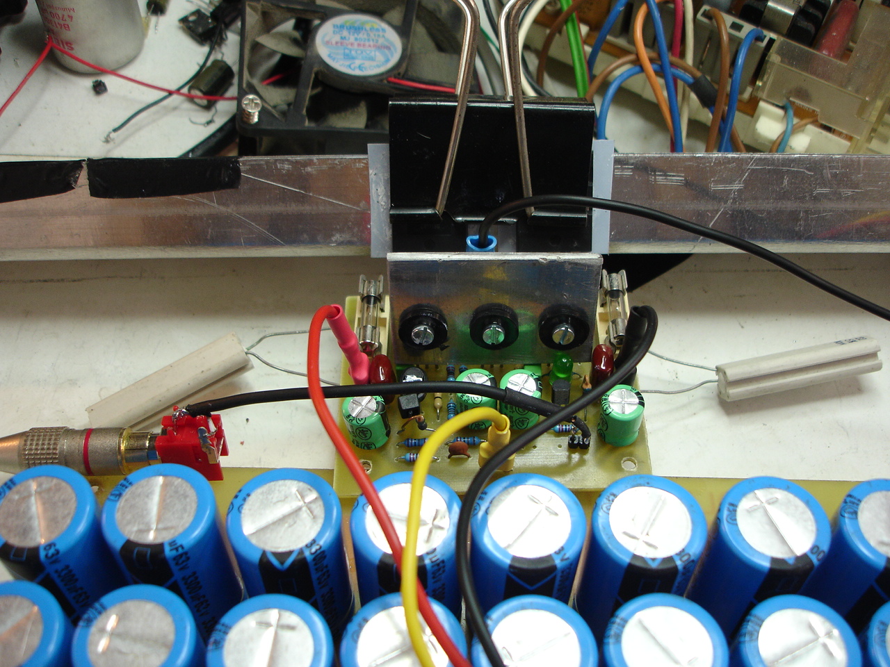

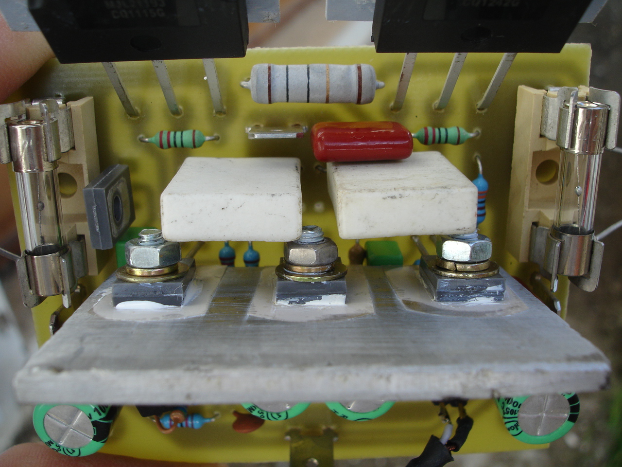

After first unsuccessful test this time everything is ok.
As i mentioned in previus message,this pcb by Alex mm have an issue with led (v reference)polarity.
This issue has as result a burned tranzistor on ltp and possible fault to 560R(led series resistor).
In this case V= -35v is present on output.
Now all is ok.
Pictures from this first(second)-fire.

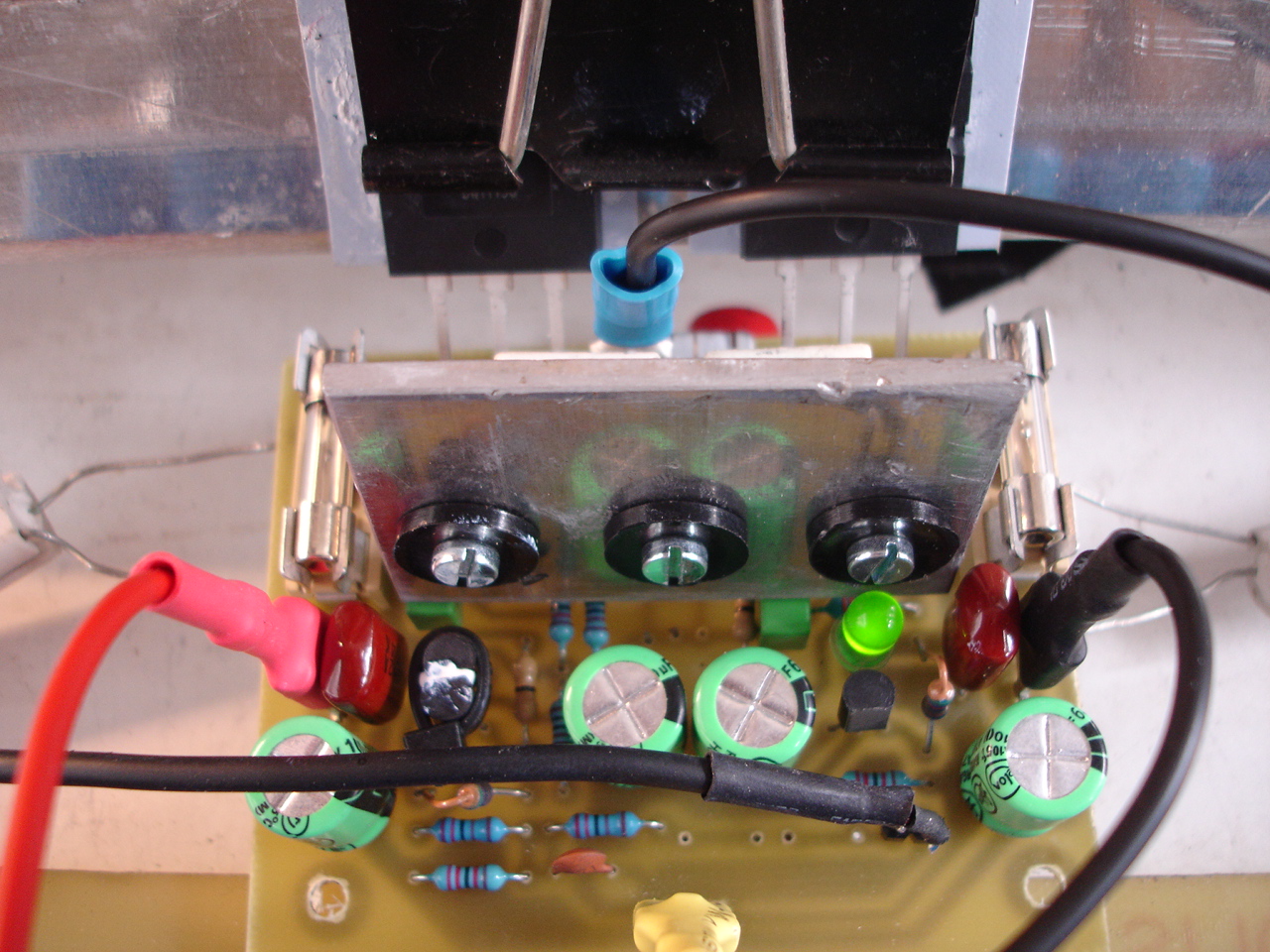

Looks nice ...do you have a scope or any other test equipment ?
Can we get also pictures of the power supply ( looks quiet beefy ) I wonder about distribution though .
Kind regards
Sakis
Power from a commercial amplifier plus 50.000uf in each rail just for first try
+-32mv offset .
I have oscilloscopes and function generator (not very low distortion type)
I want some time to test this board.
See this test.http://www.diyaudio.com/forums/solid-state/173462-studio-reference-amplifier-122.html. post#1217
