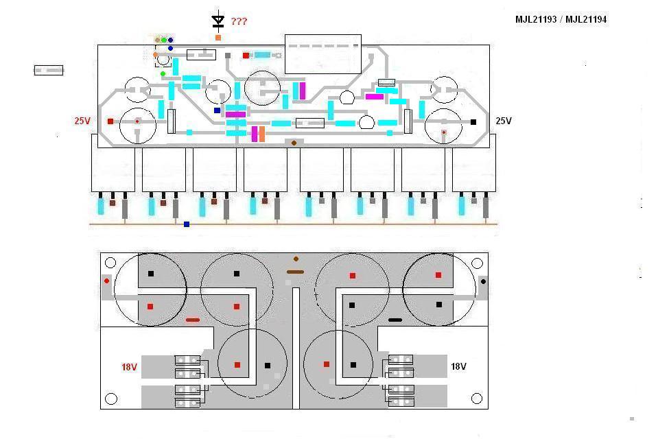

you may now be tempted to try the BD829/830 in your DX Blame ES to see if the effect is as marked as Sakis found in his P3A![]()
Im ready
But from what I have heard/read about Dx, and now here the close looking P3a, we may need the opposite of what Sakis has achieved with P3a
Dont know if that makes sense
Sakis, I hope you dont mind me showing my layout version of Dx, just to show where I would like to take it
to be honest with you ...no i dont mind at all but i also dont understand what oposite means ...
also i cannot understand much of your pcb or your "version" of DX
also to put things in a proper track i have no expirence with your schematic or P3A versions that drive multiple outs in such a low rail voltage ....
probably what you present is moded circuit of something else ...
kind regards sakis

Frontend and driver layout I have shown is 100% straight Dx, no changes so far...unless I have made mistakes
Mainly I do it to learn, and to put me in a position where I can at least hardwire output stage
A year ago I would have had no idea about it
I can see my post was confusing, with regards to saying that P3a and Dx maybe needing pushed in opposite direction to each other
1. I understand from Carlos as if Dx may be a bit on the soft side, which I interprit it as maybe being a bit grainy
2. I dont know P3a, but it sounds like you are saying you have pushed it in the direction of sounding softer, nicer
All in all, that indicates to me like P3a and Dx start out at opposite ends, regarding their sound nature
But I know all to well to NOT say stuff like that, considering having not heard any of them
But then, isnt that what describing sound is supposed to be good fore
So, how is the sound nature of P3a, before you modded it ?

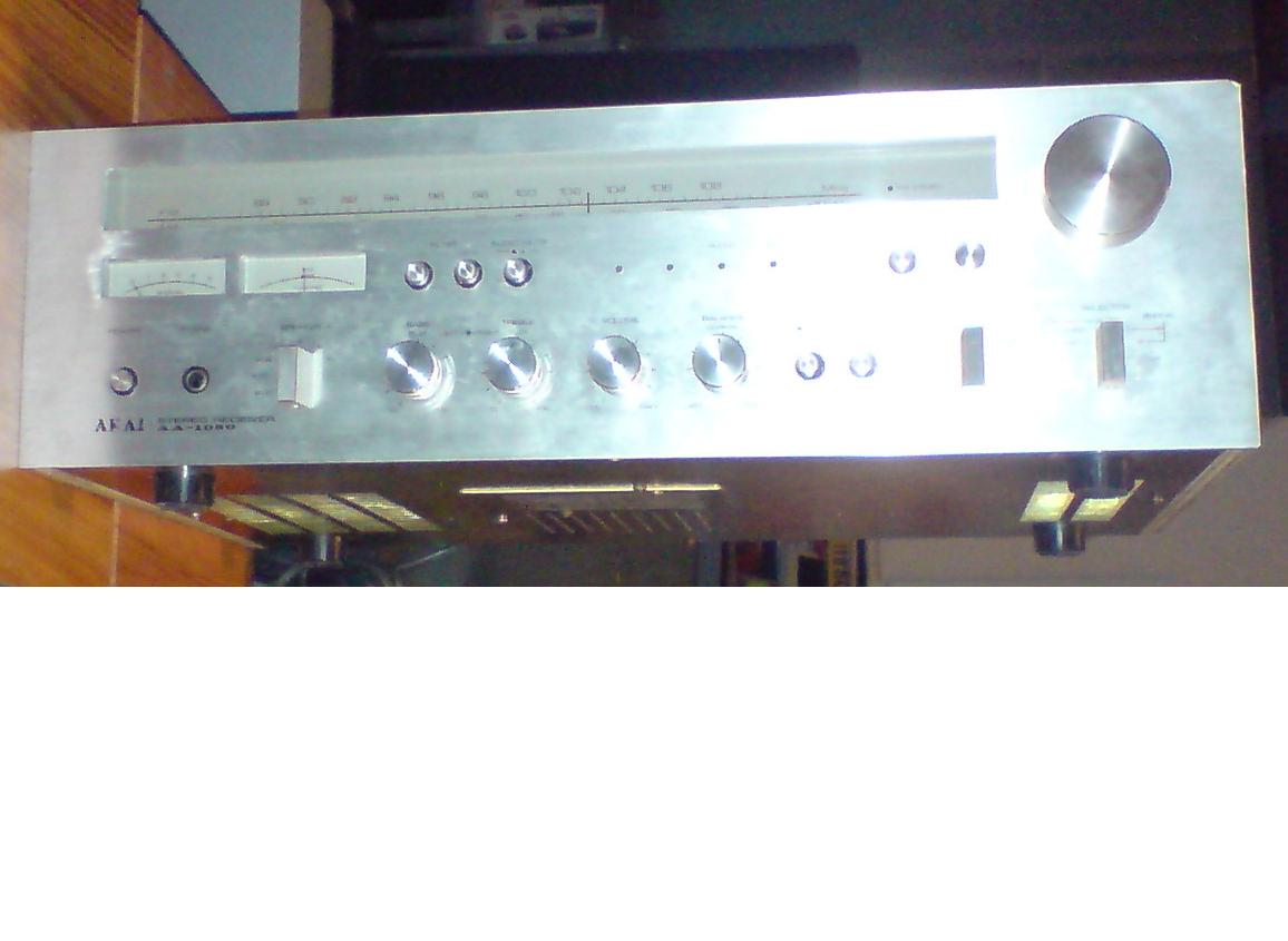

service akai am75
SERVICE AKAI AM 75
AKAI AM 75 visited my shop for repair seriously canibalized from a costumer that wanted to practice his repair skills ( very explosive !!! )
quiet a hard job to do since this amplifier features
1 gozillion curent surces

service AKAI AA 1050
A terrible machine ....compaired to todays standarts its a complete cr@@p
no serious damages a classic story ...all capacitors dead and replaced all pots and switches cleaned very carefully ( any day i will uprise a thread about contact cleaning with a new product i invented that seems to rock but still in testing mode ) ...a few lamps also replaced tuned...biassed ...idled it and go
enough power above 50 clean watts wonderful semis inside terrible crosstalk figures even though the selector switch is a mastepiece of engineering at the times signal rooting was terrible so everything jumps from here to there .... an average tuner with good sensitivity but not that good sound ...
Question why ???
why people spent money on machins like that ??? only a few things one that its nice to keep alive ...a unit like that will never be produced again in the feature... and then if you skip quality mambo jambo for a minute the sound that comes from this machine has unbeatable colorations that of course are not real or correct but very dear to listen ...
let us not forget that this machine has a very good chance to outperform me since its expeted to live another 30 years ...at least ..
regards sakis
