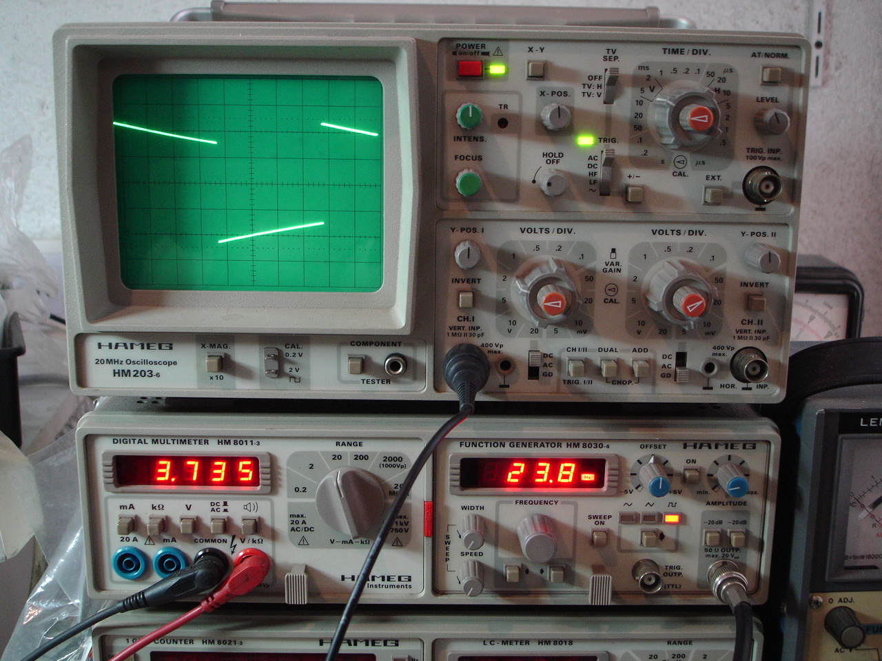

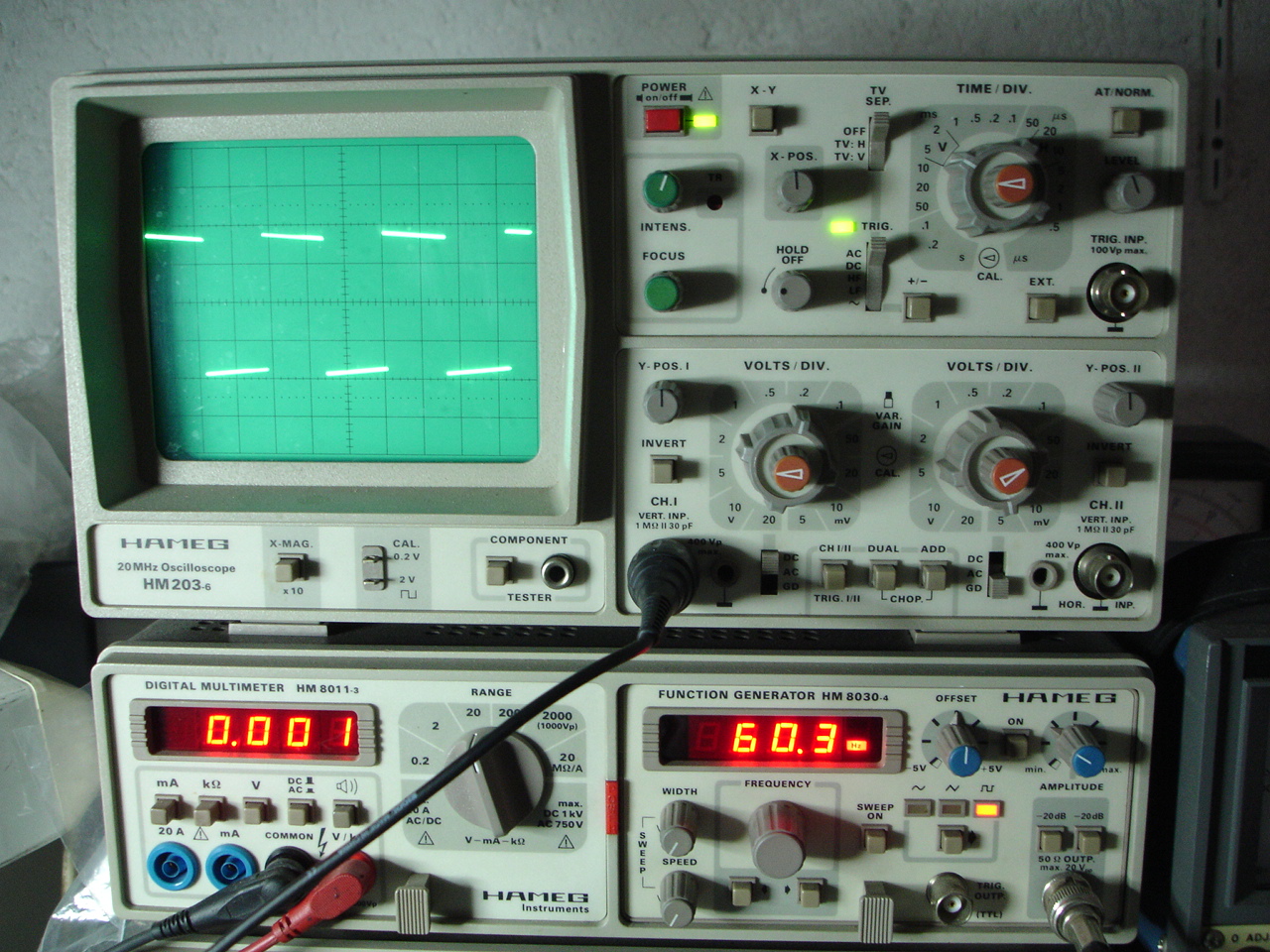

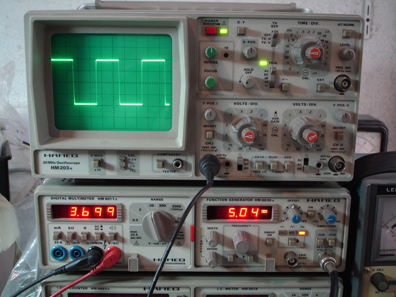

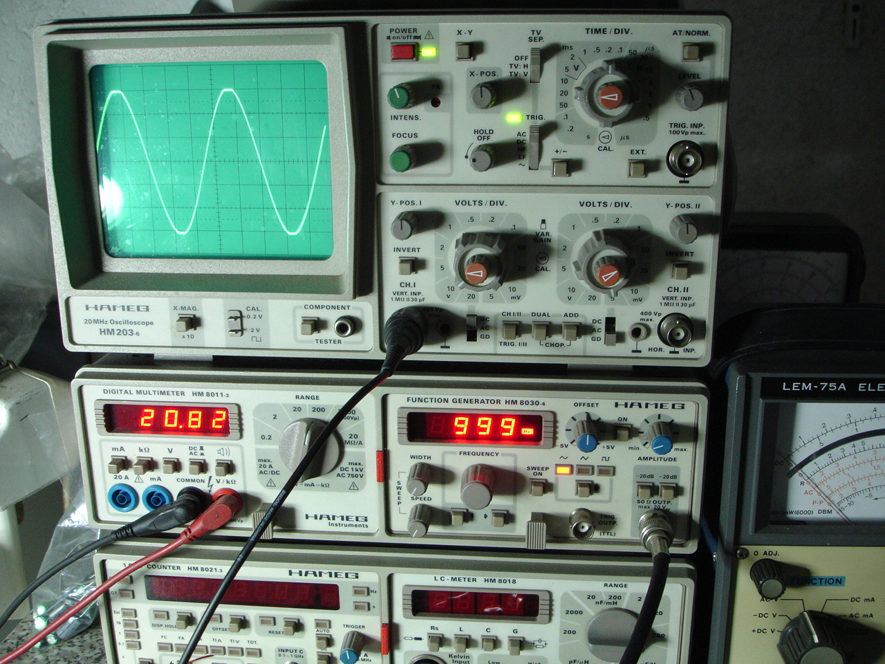

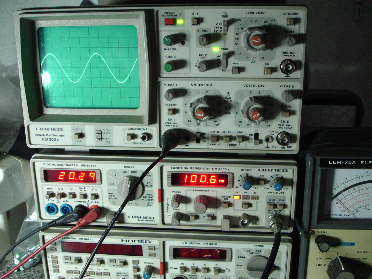

Some other measurments 23Hz to 70KHz
volume down 1,7w .
This time with a new probe Sr. AndrewT
volume down 1,7w .

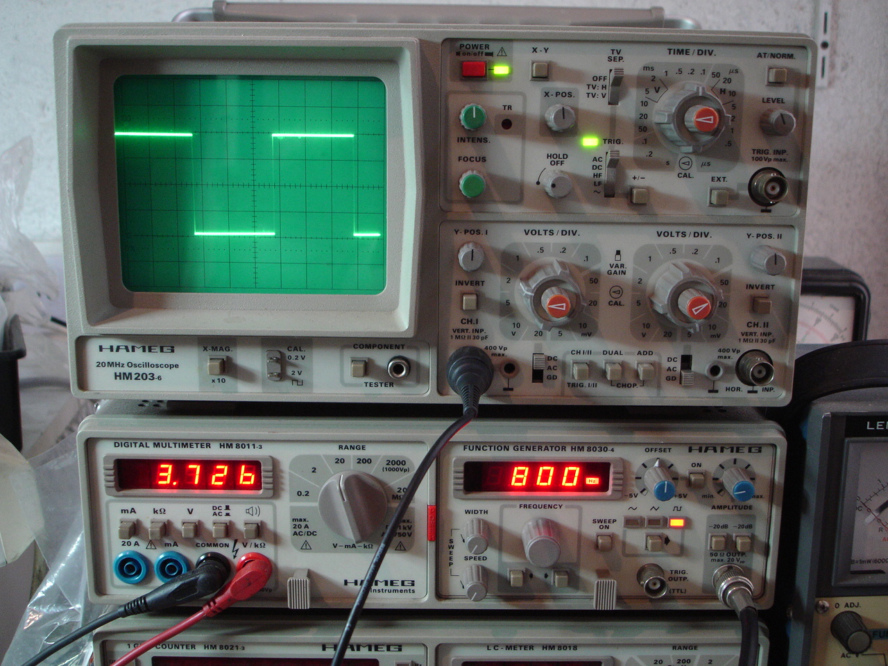

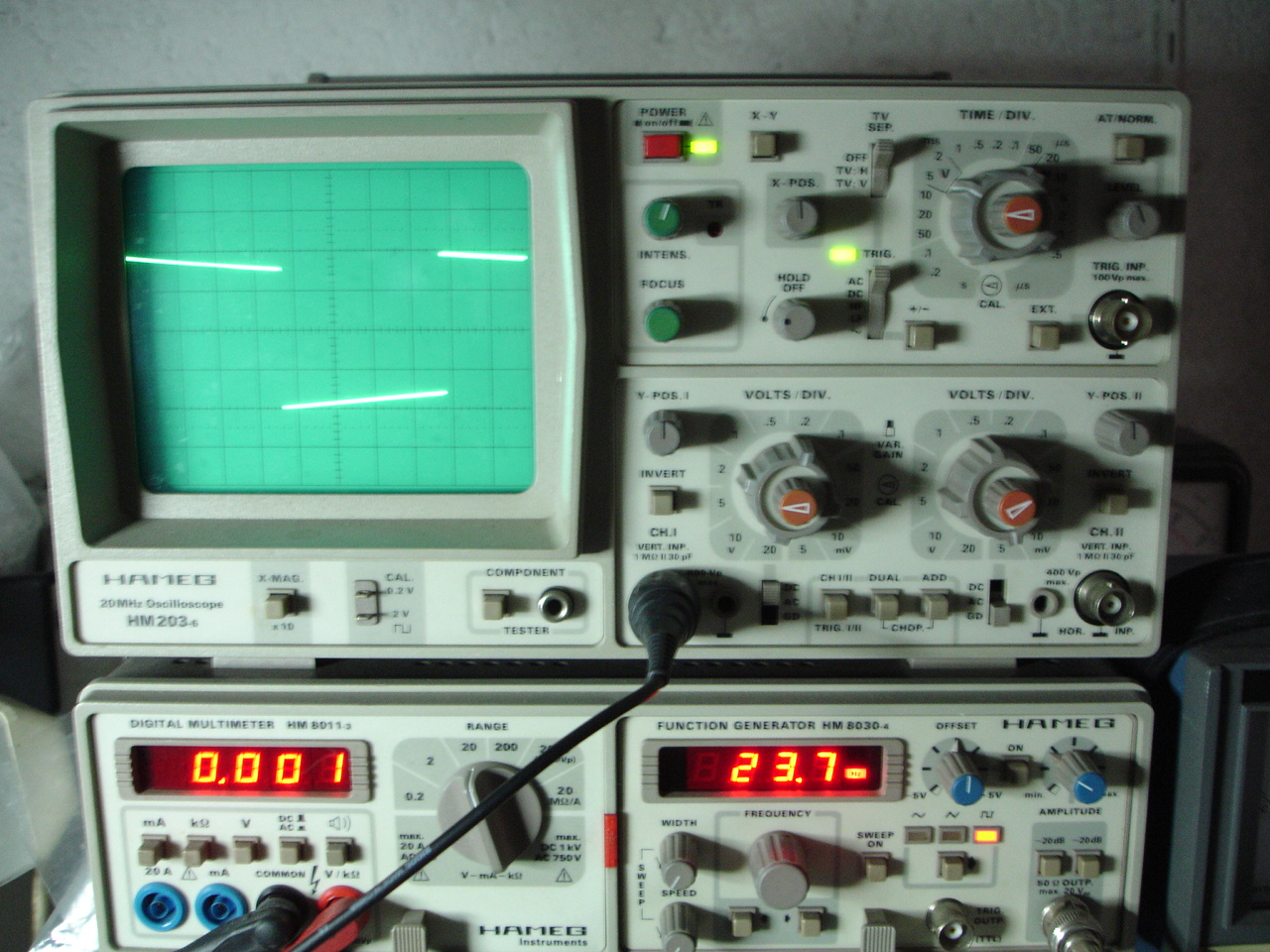

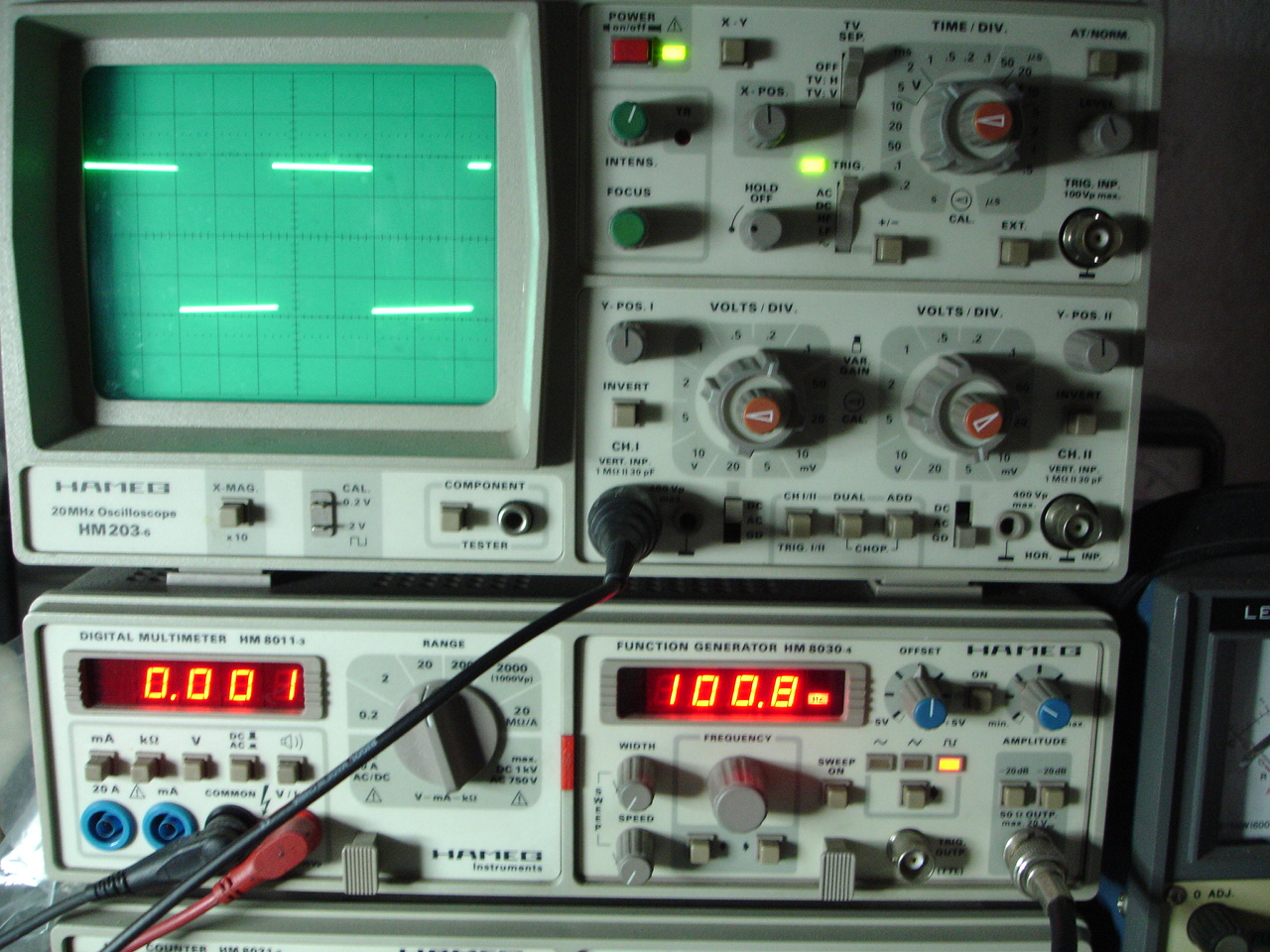

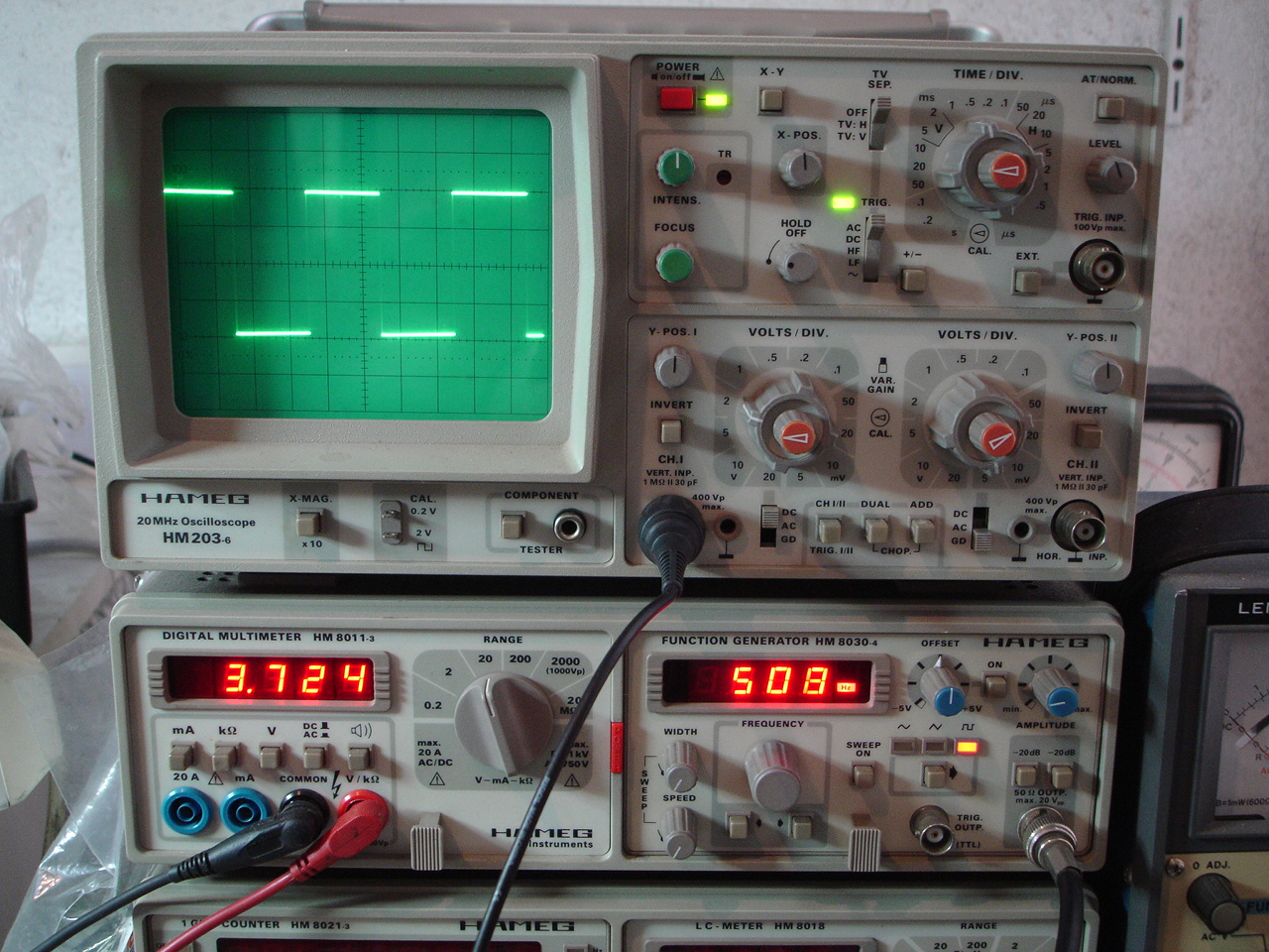

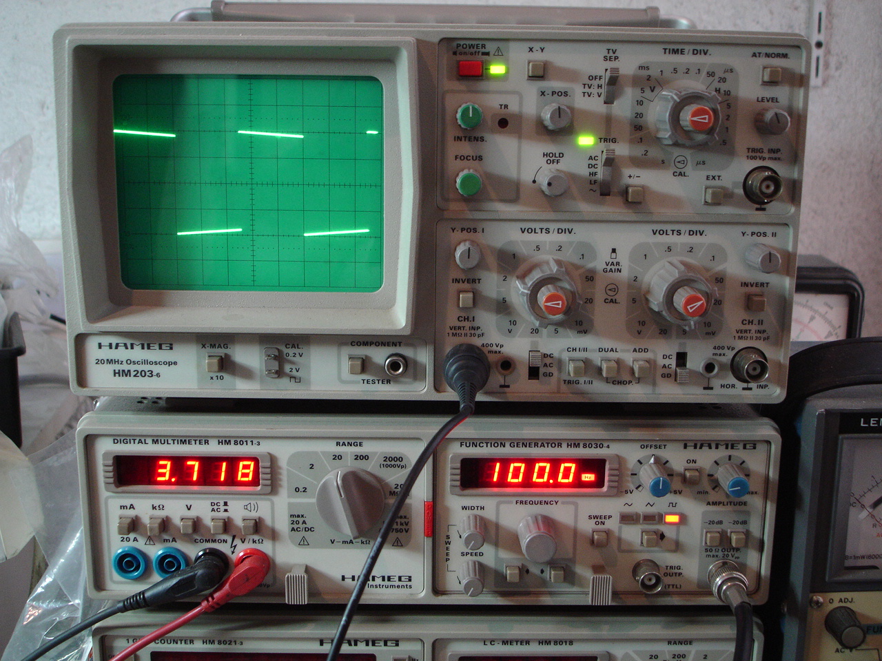

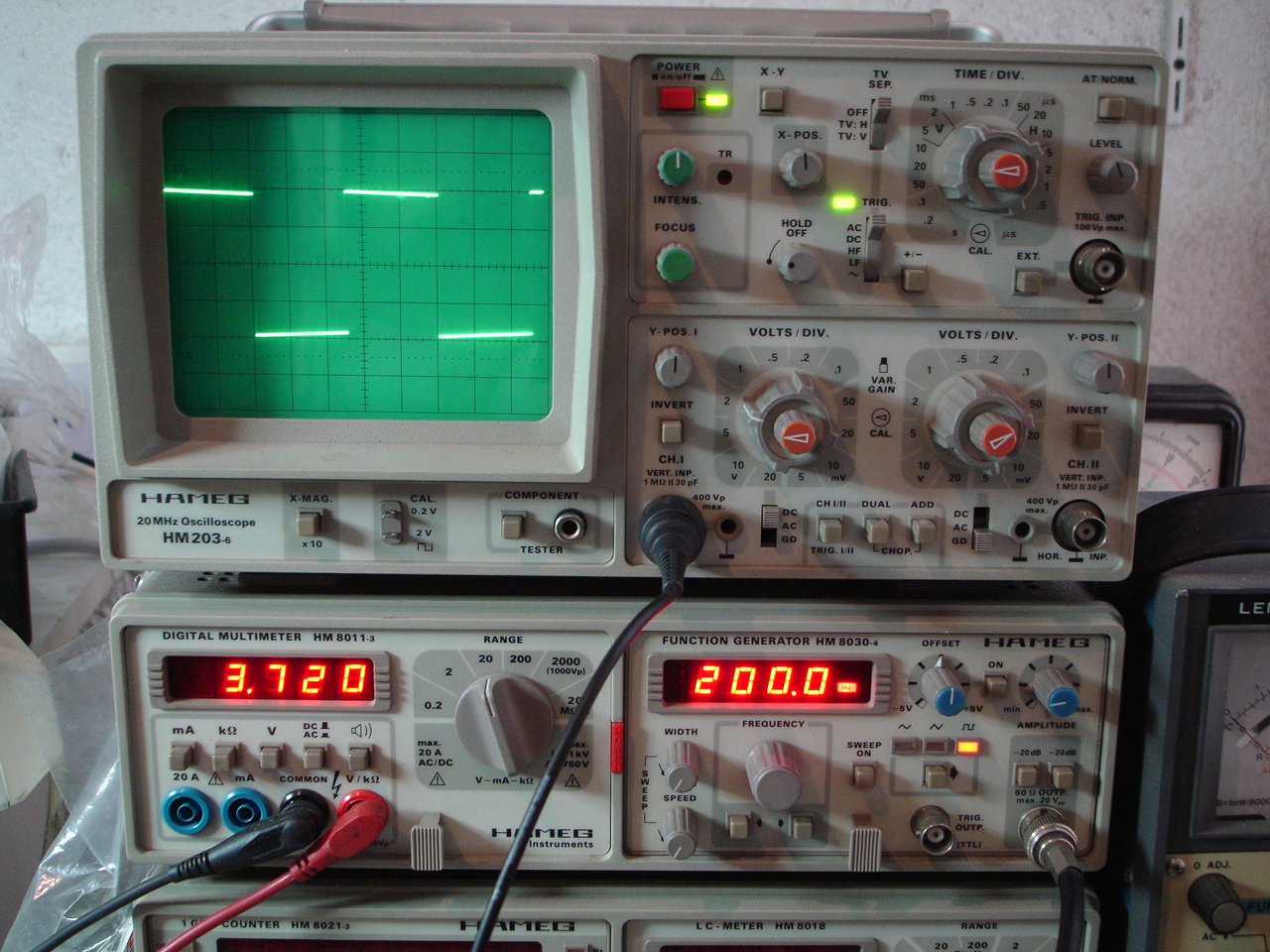

Where has your bass gone?
The 800Hz looks flat. All the test frequencies from 508Hz and down show bass roll off.
the squarewave test should be at a voltage significantly below maximum.
As such the PSU should have virtually no effect on the amplifier's processing of the test signal.
We would expect 100Hz to be near flat and 10Hz to show some significant slope due to bass roll off of the AMPLIFIER.
The scope is set to DC input.
The roll off must be in the amplifier.

As AndrewT commented, this is low enough power for the amp. to not be affected by a weak power supply.Some other measurments 23Hz to 70KHz
volume down 1,7w .....
The roll-off seems fairly constant at 6dB/octave above 50 Hz and this suggests an error at the input or VAS stage with the size of the cap. or the PCB routing. It's easy to check initially by increasing the values, even while the amplifier and 'scope are running (at low power and with due care).
Re comparisons with other builders: Sakis already posted 'scope shots of his P3a back at the opening post. In any case, no amplifier should show roll-off at 500 Hz.

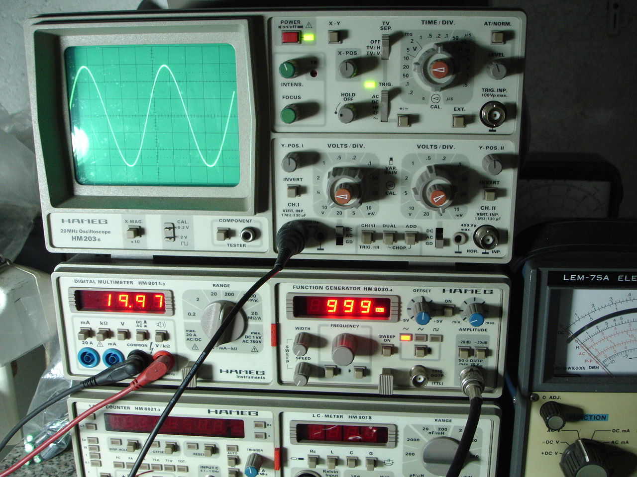

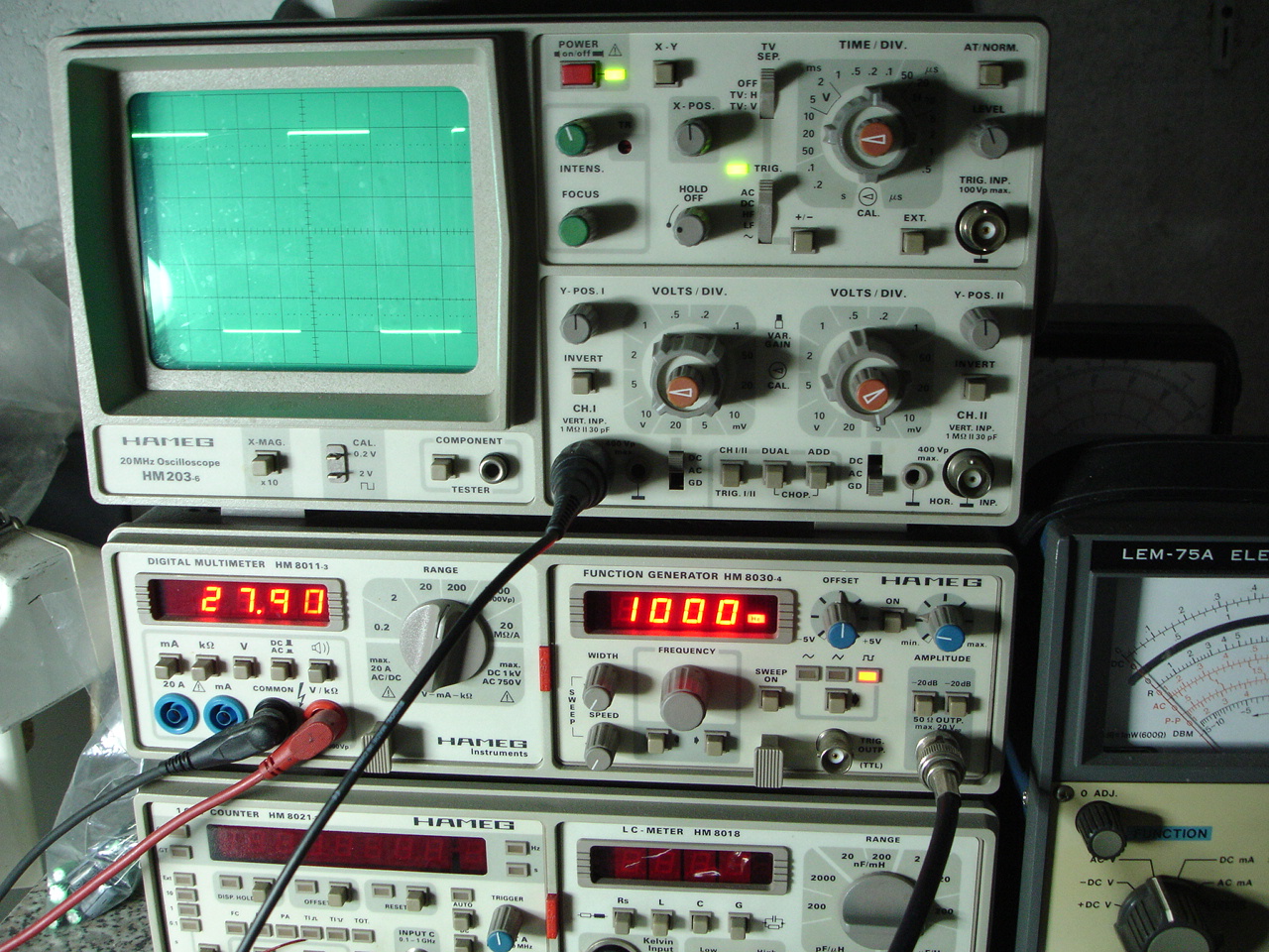

P3A

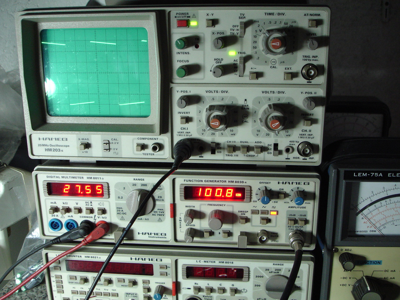

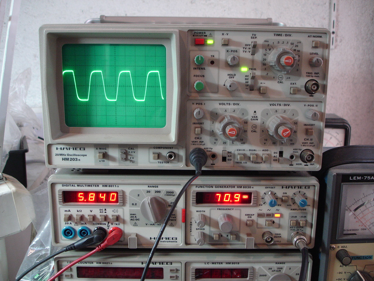

Thanks all of you for your interesting.
This afternoon i tried to see signal input just after input capacitor with power off.
Note that signal before input capacitor is flat.
Please take a look at these patterns.
Next patterns on volume just before clipping.
Sakis haven't post scopes in low frequencies behind 1KHz.

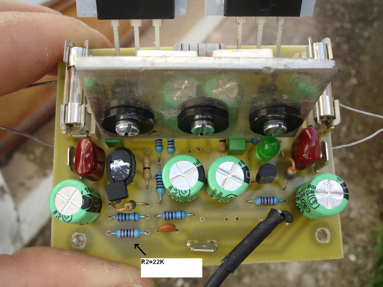

Hi thimios,
If you are seeing a roll-off on one side of the input capacitor and not the other, there are two possibilities:
a) The input capacitor is too low in value.
b) There is too much loading on the non-input side of C1, e.g. Resistor R2 is too low in value.
Have you checked these components?

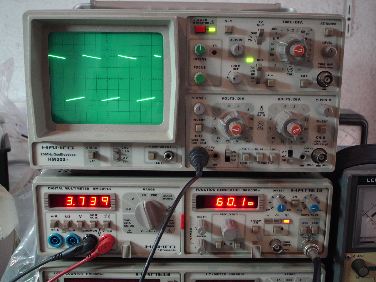

You are going to get tired of taking and attaching so many screen shots. You only need 20,50 or 100Hz square waves at most to show the problem, since all the above shots show the same response, apart from slight clipping on #8.
Do both channels have the same reponse?
Have you checked the PCB, components and wiring at the input stage to be certain it is correct?
There are only a limited number of possibilities for this circuit behaviour and magic is not one them, so please take a proper look and compare with the published schematic.

Look this R2.
C1=4u7/63V
I has try to increace but without result.

I presume you've thoroughly checked the PCB for errors or shorts...
Does the signal change in shape at the junction of C1/R2 when power is applied to the amplifier (for example with a 60Hz squarewave input)?

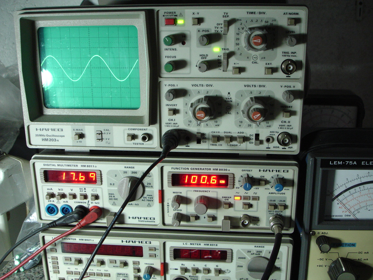

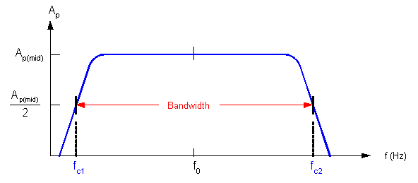

I agreed with AndrewT's analysis of the low-frequency squarewave shape in that the response is rolling-off at low frequencies, seemingly at too high a frequency. However, there is an easy way to identify the -3dB roll-off point to verify if this is normal behaviour:
Using a sine wave input signal at around 2KHz (set the amplitude to well below clipping level), measure the amplifier's output amplitude on your oscilloscope. Then reduce the signal frequency (only) until the output amplitude drops to about 0.71 of it's original value. This will give the -3dB low-frequency point.
