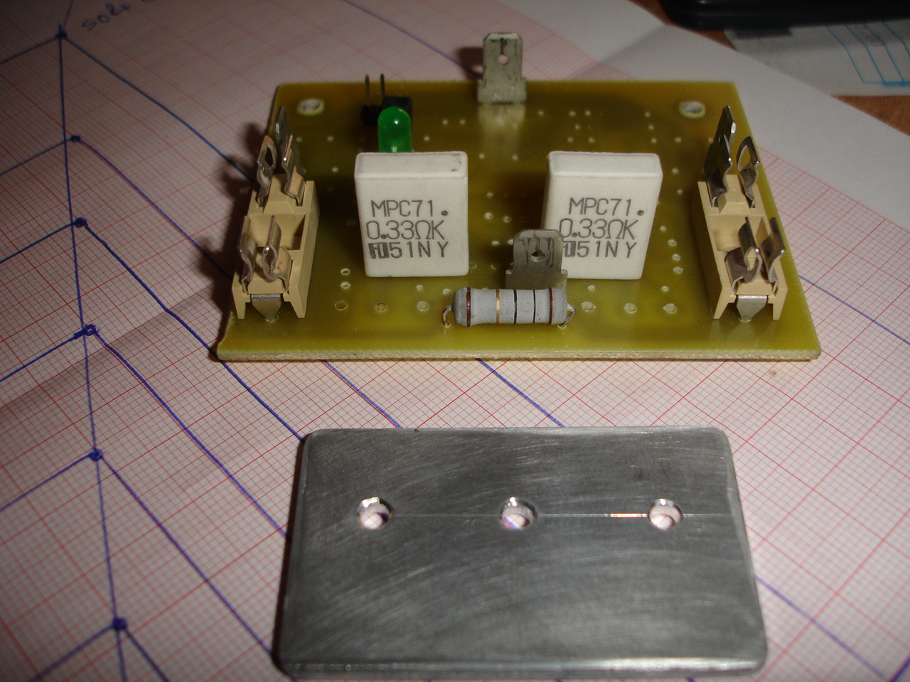

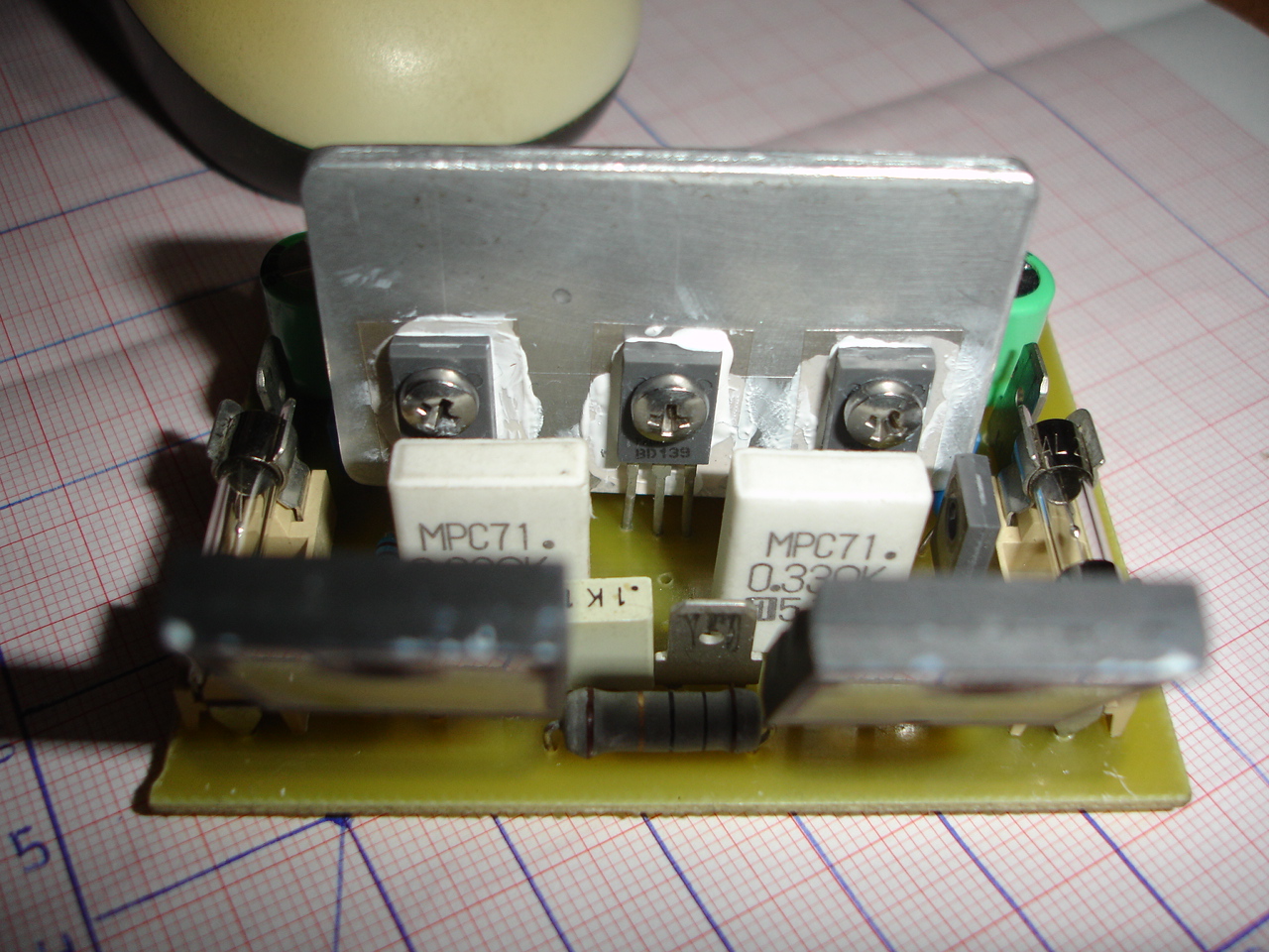

P3A
Now it's time for the second channel.

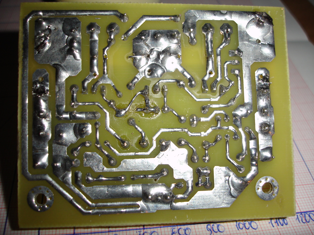

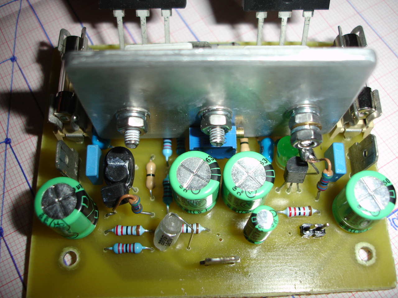

P3A
Second channel ready and tested.
Now it's time i listen this in stereo mode.

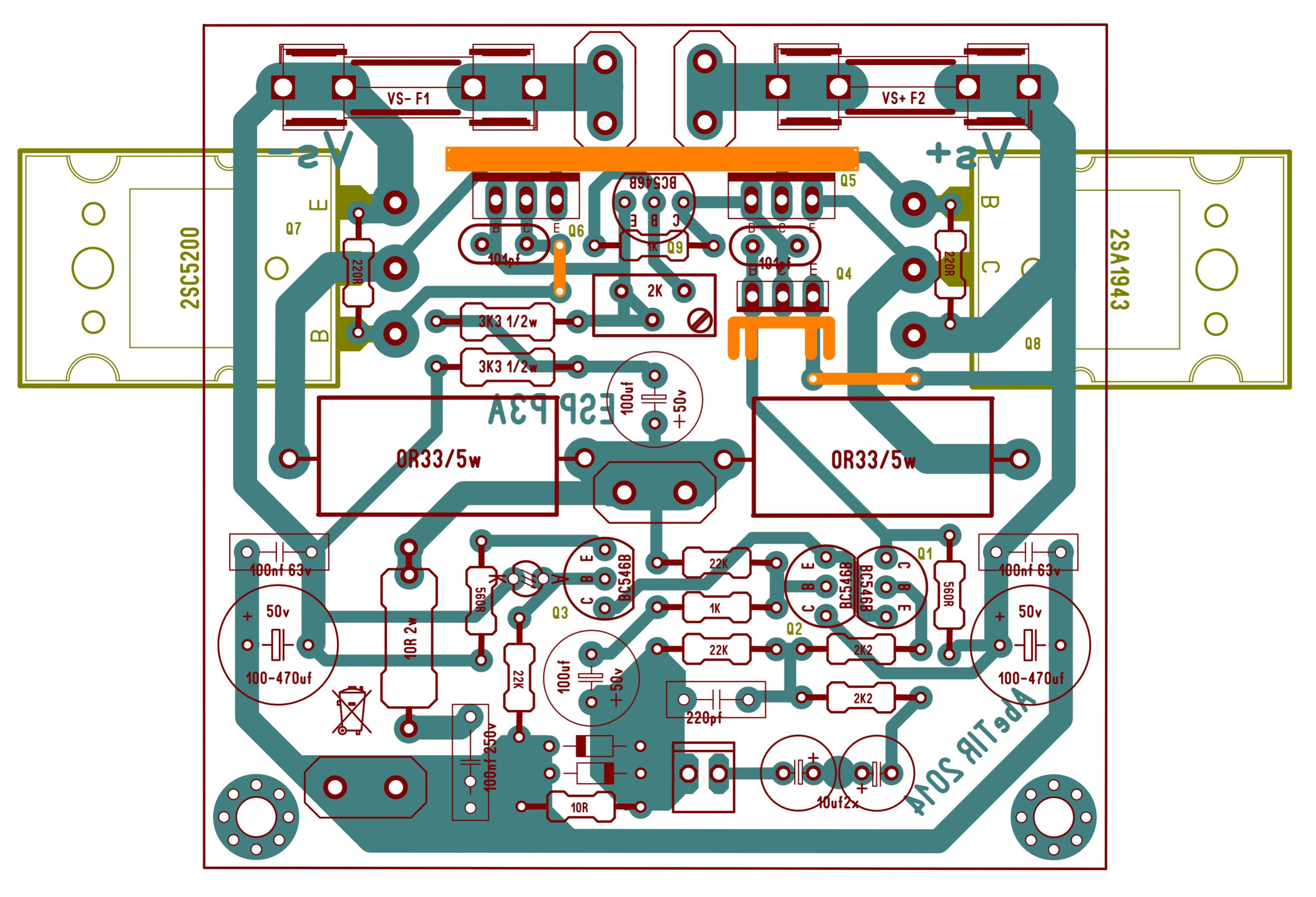

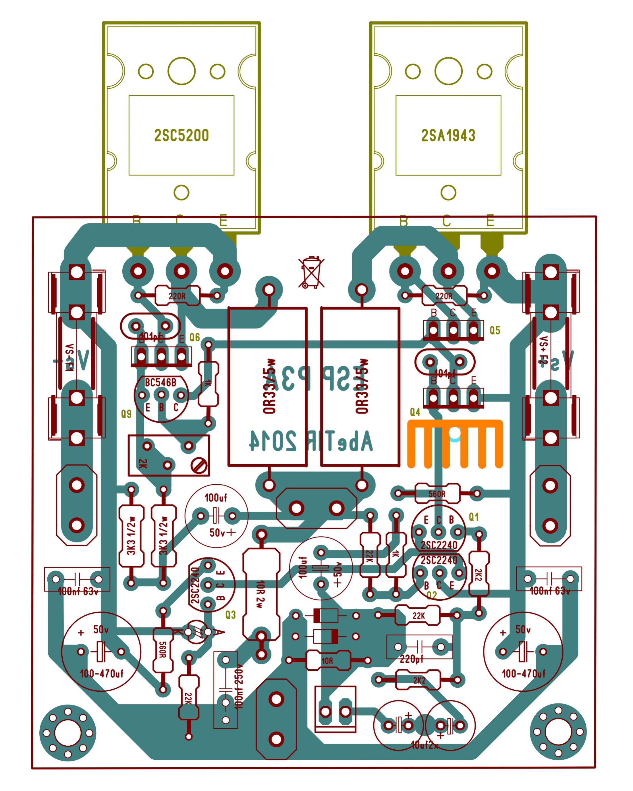

Hi all!
While working with my VSSA amp project, my enthusiasm has brought me to do a revision of my earlier attempts on designing my P3A boards, attached are two of my recent designs, one for BCs and the other for 2S (input diff trannies). Question though, do they look 0K? 🙄🙂
Many thanks!

the vbe transistor is attached to the minus rail driver trannie
so it is - I missed that at first look !
Well I didn't check out if it's all correct, doesn't your pcb layout software do that for you ? - so long as the schematic is correctly entered it should be fine. Just for fun, you could give yourself the option of adding a lead compensation capacitor, a small (e.g. 5pF to 15pF) high quality cap between the VAS collector and the feedback node. In other words, a silva mica (or np0) cap between base of Q5 (or Q6) and the base of Q2. This allows you to reduce the value of C4 (e.g. to 47pF to 68pF) which you may find on listening tests can improve the sound.
Strange that Rod didn't put a cap (e.g. 22uF electrolytic) across the Vbe multiplier, this is usually to be seen.
I didn't build the original P3A but instead made my own version (TGM8) which has some differences but I think the sound you will have from your design will be very nice!
^ I'm using Sprint Layout so no schematic capture function. My earlier builds (different pcb design) had <25dcmv offset, no turn on and off at power on bass was good but I find it a bit too much on the midrange. Thanks, for the lead compensation tip 😎 and yes I've seen a few local builds in my area with an additional small e-cap across the vbe multiplier. I've seen your works on TGM8 it must've sounded really good, the circuit looks sophisticated. :up:
My experience with the original P3A was that VAS transistor gets much warmer than the driver transistor, hence I have provided a small space for a small heatsink to be attached on board.
Many thanks!
Though particular builds and layouts don't have much to do with Sakis' thread, I would like to add some support for the layout on the right. It has the potential improvement of keeping the supply rails and fuses away from the input and low level stages, which is not ideal in the left side example.
Too often, the fuses and rails are the dominant feature of the PCB, taking long paths around the PCB on small amplifiers and this is not good for rail-induced distortion and noise, particularly for a design that has low PSRR to begin with. If I started a small new design, the fuses would be on the power supply board, since on the forum amplifiers I've assembled so far, that makes at least a measurable improvement.
I hope they become useful for you but I'm sure you will work out the layout better than I.
Could I suggest though, that you rearrange the output stage with the emitter resistors above,
rather than below the drivers/VAS. You have a very nice, compact arrangement with great
thermal coupling and short leads for the driver stage there. It would be good to retain that, I think.

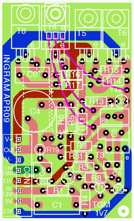

If you really want to re-layout the pcb then you could try something where the power rails are kept close together and close to power ground so that there are only small current loops. This is what I did with my very first layout for TGM and all the small signal circuitry was kept to one side. I didn't know at the time, but I think Rod does this on his P3A pcb too.
http://www.diyaudio.com/forums/newreply.php?do=postreply&t=164756
In my TGM layout I also kept the fuses at the power supply. The colours of the traces help show the idea - the red and blue traces at the top left are the main power rails and they keep fairly close together so that the large currents that flow in them are kept away from the sensitive circuits. The red and blue traces in the lower half are the small signal power rails. The lower right corner has all the small signal circuits in it. The power resistors (Re) are mounted under the board and shown with dotted lines. It's a very compact board (in TGM2 I managed to fit more parts on it!). I don't suggest you follow this method and I prefer the all-in-one board I made for TGM8 with the power supply caps and speaker protection altogether, but it gives you some more ideas to think about.
