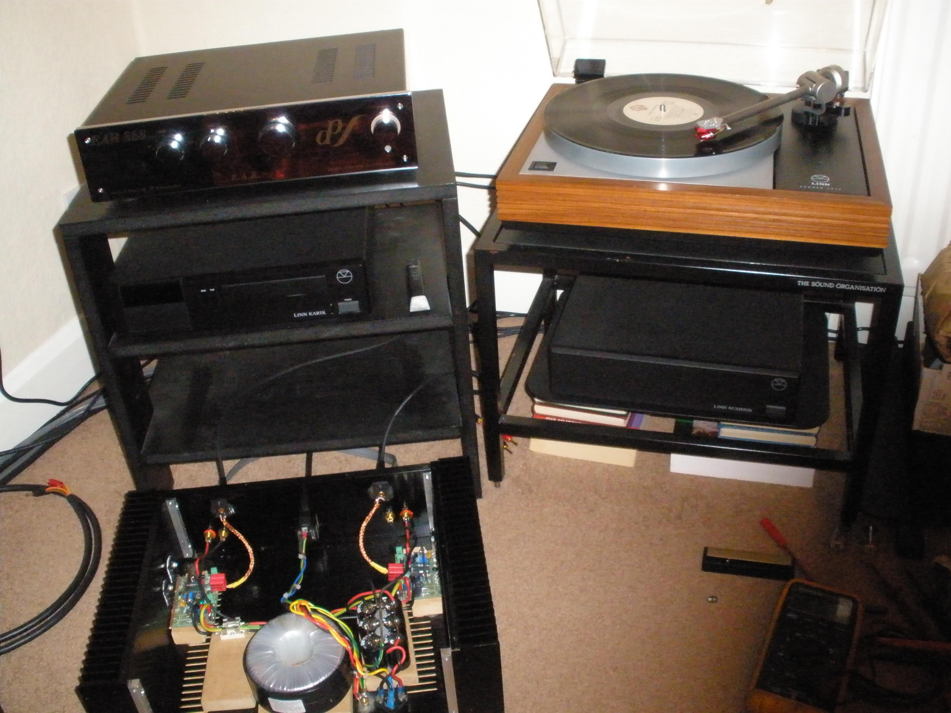

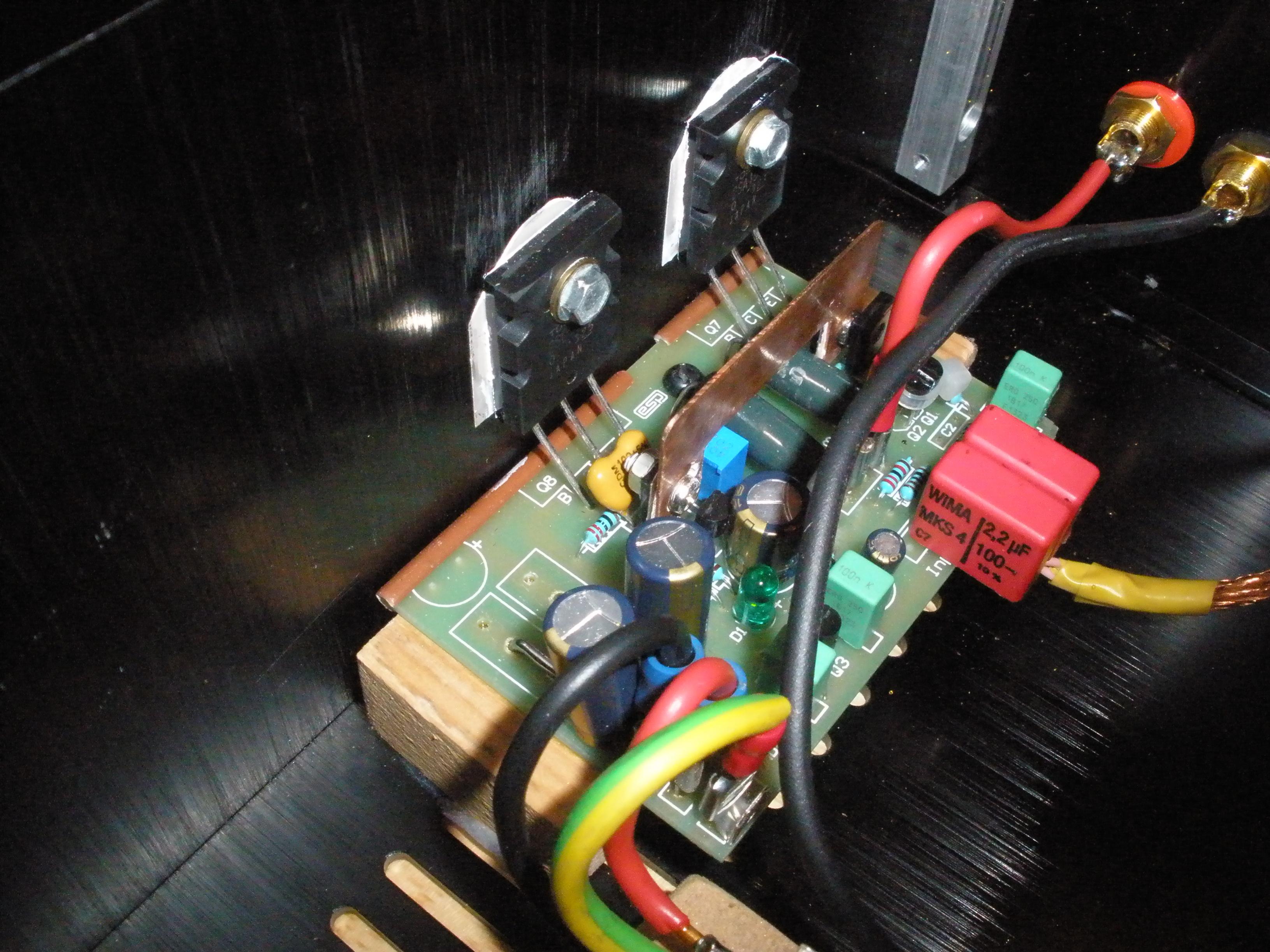

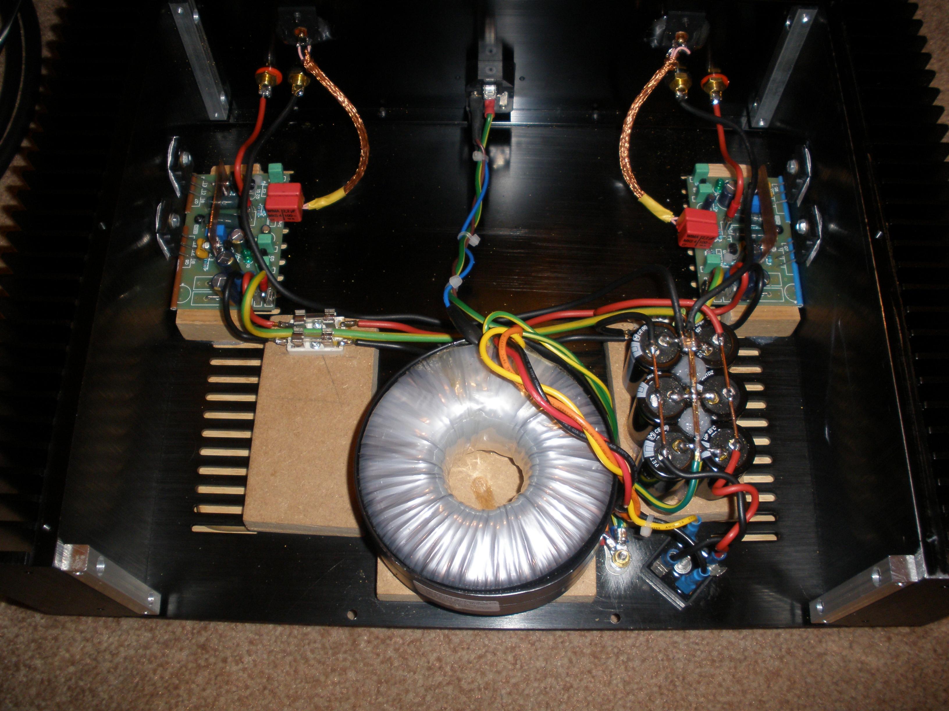

My P3A is working!
I finally finished my P3A last night and had it running ok. I have to say I found the initial switch on to be very nerve wracking. I only had some 18 ohm resistors to put in the fuse holders. - All went well though, nothing got hot and it seemed to check out okay.
I initially set the bias to 18mV giving a bias of about 27mA.
After listening for about half an hour and regularly checking for heat I thought it sounded a little edgy, thin and lacking bass.
I gradually increased the bias whilst checking all the while for heat or smoke and it is now running at about 50mV (75mA), but the amp is still cold, no heat other than the two linked drivers which are slightly warm to the touch.
Does this seem right to you experienced diyers? I was expecting a fair bit of heat from the heat sinks, - but no. Ive even run the amp at moderate levels today whilst home alone and still the thing is stone cold.
Ill do some more listening and biasing tonight and post again later to let you know how it all goes and how I feel about the sound quality, at the moment all I can really say is that it sounds 'OK'.

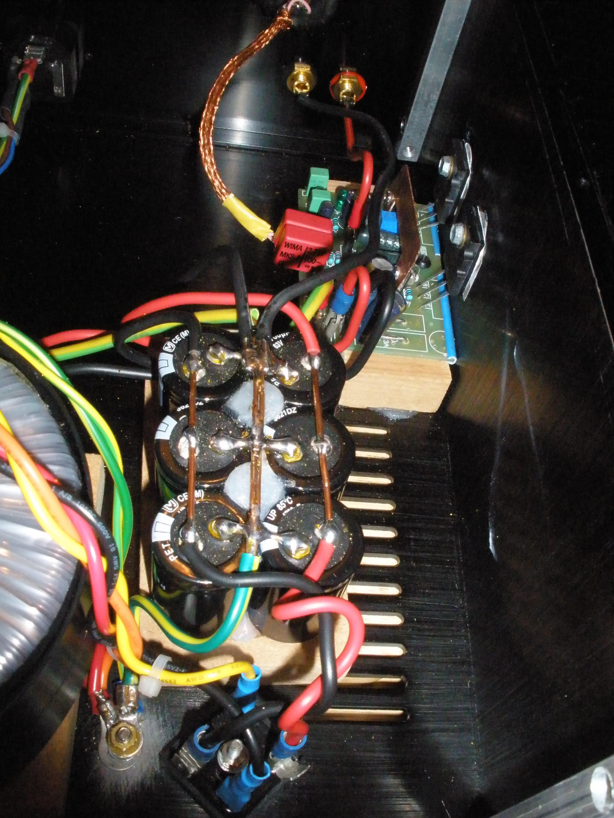

Below are some pictures as it is now. Not the neatest of layouts I know!
The block of MDF to the left of the TX in the first photo is for extra filter caps at a later date.

There is some things that could be done in another way
1) VERY VERY CRITICAL ::: REMOVE THE FUSES !!! from the Dc line these are supposed to be located before the rectifier in the Ac area but better if you remove them totally on mains fuse will be fine .
2) second in case you got your shelf 6 capacitors you may as well get two more and relocate properly the all thing ..that will be
----Trafo and bridge in the middle 4 capacitors per side and symmetrical wiring bypassing them will also be a good thing ..
No bother about temperature with these heatsinks
Really, why ? But there's no fuse holders/fuses on the boards as shown on the original design. Please clarify. Thanks
Jacques
Yeah that statement makes no sense to me either.
If one uses close rated fast blow rail fuses then they need to be placed after the bulk filter caps otherwise the inrush current will cause nuisance blows left right and centre. It is reasonable to have local decoupling caps (say 47u to 1m) after the rail fuses but no more.
But what would I know, East is the expert...![spin :spin: :spin:](https://files.diyaudio.com/forums/images/smilies/spin.gif)
Fuse holder are specified for about 6A rather low
if memory serves properly if one of the rails blow amplifier will latch to the other rail ( never had a P3A amplifier fused like that to know for sure )

I did some more listening, adjusting & listening last night. Other than at a very low bias setting I was not aware of any difference to the SQ. I tried setting it to around 110ma at one point mainly to see if I could get any heat out of it, and it did become very slightly warm so I backed it off again to about 70ma.
There is absolutely no turn on or turn off thump and the offsets are steady around 14mV and 15mv.
Overall, my opinion on the SQ is that has a clean but slightly lean nature. On occasions it sounded a bit 'shouty', especially on female vocals. The biggest let down though was the bass - which didn't seem to be very tuneful - to my ears at least! Treble seemed fine but maybe a little more extension would be good.
Now please! These are only my opinions and I confess that I am no expert on SQ. All I can compare to are my friends systems and my own current system, which uses the power amp section of a NAD 3020A.
At one stage I put the NAD back on, and was immediately aware of its musical but warm, rounded presentation.
So there are some things I like about the P3A, e.g. power, dynamics and it seems to present a better stereo image.
Mr Sakis: The fuses, electrically, they are wired exactly the same as they were on Rodd's PCB's. I moved them off to make room for the 100uF decoupling caps. I'm not sure what you mean about the decoupling and bypass caps either could you explain please.
One thing I'm going to try is replacing the input cables with proper screened cables. Currently its just two wires twisted together with the screen added as an after thought when I read that the amp may oscillate.
Also, I have 6 more caps on order to fit on the left side which will then make it more symmetrical.
Do you think that because the amp will never get warm it will never settle down properly? Is it not said that an amp needs to warm up for a while after being switched on?
Sorry if I've gone on a bit! - I thought this was a smallish project where you build an amp, put it in a case and job done!
