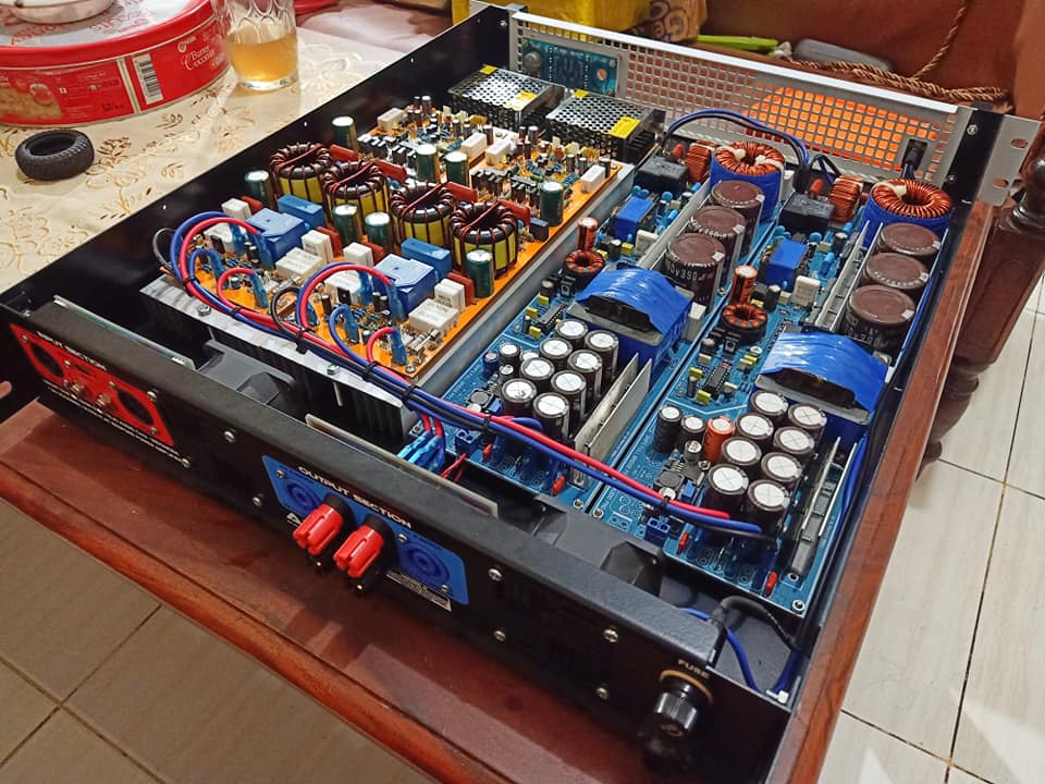

Attachment 2x 2500W RMS Kartino Design
From me, thanks Kartino and WER for teaching and sharing, have learn a lot in the group, no need to buy rubbish PRO amplifier anymore ,...
Several people attacked you here , That's how people dislike it is commonplace and always exists
The whole thing is technically demanding and not Saturday/Sunday plug and play project with one click,
The truth is, Kartino Design Full Bridge can deliver 2500W RMS at 4 OHM continuously GUARANTEED !, which a lot of brands can't.

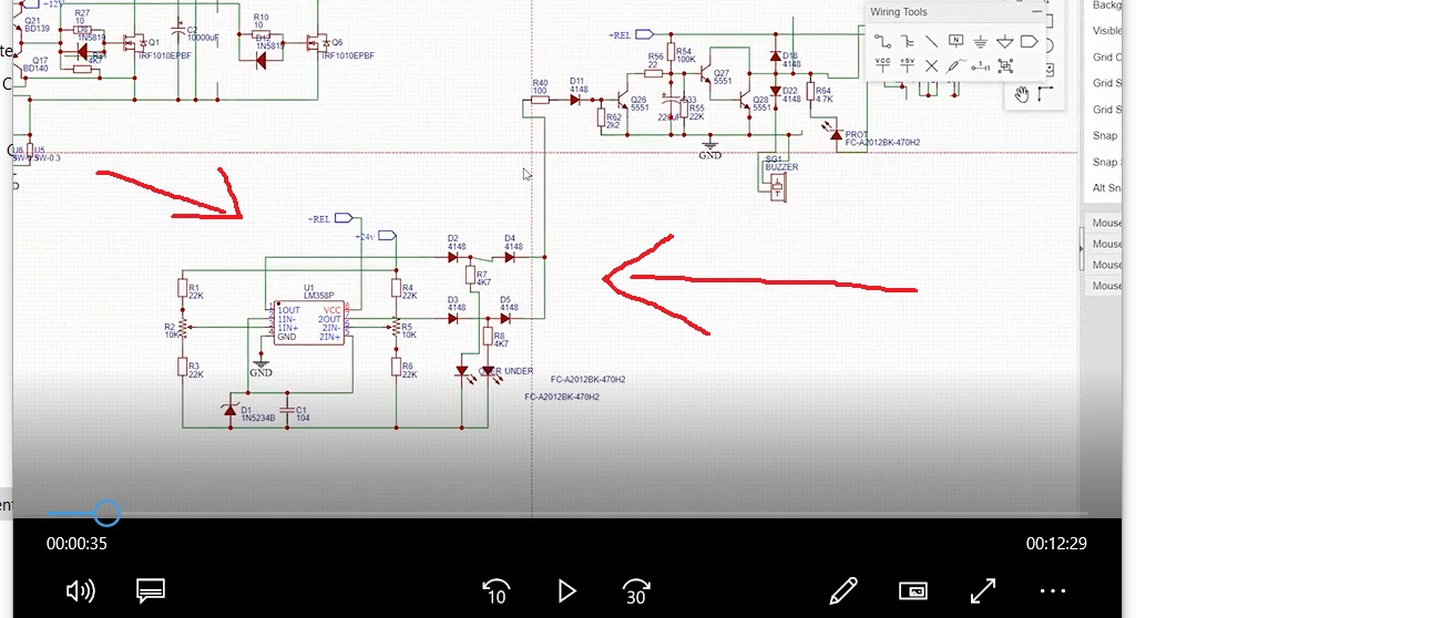

I want to ask you
How about to add in next revision
1.undervoltage < 10V Bias and overvoltage Protection > 100 - 105 VDC in all UCD FB / Pleci Pro ?
I think simple circuit with LM358 and as few semi like WER use in "1224VDC to 220VAC Inverter PSW EGS002 low power frequency transformer"
view picture,..can add and should work.

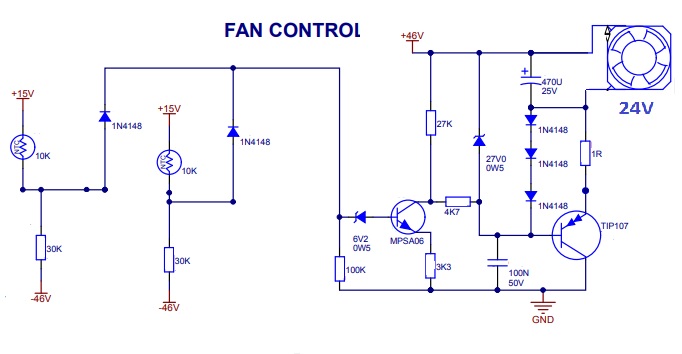

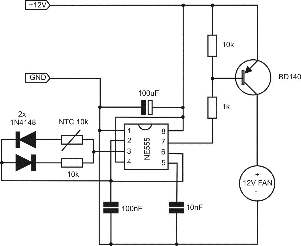

2. Thermal protection about 80 Degress shut off with temperature (PWM) Fan control
- Class D
- PA Discrete Class D Amplifier Schematic
