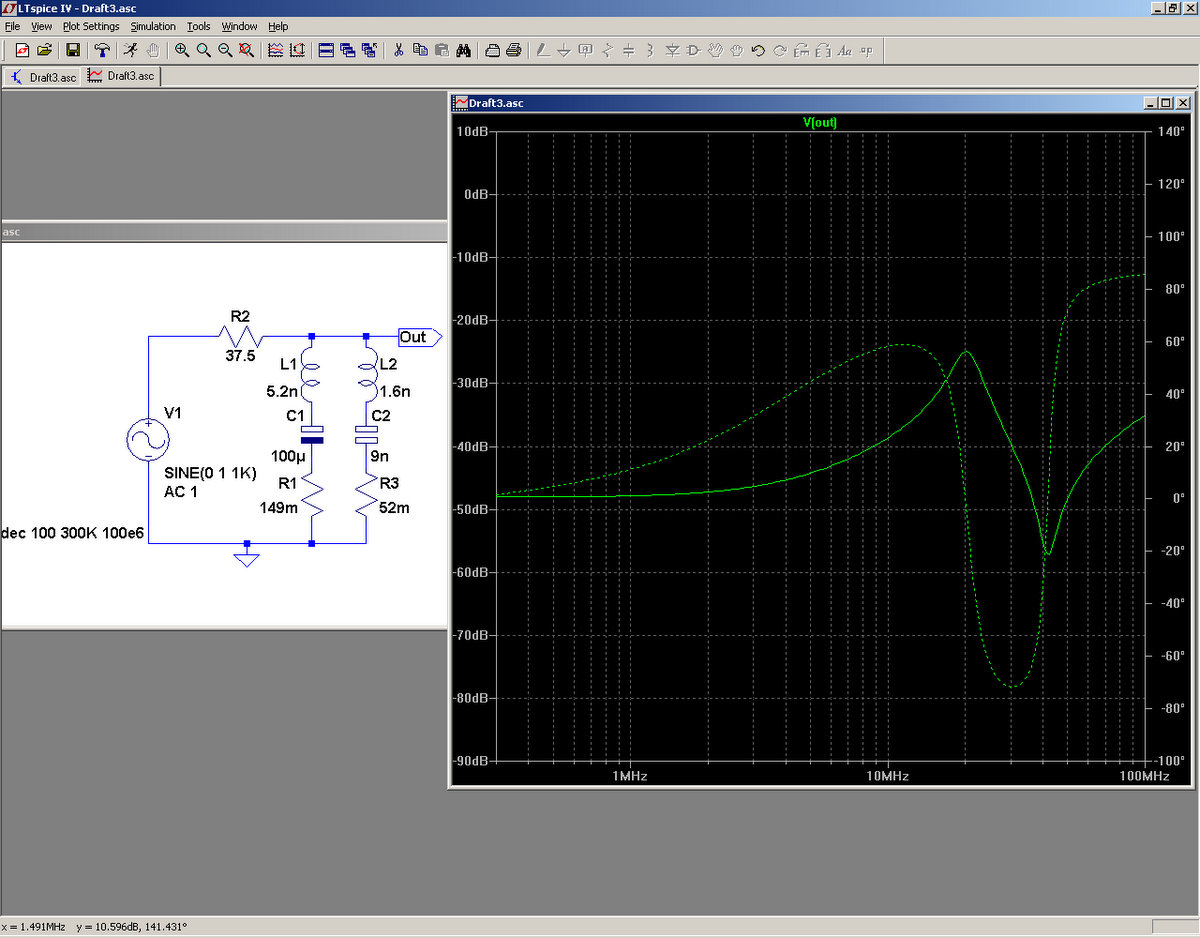

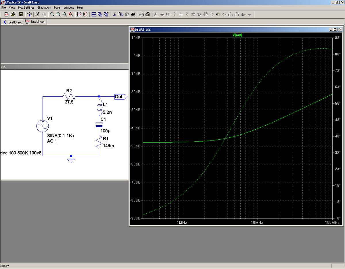

I did some simulations on powersupply with 50hz ac, and it seems like adding those 100k resistors at the electrolytes is a bad idea. Because they constantly draw currents from the electrolytes, and makes more noise in the supply voltage. So i would put the resistors and snubbers before the rectifier or transformer. Putting inductors in the curcuit with simulator made more noise also. Dont know how reliable simulator is, any comments?

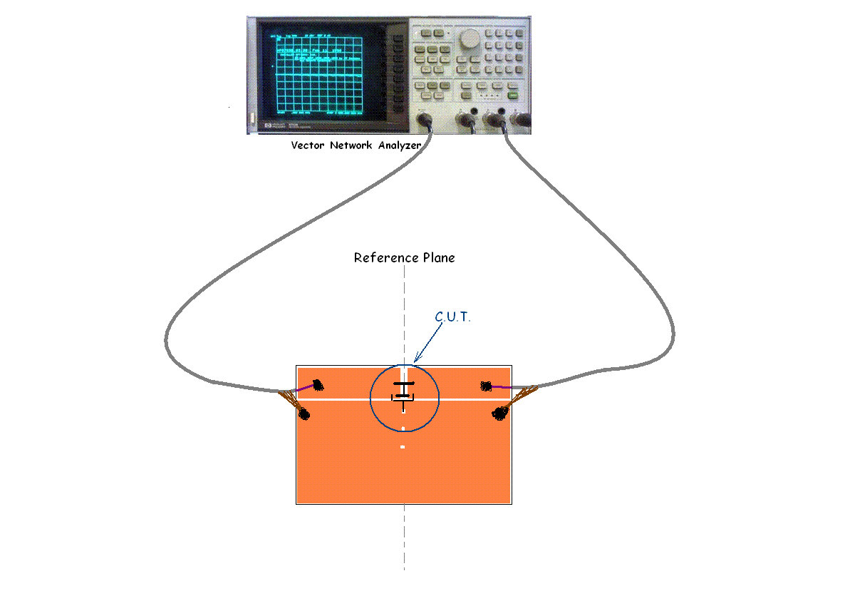

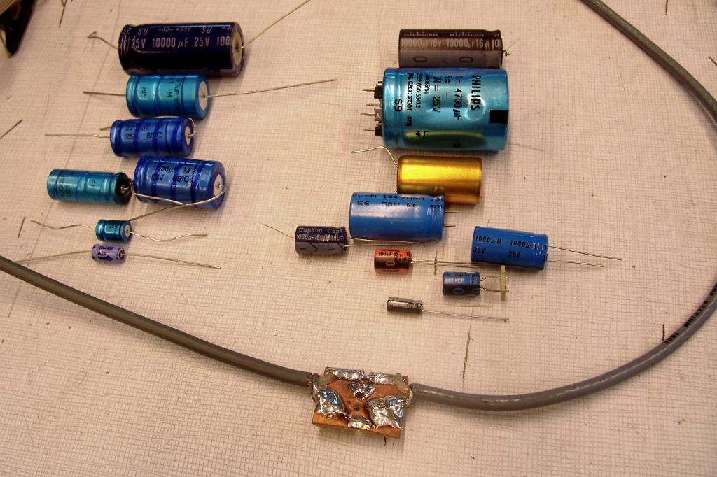

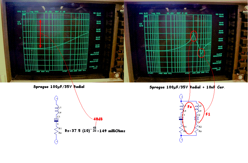

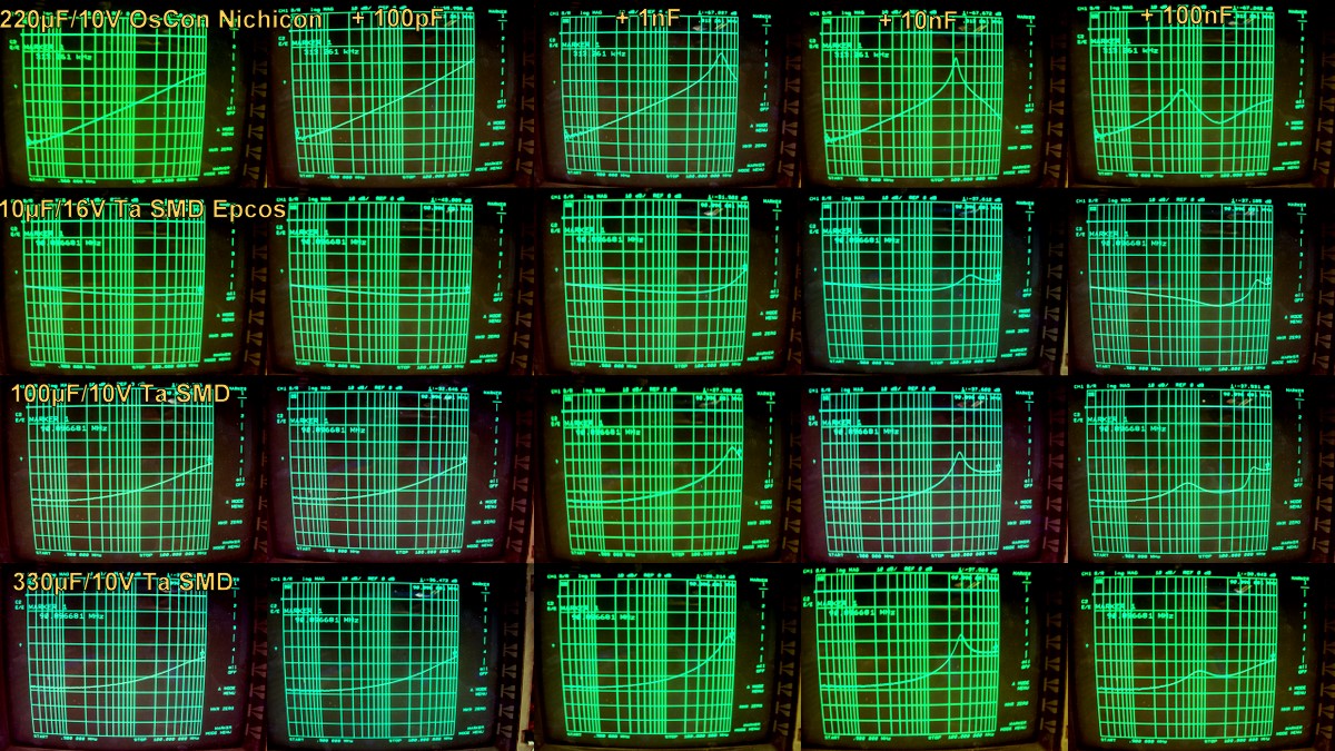

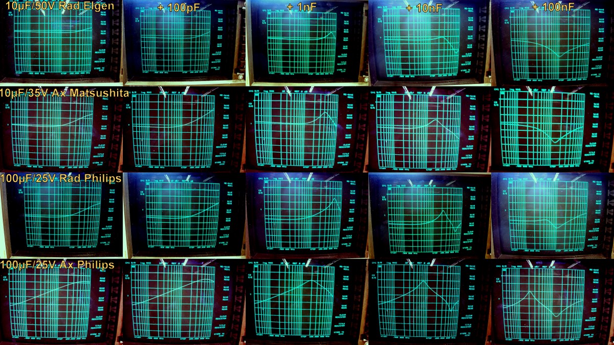

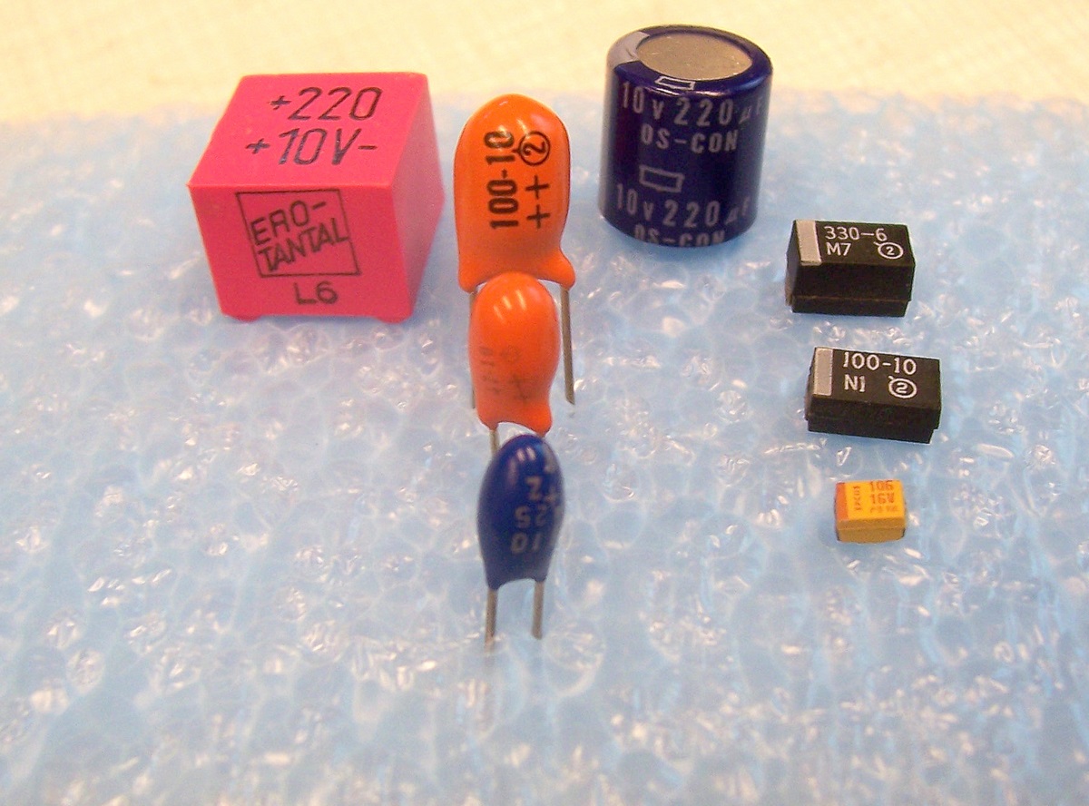

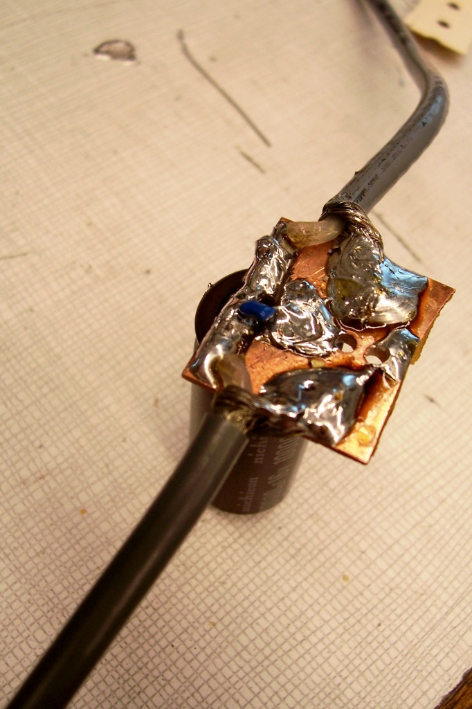

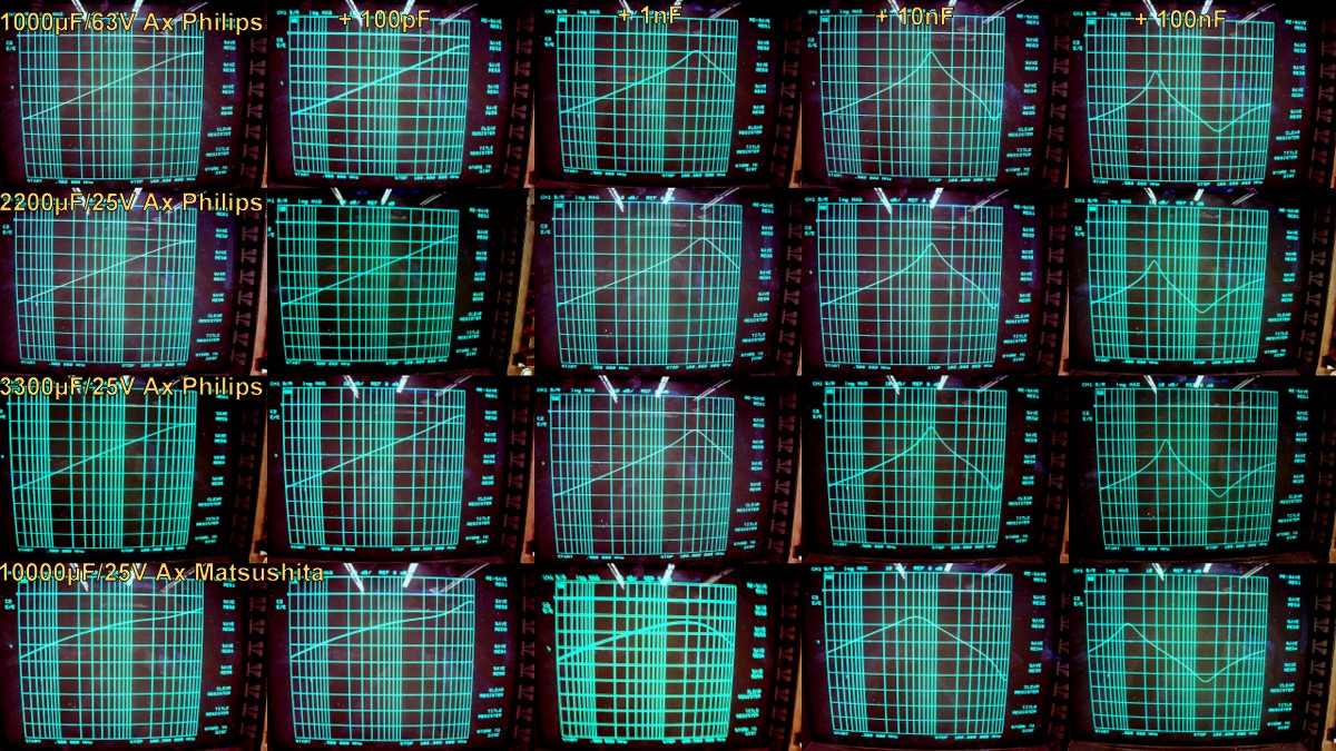

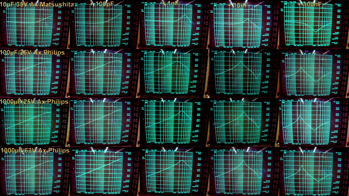

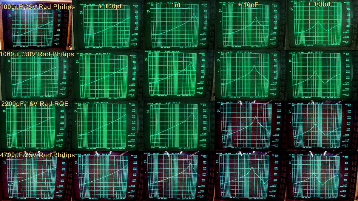

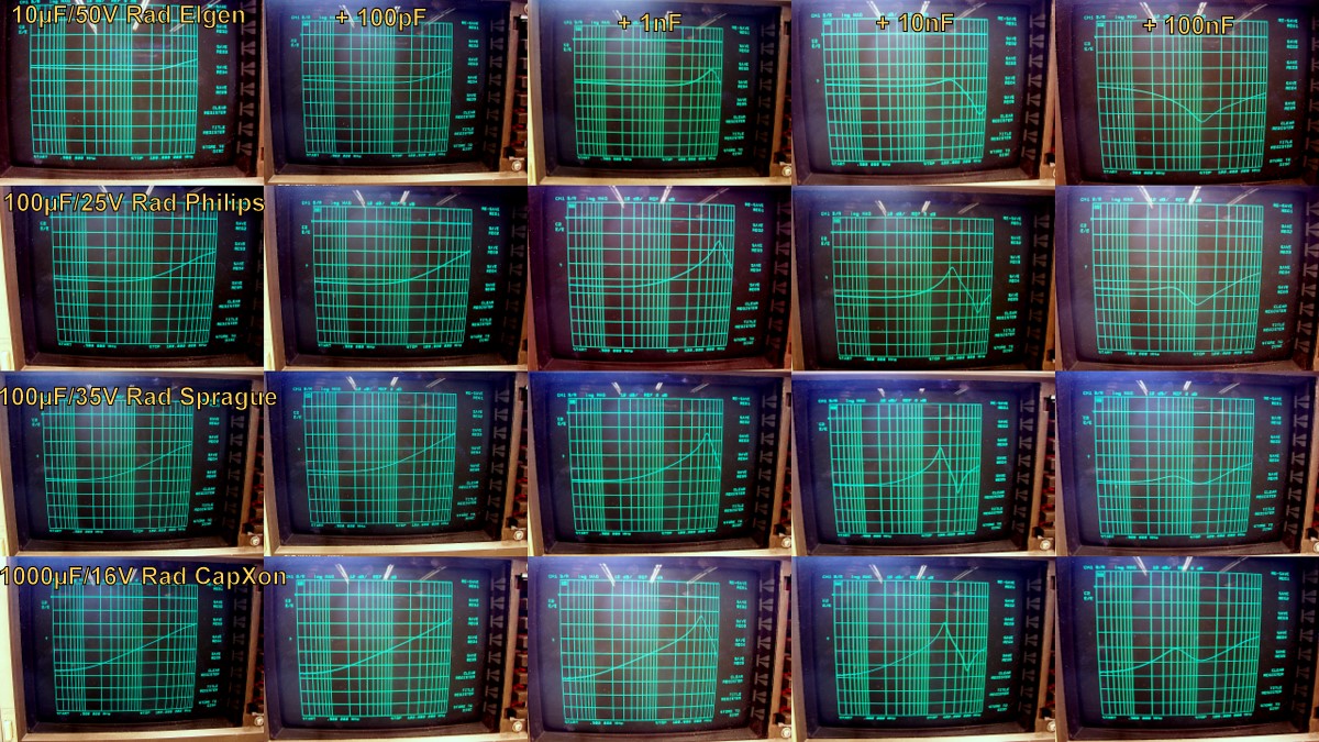

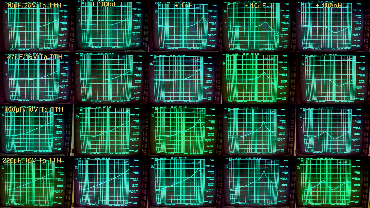

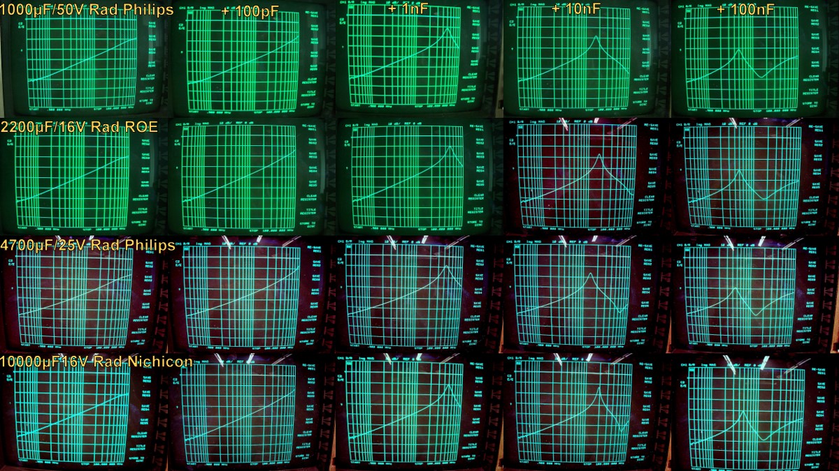

Here are some actual and systematic data on the subject of paralleling a small ceramic cap (100pF - 1nF - 10nF - 100nF) with various types of electrolytics.
These are impedance plots between 0.3 and 100MHz, and in this particular set-up, the 0dB level is equivalent to 37.5 ohm.
A short executive would be: another myth is gone.
Basically, all the serious guys (and gal) in this thread are right.
A complete description of the test set-up and methodology can be found here (in french):

do those results show that there is insufficient damping of the two //cap resonances in the esr inherent in the two caps used for each experiment?
If more damping resistance is required, where should it be placed? In the path of the big electro and/or in the path of the smaller HF bypass?
The subject is not simple, and I remember Eva had given valuable advice about it, in this thread or in another one.do those results show that there is insufficient damping of the two //cap resonances in the esr inherent in the two caps used for each experiment?
But basically, in most case, bypassing directly (locally) the electrolytic is not only useless, but harmful most of the times.
If damping has to be added, it has to be either in series with the small one (0.47R f.e.), or to be a RC network of his own, added to the two paralleled capacitors.

According to this plot, 10uF electrolytic paralleled with 100nF ceramic doesn't look bad at all, could this sort of combination be a more practical bypassing scheme to play with?
It would be interesting to repeat the experiment with much larger value shunt film caps and see whether the behavior is similar. I suspect it is nowhere as extreme, but may in fact sometimes occur in a frequency range where it might be audible.
A very small ceramic cap with its very high Q (low esr/esl) is not the sort of thing I would put in parallel with a large inductor, err electrolytic cap - something with a much lower Q might provide better results and something with an appreciably higher capacitance might decrease ESR slightly at higher frequencies.
IMHO the 100nF plot doesn't look all that good to me, and without a network analyzer it would be hard to tell if you made things worse. Bypassing AL electrolytics directly with ceramics is not good design practice IMHO.

It is good, for basically two reasons: the 10µ is small, and thus has a relatively large internal resistance (the physical one, ohmic, not the ESR which is tanδ expressed in a different form), hence good damping, and the ratio of the large to the small cap is not too large: 100 in this case: that is one of the rules that can be learned from those measurements.According to this plot, 10uF electrolytic paralleled with 100nF ceramic doesn't look bad at all, could this sort of combination be a more practical bypassing scheme to play with?
If the ratio is kept <100, then the effect is globally positive, provided of course good layout practices are respected: long wires, large enclosed areas can ruin any combination.

Elvee said:If the ratio is kept <100, then the effect is globally positive, provided of course good layout practices are respected: long wires, large enclosed areas can ruin any combination.
thanks for that, thats what ive been doing mostly as habit and as a result of previous experience and advice. it makes sense too.
Much more data is available in the original (french) article:How could this thread die after seeing such good empirical data?
Tout ce que vous avez toujours voulu savoir sur les condensateurs de découplage sans oser le demande
to simplify the question, given the 100:1 rule is adhered to, is it still best to avoid additional decoupling capacitors on the load line between the regulator and the load; with only minimum output capacitance and let the local decoupling caps do their job? will additional parallel bypass caps add up with the localised caps to trigger unwanted resonance even given the correct ratio using low inductance parts and routing, or will they actually help?
