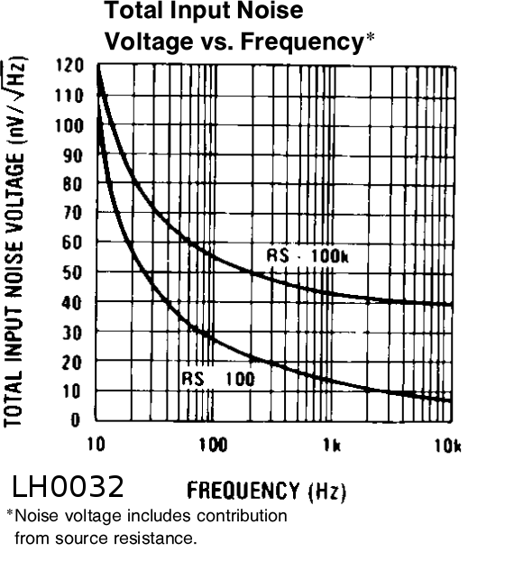

PS, just discovered that I can get easily get the LH0032, does anyone know if the noise is low enough for MM Phono?
From nat-semi datasheet, in case some are still looking

Hi Tvi,
Many thanks. Looks a trifle noisy, but no worse than a good ECC83 and it is possible to build quite decent phono stages (noisewise at least) using these...
So, a much easier Kanata using LH0032 may worth a try...OLG vs. frequency and other stuff looks goo, plus we can tap in before the output stage.

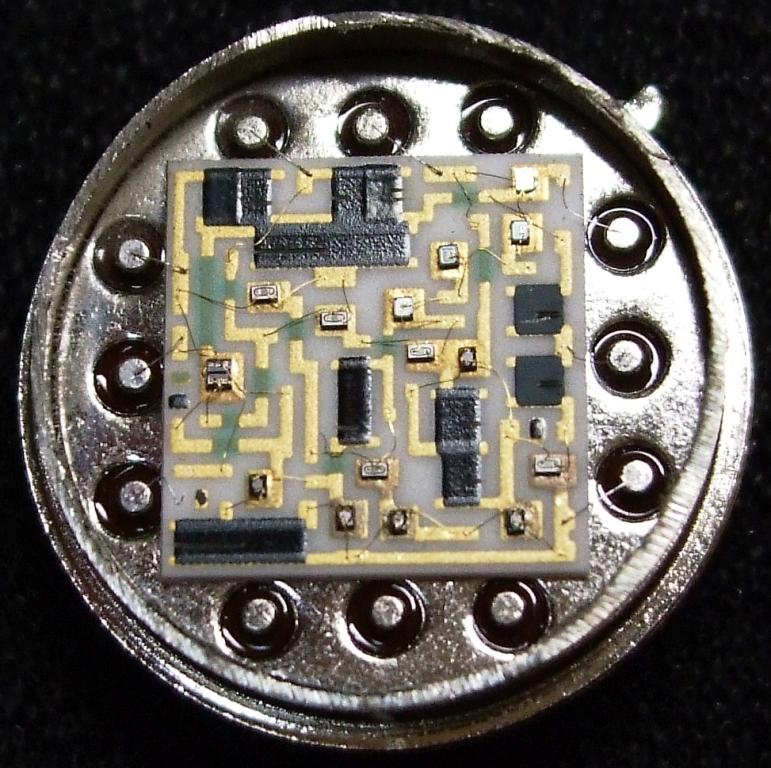

I (kinda) forgot how they made these thickfilm hybrids. That is already beyond SMD, I love it.
I'm not surprised it beats up all the monolithic stuff.
This is basically a nice, latter day Kaneta Pre done is "smaller than SMD". Now I know there are detractors, but the Kaneta stuff I got to hear was pretty good.
Are the later Nat Semi ones Thickfilm or later monolithic ones? I suppose the picture you show is Calogic?

It's a NS
Picture came from here:
(  ̄? ̄)*???: ?????!LH0032
See also:
http://www.diyaudio.com/forums/anal...rch-preamplifier-part-ii-682.html#post2373150
