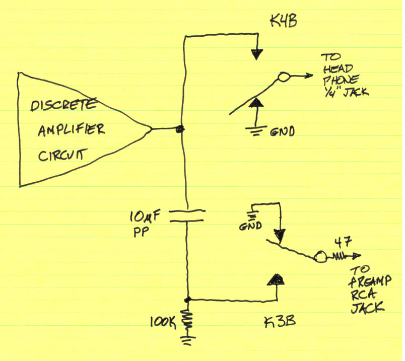

I prefer to short the headphones straight to ground when muting them (relay K4).
I also prefer to guarantee that both plates of the 10 microfarad PP capacitor are never floating. I want them biased to zero volts at all times, no matter which state the preamp-out relay is in (K3).
Something like the attached.
_
Grounding only one side of the headphones doesn't worry me too much as there's nothing to pick up any stray induced voltages.
However, that's not the case with the line-out (if an attached amplifier is on), so it does seem like grounding the other side of the output cap would be a good idea.

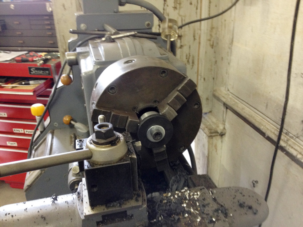

Turning the volume knob insert (I'm using black Richlite -- you get killed on setup charges when anodising one-offs):

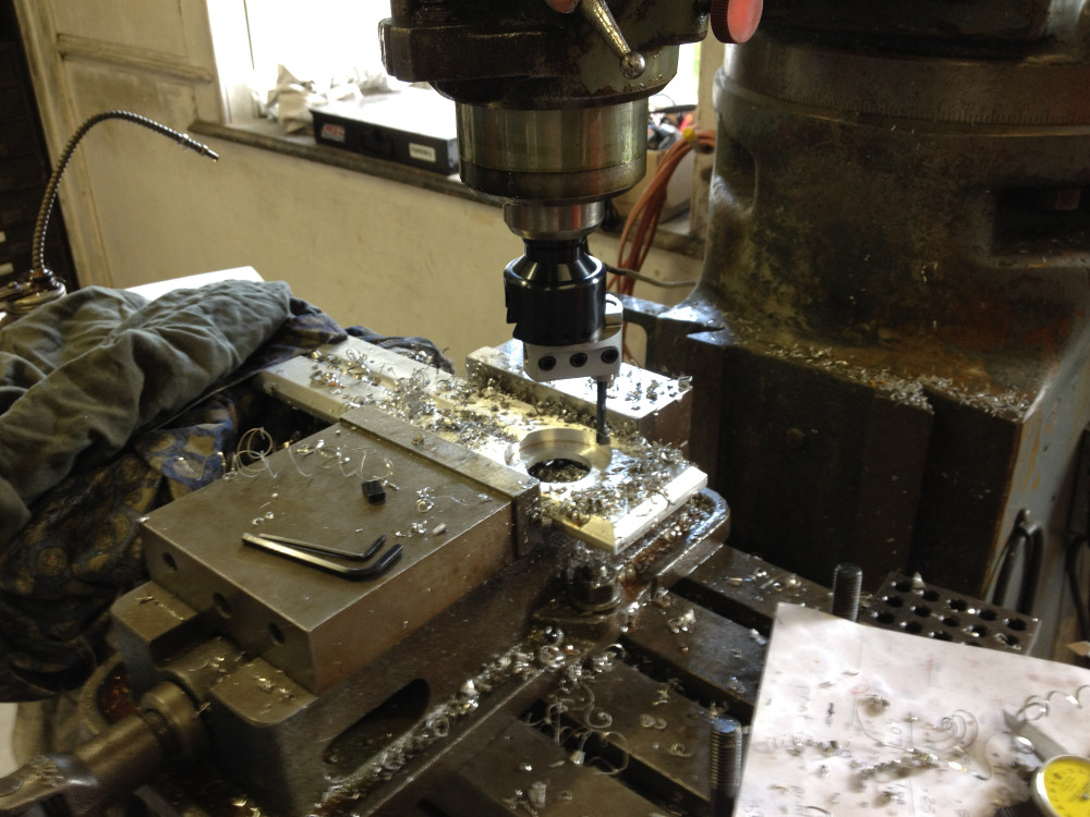

Boring a hole for the insert:

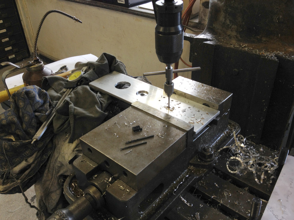

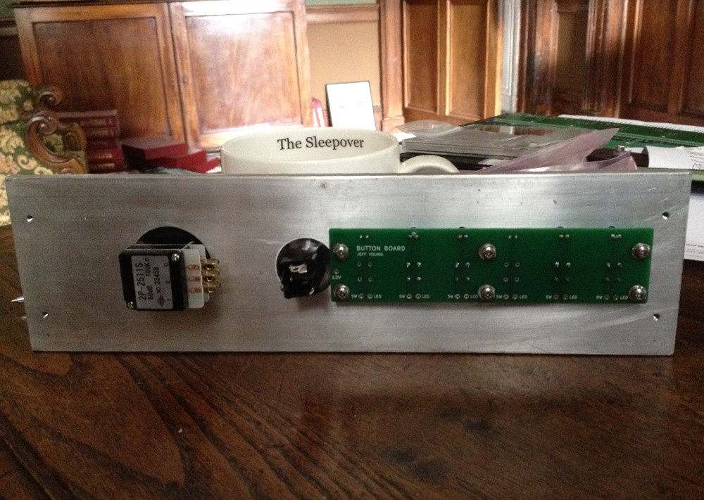

Tapping holes for the button PCB on the back of the faceplate:
