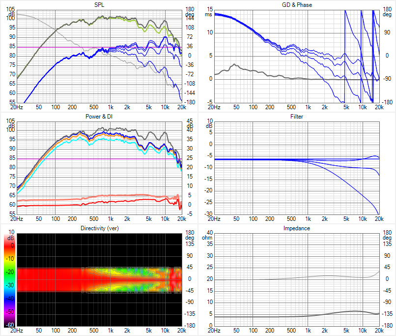

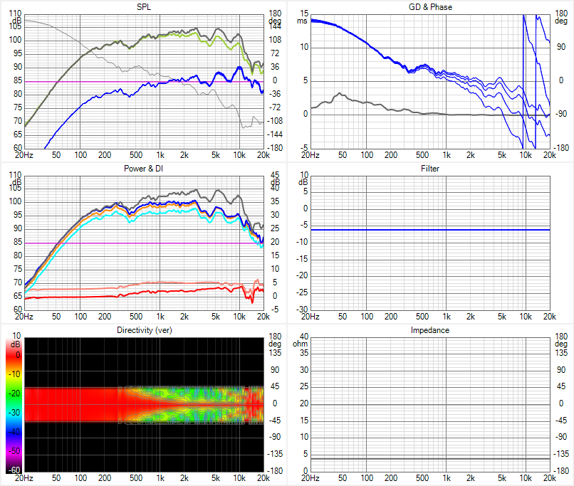

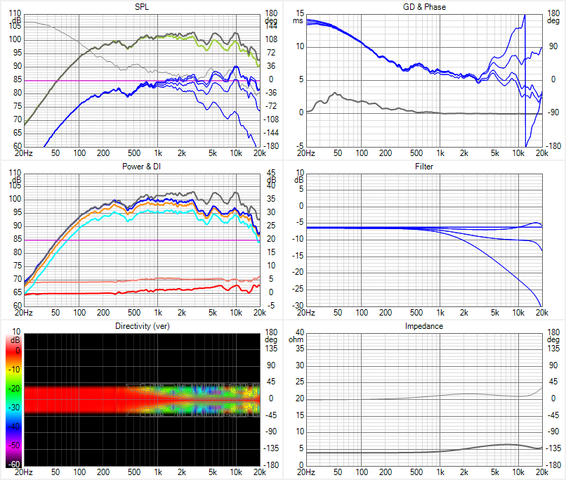

I found this old thread while playing with the idea of short curved arrays. I just put together a quick and dirty simulation of 8 element 3FE22 array (only with 0 and 45 deg measurements) in VituixCAD. Do these results make any sense? First is a flat baffle without the circuit, second is the flat baffle with the circuit and the third one is curved baffle with 1 m radius and the circuit.
