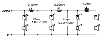

I did some research, and found that the crossover in the speaker that JBL sells is quite a bit different than the crossover in the patent.
This is good news actually! To me, the most obvious way of curving the wavefront is to use DSP or a curved baffle. But if you don't go that route, the most obvious solution is to use a low pass filter to delay the drivers on the top and bottom of the array. Basically you run the center drivers with a full range signal, and then you low pass the outer drivers. The low pass filter introduces a delay. Off the top of my head, a second order low pass will introduce one half wavelength of delay.
For instance, if you need to delay the outside drivers by seventeen centimeters, you could use a second order low pass filter at 1000hz to achieve that delay. (1000hz is thirty four centimeters long, and the second order delay introduces one half wavelength of delay.)
Here's the actual crossover in the loudspeaker. Methinks that's just what they did - note that the four drivers in the center are running full range, while the drivers above and below are progressively delayed via a second order low pass.

![cbt01.jpg](https://lh3.googleusercontent.com/-Tw7HOsVwhMo/VhLT2vp-IAI/AAAAAAAALcw/6BkY16n80Zs/s800-Ic42/cbt01.jpg)
Or at least I THINK that's what's going on
A couple of other random observations about the xover:
1) there are a bunch of jumpers in the xover. I think those are there so that the user can choose the beamwidth. For instance, you could change the wavefront shape by changing the xover point on the drivers. Basically you can *narrow* the beamwidth by moving the xover point UP, and vice versa. That's what the jumpers are there for - they modify the capacitance value in the second order low pass network.
2) The manual mentions that there's a transformer in the circuit. Again, I think this has to do with the switches that set the beamwidth. By using a transformer you can have multiple taps, which would allow for multiple inductance levels for the inductors in the circuit.
Both of these items are ways for JBL to offer the end user a variety of beamwidths, without resorting to the expense of having two crossovers. Basically a clever way of giving the end user the flexibility of a DSP xover without the expense of ten amp channels and DSP channels.

Excellent! Lots of good info in there. You were a year ahead of me
Good news!
It appears that the circuit is remarkably insensitive to driver parameters.
IE, you can pretty much just copy the JBL crossover. Heck, you could probably just BUY the crossover and use it with your drivers.
(Note that the beamwidth of the array will depend on the center-to-center spacing. Therefore, if you used a driver larger than JBLs, the beamwidth would be smaller, and if you used a driver smaller than JBLs, the beamwidth would be wider.)
Kudos to Bill Waslo - his program does indeed model this very well.
Here is the overall frequency response of the array, and of the individual elements. Note that there's very little response shaping here. The real reason for the xover values is...
Delay. This is a delay network. We can see that there's zero delay on the two drivers in the center (in orange), but the drivers flanking the center are delayed more and more and more.
I still have a questionsthough:
The delays appear to be too small. For instance, the outside woofer in the array should be delayed at least fifteen or twenty centimeters. That would correspond to a delay of 441us - 588us.
It's possible that that increasing the impedance would change this.
I copied the values verbatim from JBL's spec sheet, then plugged them into Bill's xover program.

![cbt03.jpg](https://lh3.googleusercontent.com/-afWzswxE3sw/VhNq2pUlgdI/AAAAAAAALdE/uR18TniMkzY/s800-Ic42/cbt03.jpg)
![cbt04.jpg](https://lh3.googleusercontent.com/-PpxpkiuivsU/VhNq2waNLdI/AAAAAAAALdM/bLPhiqMISH4/s800-Ic42/cbt04.jpg)
![cbt05.jpg](https://lh3.googleusercontent.com/-MVMF8LNR3jw/VhNq28929GI/AAAAAAAALdQ/Vsm0tHRsXnA/s800-Ic42/cbt05.jpg)

In your thread you stated the following:
" LC ladder networks create delays at each stage equal to the root of LC product at that stage."
I noticed that when I went from two drivers in series to one driver, the delay didn't change.
This means one of two things:
1) the delay network doesn't care what the impedance of the drivers is
or
2) my sim is off, and I need to simulate the drivers in series as a single element. (IE, instead of simulating two drivers in series, I create a single driver in the crossover model with parameters identical to two drivers in series.)
The delays are
a) Not sufficient
b) Not constant across frequency
This will result in quite a lot of deviation from CBT theory. This means that the speaker will have a different spectral balance when near and far.
However, for home listening situations where the distance from speaker to listener does not change much and given that the ear is forgiving in the vertical plane means, it may still work quite nicely.

OK, I think I figured it out. Please read my earlier posts from today with a grain of salt; it took me a little while to figure out what the heck they were doing.
IMHO, here is what's going on:
1) A low pass crossover filter will add delay. The amount of delay depends on the order. For instance, a 2nd order low pass will add one half wavelength of delay at the crossover point. IE, if you used a 2nd order low pass xover of 1000hz, you'd get 17cm of delay at 1000hz.
2) As you go higher in order, the delay gets longer and longer. 4th order has double the delay of 2nd order.
The thing about the JBL design that had me stumbed was that the values were very small, and the delays were small too.
But I figured it out!
The reason that the values are small is that the xover point is very high. Something like 16khz.
The reason that the delays are small is because they're not curving the array very much. Just ten degrees.
What they're doing is that they've put a 16khz low pass on each section of woofers. The key is that the ORDER goes higher and higher as you get further and further from the center:
Now, the obvious question, why didn't they use more delay?
The answer is simple - if they used more delay they'd have to move the xover point down from 16000hz. IE, the more you curve the array, the lower the xover point has to be, at least with this topology.
![419778d1400690582-straight-line-cbt-array-cbt-40.jpg](https://www.diyaudio.com/forums/attachments/multi-way/419778d1400690582-straight-line-cbt-array-cbt-40.jpg)
- the center woofers have no delay and no xover whatsoever
- the woofers above and below the center have a 2nd order low pass at 16khz (one half wavelength of delay, or 0.42")
- the woofers above and below that have a 4th order low pass at 16khz (one full wavelength of delay, or 0.84")
- the top and bottom woofers have a 5th order low pass at 16khz (1.25 wavelengths, or 1.05")
The delays are
a) Not sufficient
Looks like it's ok. The very small delay is because there's very little curvature.
The variance in delay probably isn't a huge deal, because there's so little delay to begin with. (IE, who cares if your delay is .5" instead of 0.75" at 500hz?)
