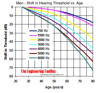

Its sobering to see how early (40 years young) and how low (6kHz) higher frequency hearing is lost:

even if this curves are without Flecher loudness corection they seems way off what I have measured over diferent individuals trought years its normal for 40year old man hear 6khz -5db , 10khz -17db (referenced to 1khz). however noth much can be heard after 15khz ,unless 15-17khz @100db level.
