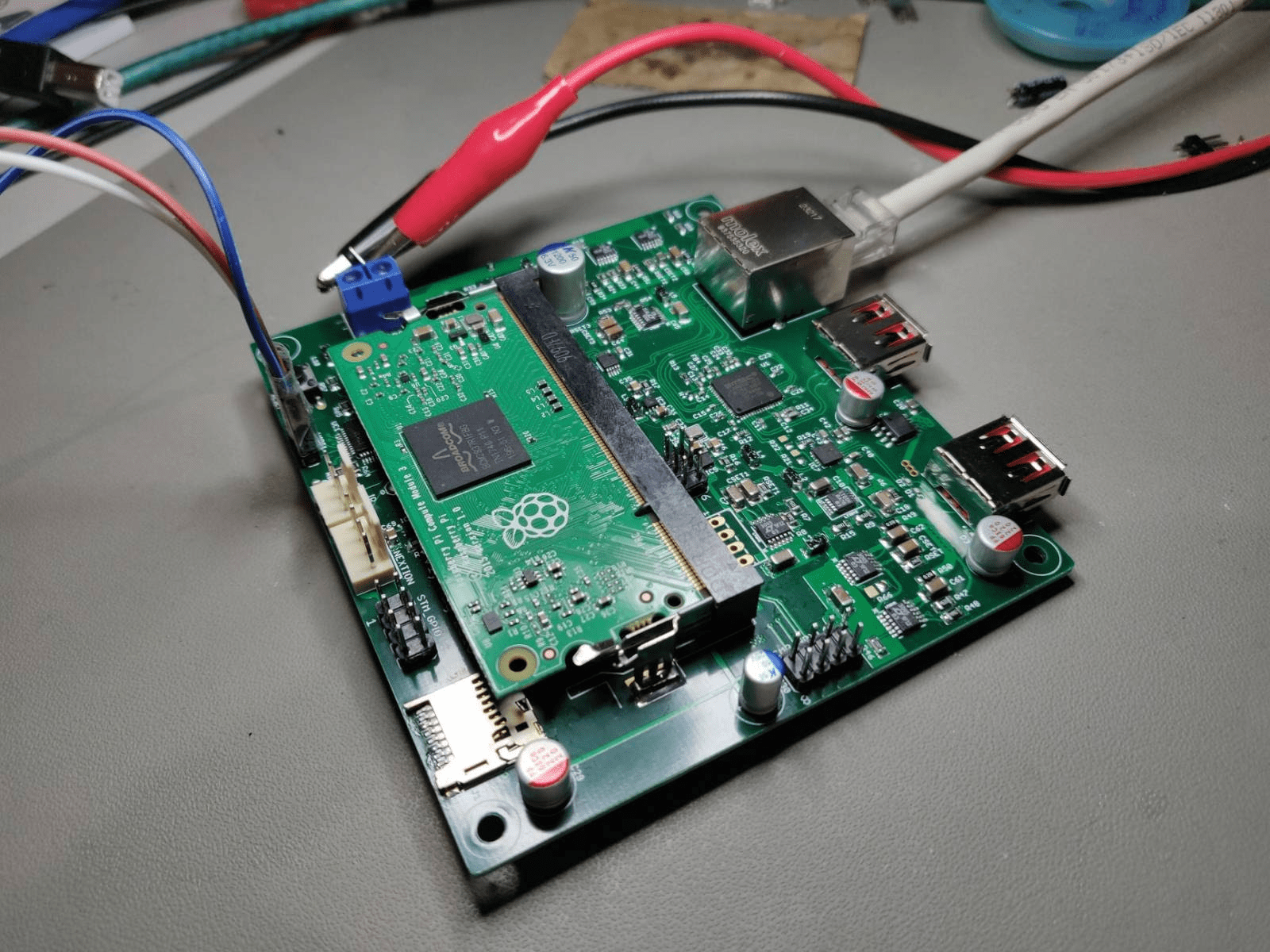

Some time ago I designed my own motherboard for the CM3 module. I used components that were already well supported by the RPi community, since they were used on the RPi3. But I paid a lot of attention to the on-board power supplies. Only top-shelf, ultra low noise components.
The end result was 100% software compatible with the RPi3 and sounded considerably better than a 10K commercial network streamer that happened to pass by my house.
I would call that a good investment of time and relatively little money. Total cost for the board with components was ~200€.
Only problem is, all of its components are SMD, plus a lot of them are of size 0402. Not a problem for me, but big problem for most DIYers.
So this is definitely doable, even though it's not for everyone. The only problem these days is that CM3s are in extremely short supply, pretty much only available on the gray market at extraordinary prices. But the supply situation is bound to improve as time passes.

Kudos for the nice looking board!Some time ago I designed my own motherboard for the CM3 module. I used components that were already well supported by the RPi community, since they were used on the RPi3. But I paid a lot of attention to the on-board power supplies. Only top-shelf, ultra low noise components.
would it be possible to adapt it for CM4 modules? those are also unobtanium, but are possible to order.
also this would be perfect streamer, that providing all RPI 4b can provide, with good clocks and LDO regs.
maybe you can arrange GB to check people's interest; boards could be SMD presoldered by local company and TH elements to solder by DIYers ?
In my experience with these SoCs less is more. You don't need the greatest performance - you need a dead quiet system, that is powerful enough for the task at hand.
I remember when the RPi 4 first came out I did a comparison between that and the RPi 3. Both boards were running the same software (or at least as close as I could get them..) and had the same power supply.
The RPi 3 sounded a little bit better / cleaner.
So I could do a CM4 variant, but it may in fact sound worse than the one that I currently use.
Plus there is the issue of powering the CM4.. I believe that it has on-board a number of switching mode power supplies, that can not be bypassed without some serious microsurgery (if at all).
The CM3 only has one SMPS on-board, for the Vcore. The rest of the power supplies can be powered by off board linear LDO regulators.
Regarding a GB, it may be a possibility. But it doesn't make sense right now since the CM3s are unobtanium.
