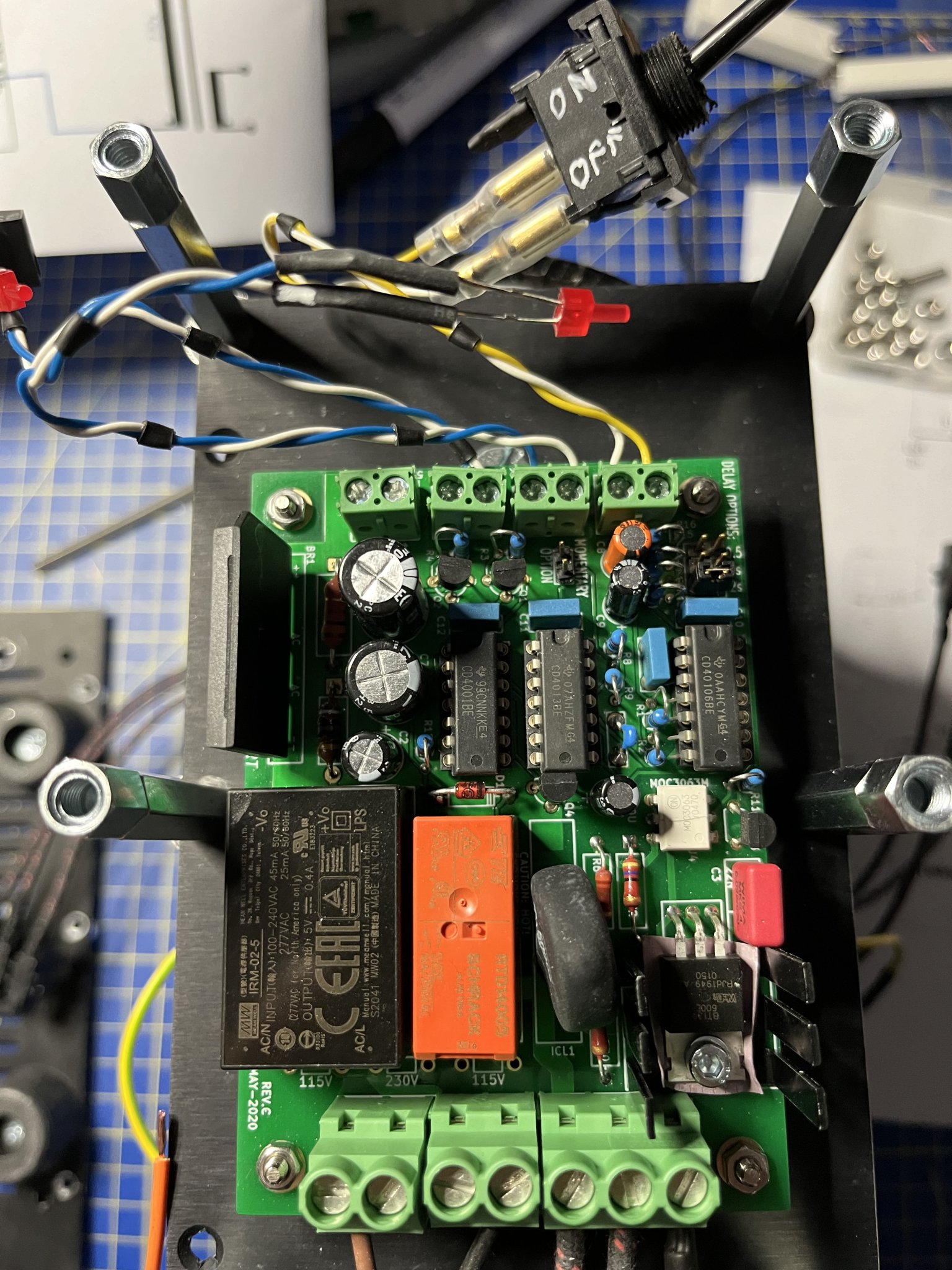

Hm. Houston I have a problem…
So I finally got my parts torgether, tightly built or prepared to be and mechanically tested, and so I started to power up the various stages, beginning with H9KPXG…
It seems to partially work, that is, there‘s no delay, the light-bulb-test is not satisfying:
When the rear switch is closed, the bulb immediately goes on, the ON-led is glowing.
Opening the front-switch (which should enable soft-turn-off) nothing changes: light-bulb and ON-led are on.
Opening the rear switch of course turns it off, and a nice and distictive relay-click is audible.
H9KPXG is configured for 240V (P1D-P2N, no jumpers, jumper at 2“ delay, no jumper at P6 („momentary option“)…
Anything plugged wrongly or a problem buried deeper?

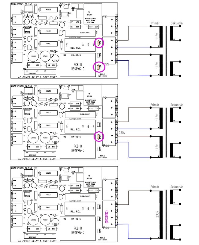

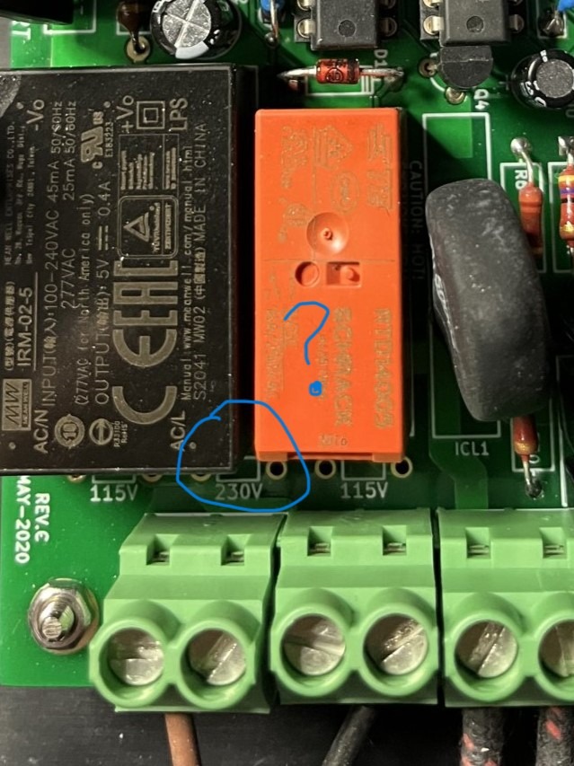

Thank you @ItsAllInMyHead !
The sketches for the primary configuration (way back in the thread) for single primary says so:
P1D-P2N no jumper
(A dual primary would use P1 and P2 D/N and the jumper at 230…)
And the lightbulb goes on and nothing smokes…

I would close the 'back-switch' while the 'front-switch' is in the off position.[...]

It wont matter while using a momentary switch. But sins a toggle switch doesn't produce a positive going edge while switching it off, the D-flip flop has to be disengaged by pulling P6. R9 now becomes the data path and the circuit will, with some delay, follow the state of the toggle switch.I'm confident I tried this too, but will of course give it another shot...
After that, I might try a different switch just to see what happens...

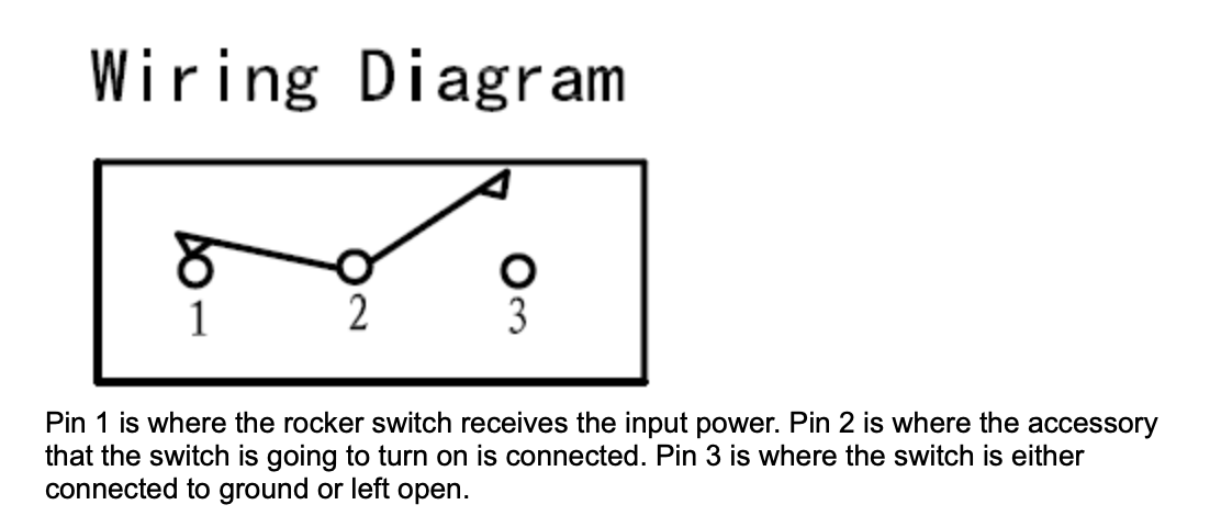

Are you sure that your switch is working correctly? Are you sure it is wired correctly? In looking at your photo I would think that the on position would have a connection to the top pin on the switch - which seems to have some heat shrink on it. In any case, do double check that switch with a meter!

I did check the switch with dmm before installing it. it's either open or closed, according to the marking on the connected pins. I'd be using it according to this attached sketch... ( http://www.learningaboutelectronics.com/Articles/SPST-rocker-switch-wiring.php )
