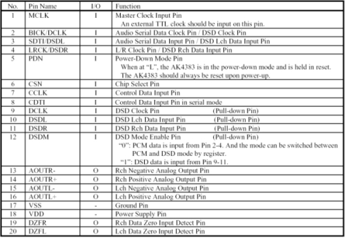

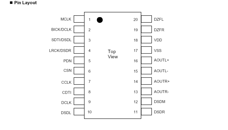

Do you think this stacking would work as well with a more modern DAC with voltage out?
See:
http://www.diyaudio.com/forums/showthread.php?s=&threadid=52449&perpage=10&pagenumber=2
I am so pleased with the sound now.
Its an akm4383 DAC.
I would try a 2-4k matched resis. on each v output?
Then connect all the other pins together?
What do you think?

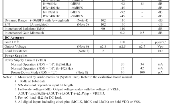

What do you think about stacking a DAC like akm with diff. voltage out?
There is an effect in making DELTA SIGMA DAC parallel.
The voltage output can be easily summing up by the resistance.
if 4 paralling up voltage output DA chips
load-resistance in 1/4 of the specified value
To protect, it makes a low-resistance (47ohms to 100ohms)series in each DAC chips.
summing point is a load-resistance
a loss by the resistance but the effect which depends in parallel exceeds.

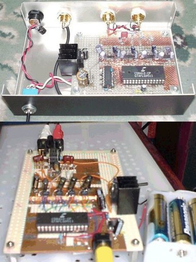

it's my latest project, 4paralled CS4340 with resistance summing up
and 4paralled CS4331 test head

See the AD1852 datasheet. Fig.28 shows how to sum parallel voltage outputs.
ljordan said:fumihiko:
Lewis
inverted summing application,it's best solution.
but need dual power supply

OK, tried the mod (using Rudi's method of using an adaptor)and have had it running for a couple of days now.
Initial impressions are of:
More detail, especially very low level stuff like the sound of a singer's dry lips parting at the start of her singing or the sound of other band members preparing to play (the double bass being moved etc) or a myriad other little details. Basically, this info was below the systems noise floor before. So maybe there is some truth in the square-root of 2 enhancement...
More layering-It has become easier to follow different layers-seperated yet integrated with the whole.
More depth and staging.
The big issue here is that the volume virtually doubles and one has to try to adjust for that in order to perofrm meaningful A-B comparisons.
Not sure about using 3-maybe someone else can post their experiences with more DAC's?
FWIW,
Ryan
