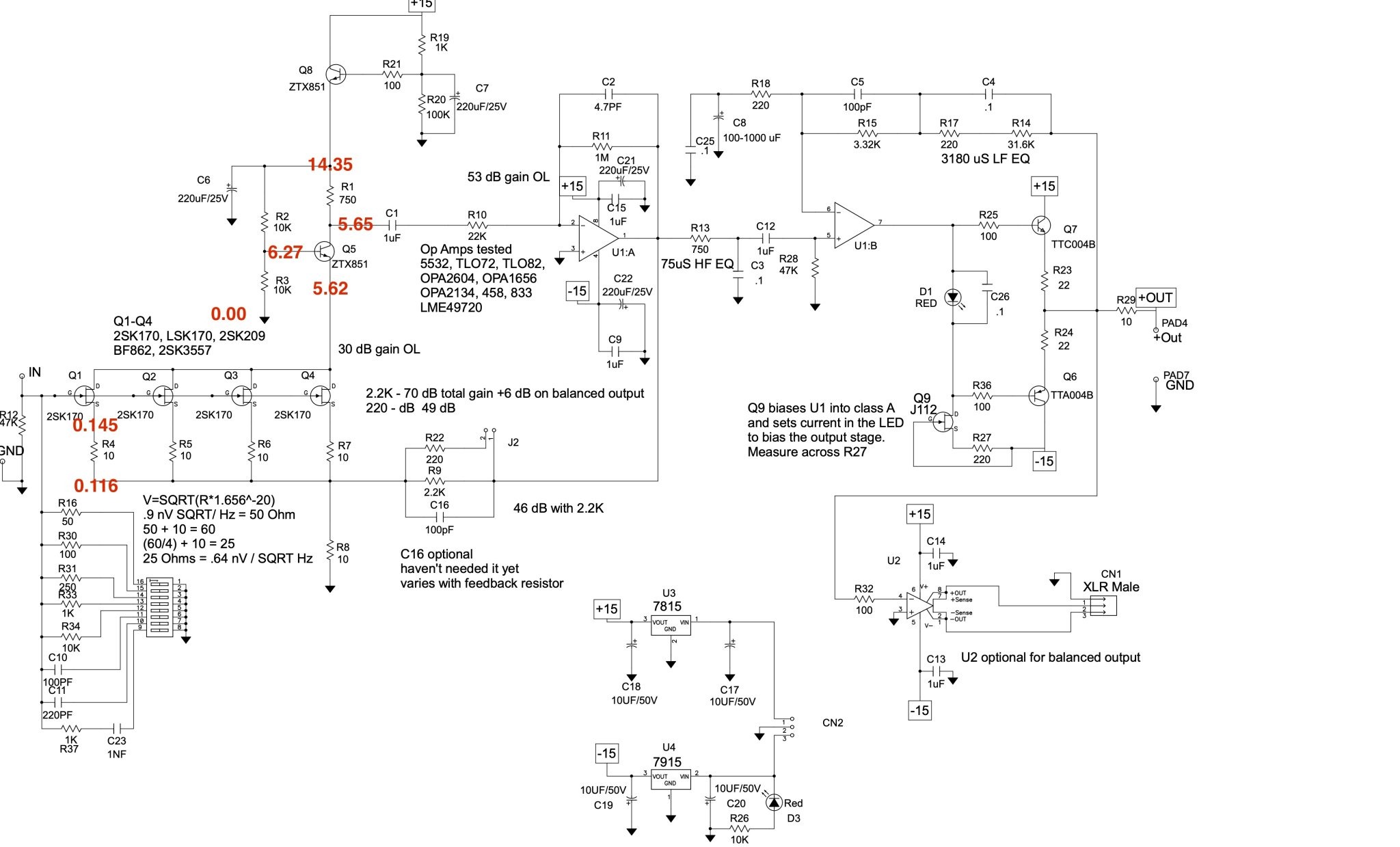

Has anybody measured Q5 Vce when schematic from post #1 is used and R1 has about 9V voltage drop?
ZTX851 has if Ic is below 0.1A typical 10mV Vce (sat) (max. 50 mv). So if Vce is like 100mV it is not saturated?

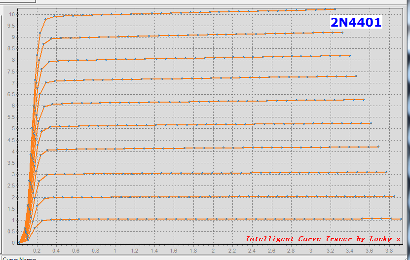

Saturation is really a whole region of low Vce where the beta collapses. See attached curves** which show Ic (Y axis) vs. Vce (X axis) as Ib is stepped for each trace. In this low-Vce region, the slope starts to deviate from the flat lines at higher Vce, where the slope is dominated by the Early voltage. The data sheet "saturation voltage" spec is just one data point from within this region, usually selected as a standardized point of reference for easy comparison between transistor types. Each transistor's saturation curves look a little different, but generally speaking Vce below ~0.5V-ish is in the saturation region... Some have a sharper 'shoulder' than others. Some have a 'quasi-saturation' zone that gives an interesting two-slope saturation characteristic (e.g. 2SC2240).
Anyway, if R1 has more than roughly 7.5V across it, then Q5 collector is going to start dipping into the saturation region. As it does so, beta will fall and base current will rise, pulling the base voltage down. Exactly where a given part will land on the steep part of that curve will vary a lot with production variance, temperature and so on.
Best practice for a cascode circuit is to keep the Vce above the saturation zone with some margin to guard band for effects like thermal drift and aging causing shifts in the JFET drain current, etc. In this circuit, Vce will generally be low, so a part like BC550 or 2N4401 would be a better choice than 2SC2240. In the non-saturation region, the Q5 base and emitter voltages will be largely insensitive to the voltage drop across R1.
Alas, I don't have curves for the ZTX851 at hand. I would guess they are pretty close to the 2N4401. Maybe Mark has them, or I can trace a part later and post it if anyone's interested.
** Credit to @Mark Johnson for posting these elsewhere on the forum. I encourage everyone to further indulge their curves fetish here.

My quick and dirty voltages. Both channels have similar voltages, which probably isn't surprising, since I matched everything in the circuit
From a post I cannot find in this thread, I realized I saved a schematic with someone else's voltages that had Q5 voltages of Base 6.9V, emitter 6.3V, and collector 8.5V, but they only had 2 mA flowing through one of the Q1-4 source resistors to my 3 mA.

Seems like the cascode is saturated with Vce only 0.03V? I would try the trick with soldering 2k parallell to R1. I bet Vce wille be much better then. My 9.3 mA Idss parts work fine (as far as the voltages are concerned) with R1 = 383R.

I found some 2.2k, which would give 559 ohms. It sounds like I should try those and if that does not work, 1k (=428 ohms) and 750R (=375). I won’t be able to do that until tomorrow, but I will report back. Seems better than pulling an input FET or redoing the whole front end. Thanks for the tip. So I want at least 1 volt Vce, or would more be better?Seems like the cascode is saturated with Vce only 0.03V? I would try the trick with soldering 2k parallell to R1. I bet Vce wille be much better then. My 9.3 mA Idss parts work fine (as far as the voltages are concerned) with R1 = 383R.
