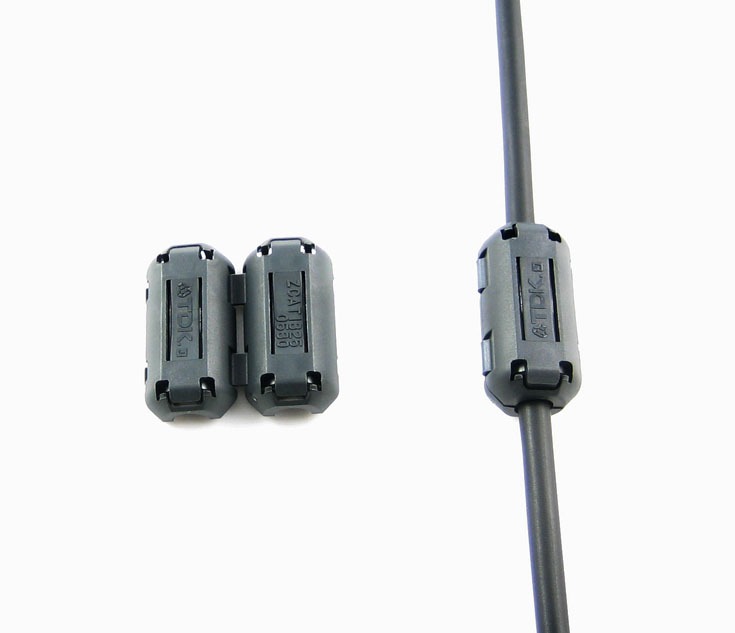

The biggest consistent improvement with noise control I get with any and all phonostages is the addition of a clamp-on ferrite on the tonearm leads. Makes an enormous difference with the ingress of broadcast radio and many other RF -producing widgets like cellphones and some switching PSU.

Thanks Jim! Good suggestion!
