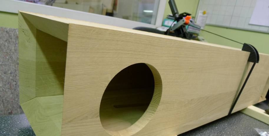

on this facebookphoto you can see the top end of the channelboard inside the TQWT cabinet:

Ok, it's a TQWT style of speaker, which is also not that different als a classic MLTL. The sound will be slightly different altough due to the expanding pipe but it uses the same kind of mass loading of a resonance pipe.
I don't know any design that did this for this driver but the Frugalhorn XL. That will probally your best bet for a close match then except a bespoke design (which is expensive). The plans are also on the frugalpile website i linked before, but need a little donation for all the details i thought. If you want to go bespoke, contact Scottmoose (Scott Lindgren from Woden Designs) as he is the specialist on this, and also the guy who made that frugalhorn and Pencil design.

well, I stated it as beeing tricky, but that's only half of the truth. If you look at Martin J. King he said that there are three kind of TL cabinets: the straight one, the conical expanding (like a TQWT) and the conical reducing. And when you close one end (SL) it only makes sence at the first two and you add a port (with a smaller area than SL) you get an MLTL. So in the end the Sibelius is an MLTL (a TQWT with a port).
http://www.quarter-wave.com/TLs/TL_Alignments.pdf
Designing Mass-Loaded Transmission Line (MLTL) Speakers – Neurochrome
Conclusion build the Pensil and enjoy it!
