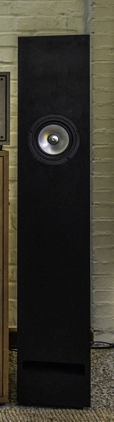

FWIW, I purchased a FHXL flat-pack kit from Planet-10 several years ago; one of the few kits to come down into the USA from Canada. I have nothing else to compare them to, but hands down they have been the finest sounding/performing loudspeakers I have ever owned (still are). Everyone who has ever come over to listen to them has been blown away. The most incredible aspect is their phenomenal bass. However, that does not overshadow their wonderful speed, transparency, and ability to put the listener right into the venue. And, all from a single crossover less 6-in driver. Truly amazing.
I heared those actually a few weeks ago, and they sound like a pensil with the 10.3, altough they use the 10.2 driver, the sound reminds me of the Pensil with the 10.3 i did build for someone. I did not have them side by side, but i'm sure the sound is very close. Both are MLTLs altough slightly different in design. But i don't think the design is that different than my MLTL with the CHN110 (a cheaper driver) and that is probally the best speaker i did build so far altough it's in cheap mdf (as it's still in it's testbuild phase due to covid and the ukrainian war that makes wood very expensive).The build quality is exceptional good altough, hard to do that with diy skills i think. But if you got a pro woodworker (skils) and the right wood, it's probally easy to clone.

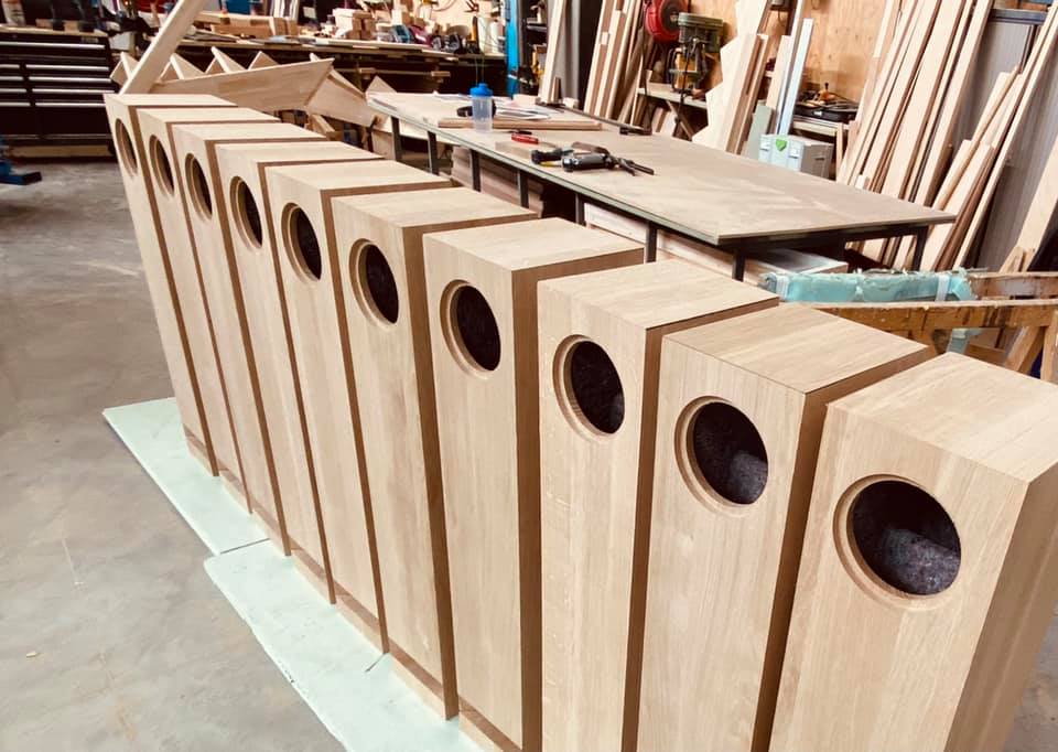

That 32mm thick French oak must be very stable as the top cap grain direction is perpendicular to the side panel grain. I wonder how it compares to American quarter sawn white oak in terms of dimensional stability with changes in RH. I'd like to know what kind of adhesive is used in the miters.Its seems that Sibelius is some kind of hybrid between Frugal horn and Pensil. They also have bunch of photos with FH3 (Valentini)
I am not sure that your speculation about the Sibelius being a MLTL is correct. I am quite interested in them also and the photos I have seen during the manufacturing indicate there may be a tapered line behind the driver. It is hard to see so I may be wrong. There was also some modification (perhaps slight) that was done to the driver so it is not entirely stock. It would be interesting to have more info so a better clone (minus the very expensive french oak) could be made. It would be a great DIY project, certainly an ambitious one.I heared those actually a few weeks ago, and they sound like a pensil with the 10.3, altough they use the 10.2 driver, the sound reminds me of the Pensil with the 10.3 i did build for someone. I did not have them side by side, but i'm sure the sound is very close. Both are MLTLs altough slightly different in design. But i don't think the design is that different than my MLTL with the CHN110 (a cheaper driver) and that is probally the best speaker i did build so far altough it's in cheap mdf (as it's still in it's testbuild phase due to covid and the ukrainian war that makes wood very expensive).The build quality is exceptional good altough, hard to do that with diy skills i think. But if you got a pro woodworker (skils) and the right wood, it's probally easy to clone.
Possibly a folded mass loaded Voigt pipe, or is it TQWT?
All TQWT=Voigt should be mass-loaded. But yes, that is what i undersatnd it is.

Reminds me of this variation as shared by nandappe
neat, above diy dimensions are
41.3" tall x 8 1/4" wide x 13" deep
Sibelius
Dimensions: 1095mm (H) 225mm (W) 295mm (D)
43.11" (H) 8.85" (W) 11.6" (D)

Yes he does I've had several pairs of drivers from him over the years and always fab service. But the OP enquired about a Sibelius clone which is a standard TQWT design with a mass loaded port.Stefan sells some really great kits...You can get a Pensil for the Alpair11 (or MAOP!)
