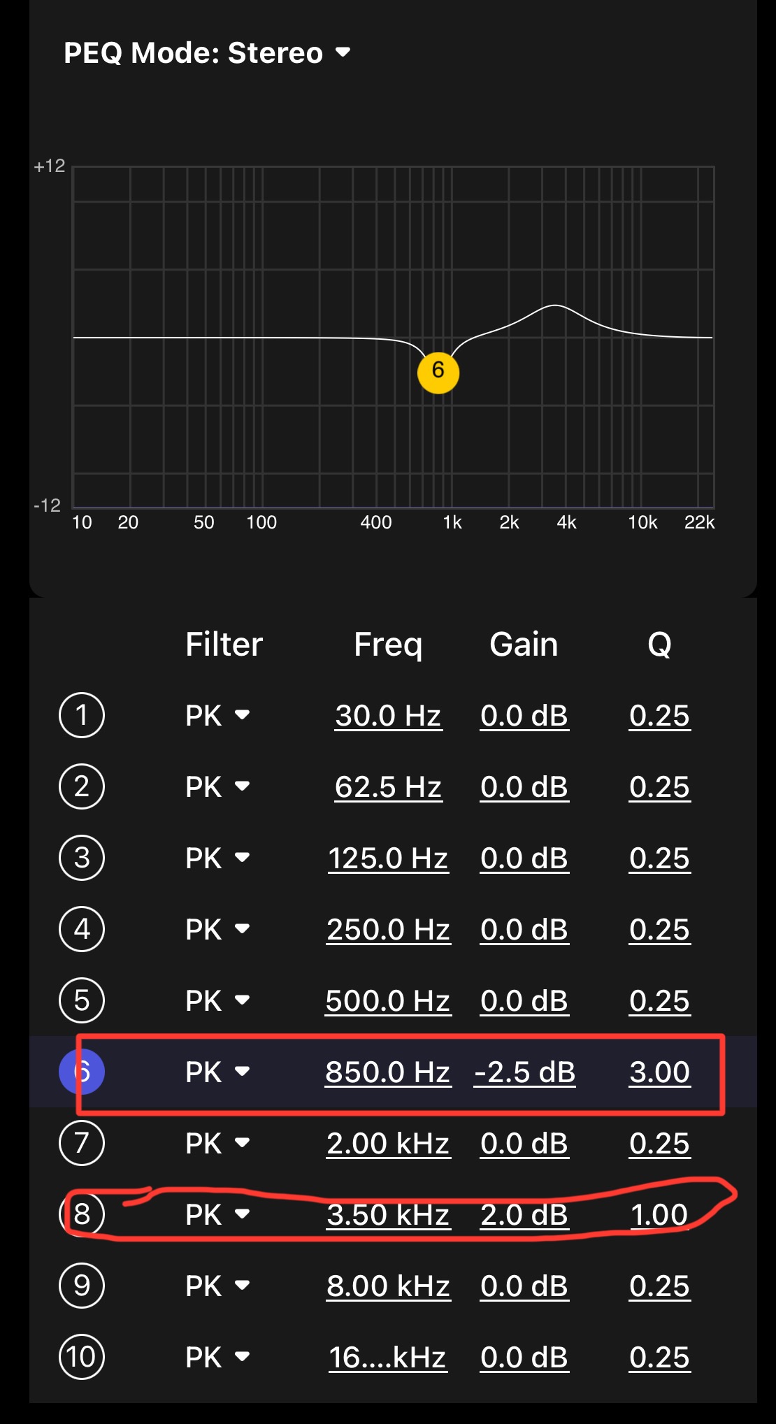

Also for this diffraction treatment, prefer original tuningA dsp would surely make the sound even better . In not saying that a flat response is the best , far from it, but the -5 dB dip at 3,5 kHz would sound better with a -3 dip instead. And that diffraction peak at 850 Hz ( + 2,5 dB ) coming from the geometry of the box is also easily bettered with some mild help of PEQ.
All of you with the Sibelius that have a dsp : Just print frequency : 850 Hz , gain : - 2,5 dB , Q: 3 . And PEQ = frequency : 3,5 kHz , gain +2 dB , Q= 1
Try it and come back for report.🙂
Try listen a couple of days because you are probably biased for the original sound. With that said - use what sounds best.Tried this with the actual Sibelius, not much difference and prefer the original natural bass extension. Perhaps beneficial for the clones?…
Try set the filter for 30 Hz.
Ok, will try again. This dsp control is actually very interesting. The WiiM usb/sub update was only recently released so just checking quickly 🙂

Tried many times but still can’t tell the benefits of this DSP treatment. I guess in a well designed speaker system there is no need for any tweaks. The only useful one is the sub out function where the main speakers are relieved of low frequency excursions, some of which goes down to infrasonic levels…causing unnecessary cone movements. Maybe others can try and report their experience also🙂

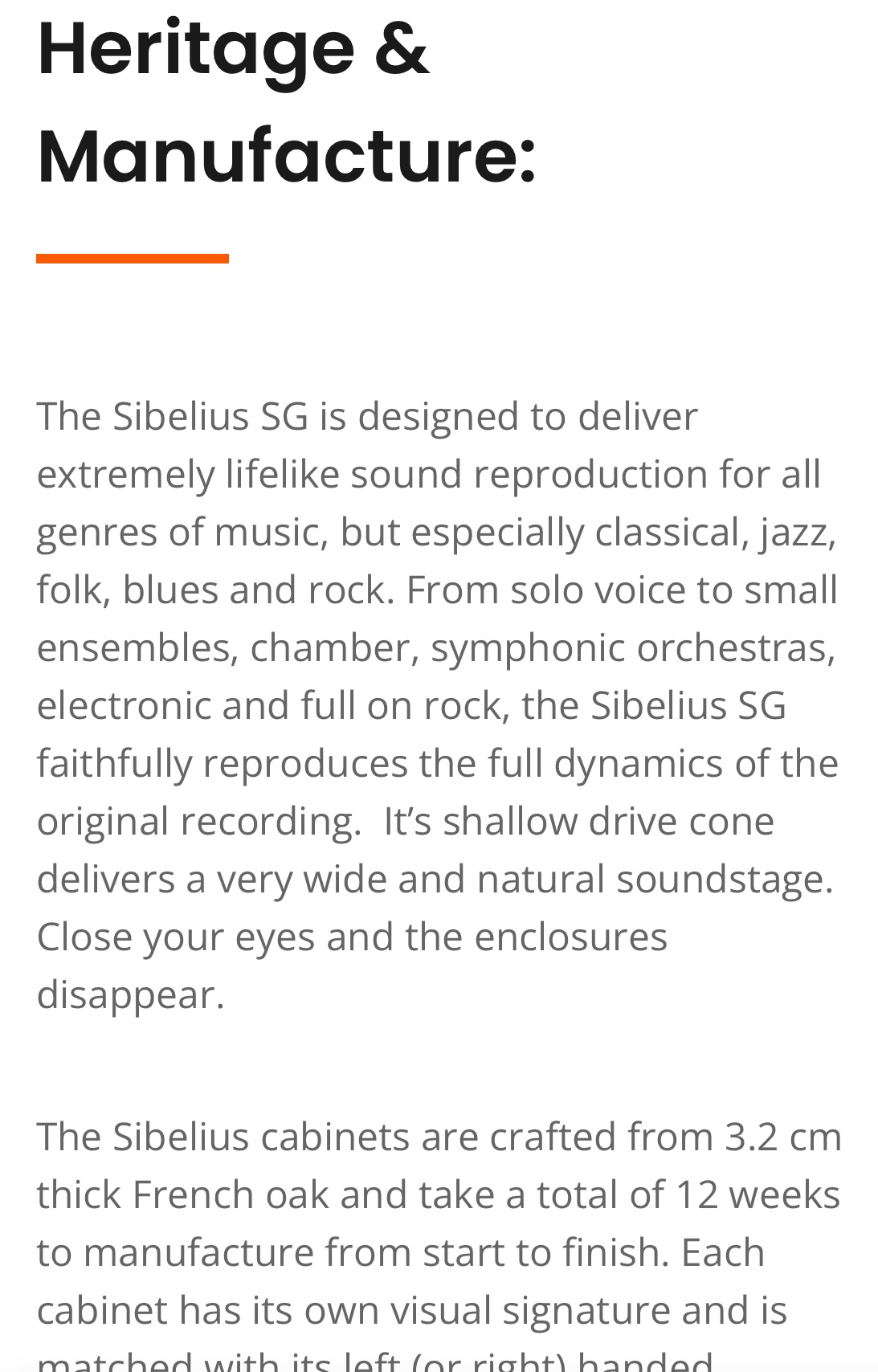

I have been asked about my experience with the Sibelius and I must say it performs as promoted without the need for any sort of EQ (at my place). Pretty happy with it and lately been enjoying music that in the past I didn’t quite like but now with all the details coming out it is like a whole new experience. Unfortunately price gone up by 30% recently 😣
