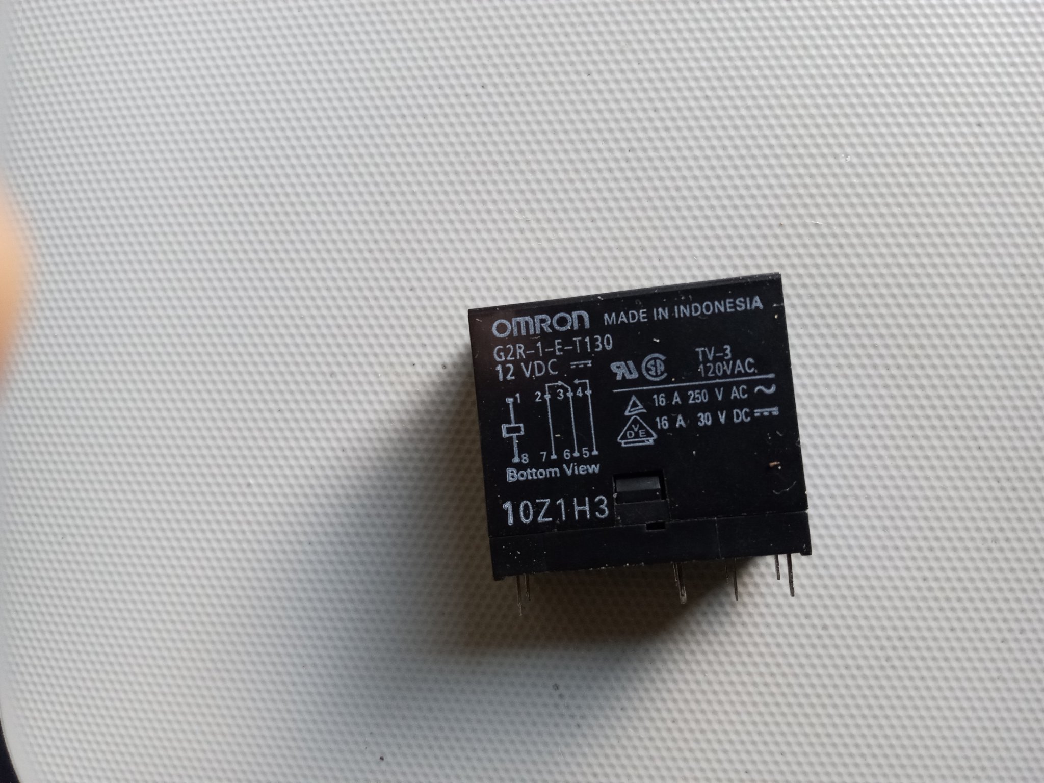

A little confused when looking at the datasheet for the G2R-1-E-T130-DC12 relay to find the correct coil resistance to calculate the resistor value.
Is this relay the 12V DC bi-furcated contact form where the coil resistance is 275 ohms (note: there is no "Z" classification in the model number to indicate this) or is the relay the 12V AC single contact form where the coil resistance is 65 ohm. I think the latter 65 ohm is correct, but want to check.
Note: On the Mouser website the coil resistance is listed as 275 ohms in their details, so I am confused
Can you clarify this for me?

Hi shaan,
Use one 330ohm and one 470ohm, both 2watt, on each side.
In the picture you shared there is clear 12VDC marking on the relay. So I think 275ohm is correct. You can also directly measure the coil resistance with the meter. Now the formula gives a value close to 400ohm for each of the resistors. So to make it 800ohm total, 330 and 470 is at our disposal.

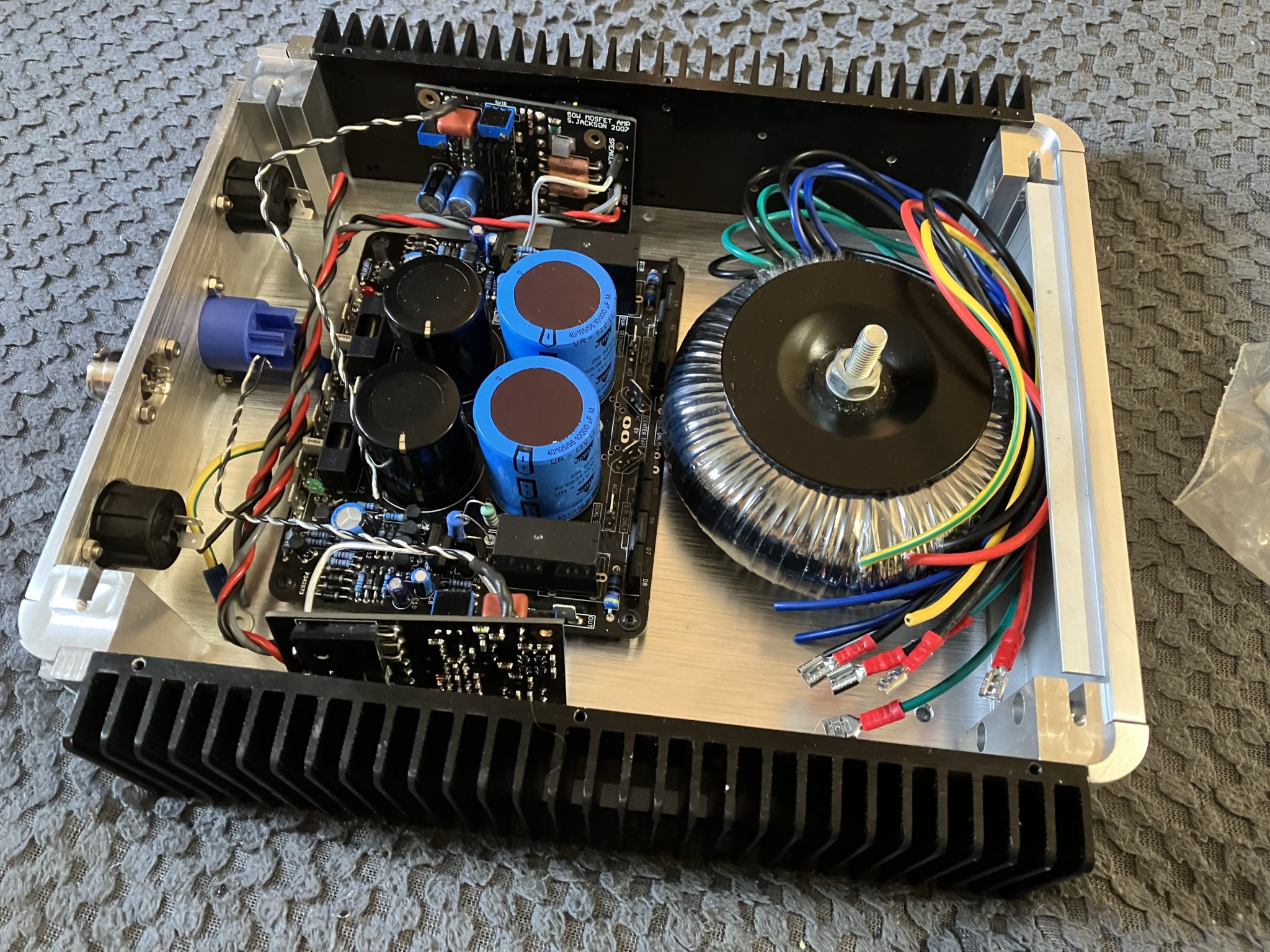

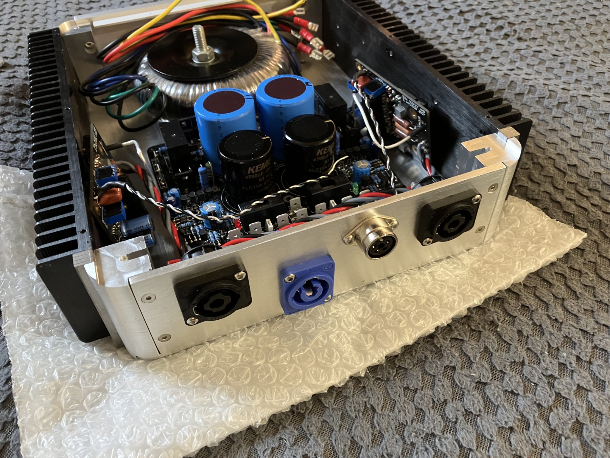

Nearly finished my 50W AEM6000 build using your PSU, James Transformers messed up the secondary voltages on a transformer they sent, so will be a while yet unfortunately.
