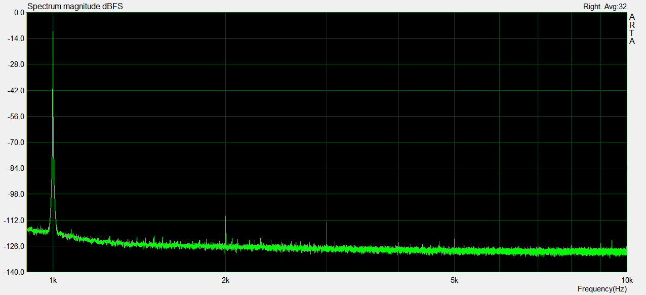

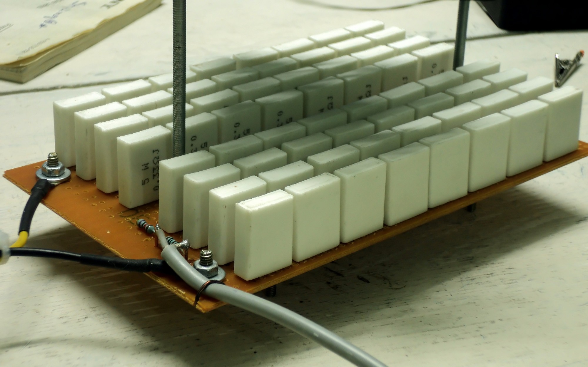

Sorry for the recent silence. Have been busy with this sucker. A proper 300W 5R load. And got the following 1KHz 10W THD spectrum out of it.
V4H GB will go online next week. :)
