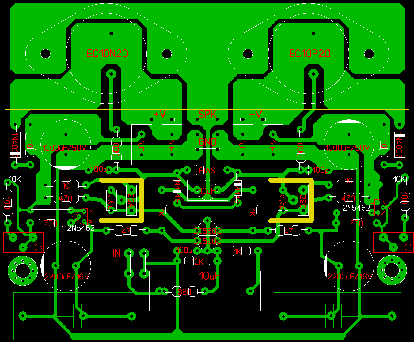

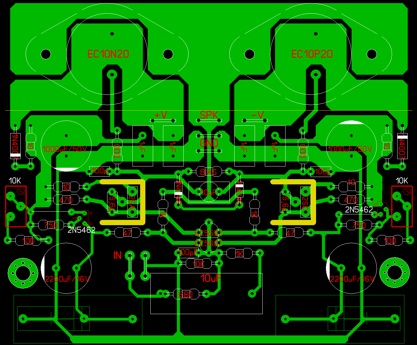

I have made these small changes and there are reasons that have been made them by LC.
Really not need gate resistors Only 100pf colector to ground .Comp cap 5,6pf but when pull out 100pf and no comp cap i have oscilation with 1K and 47 Ω but with 2,2k and 100Ω no osc at all .All these with bd 139 and 140 .
I made some changes to the board Jason and working very stable
on 47 Ω 120mv to other 121mv
on 470 Ω 870 mv to to other 875 mv
1,6V total on gate without gate resistor
only 100 pf col to ground 10pf comp- CCS 2N5462 - 1k and 47Ω- offset 1-3mv positive.
I hope to not be a problem by Μr Shaan and Jason
It seems to me that all TH boards in this thread could probably work without gate resisitors. Only Borys's pcb with two pairs of HexFets must have gate resisitors. Gate resistors are necessary with multiple Fet output pairs. If you remember the generic Hitachi schematic that I sent to you (with one pair of output transistors), there was no gate resistors. All pcbs featured in this thread are compact, with short pcb tracks and good layout with topographic placement of components that go from input to output. Therefore there should be no problems in using one output pair without gate resistors. When you repair the boards used for "antenna experiment" you can replace gate resistors with jumpers and see if bandwidth is more extended compared with resistor version and if stability is exemplary.

Small change on CCS
Hi Ivanlukic
Small change on CCS
Oh No...Small change on CCS
No CCS please
Shaan will not happy with it

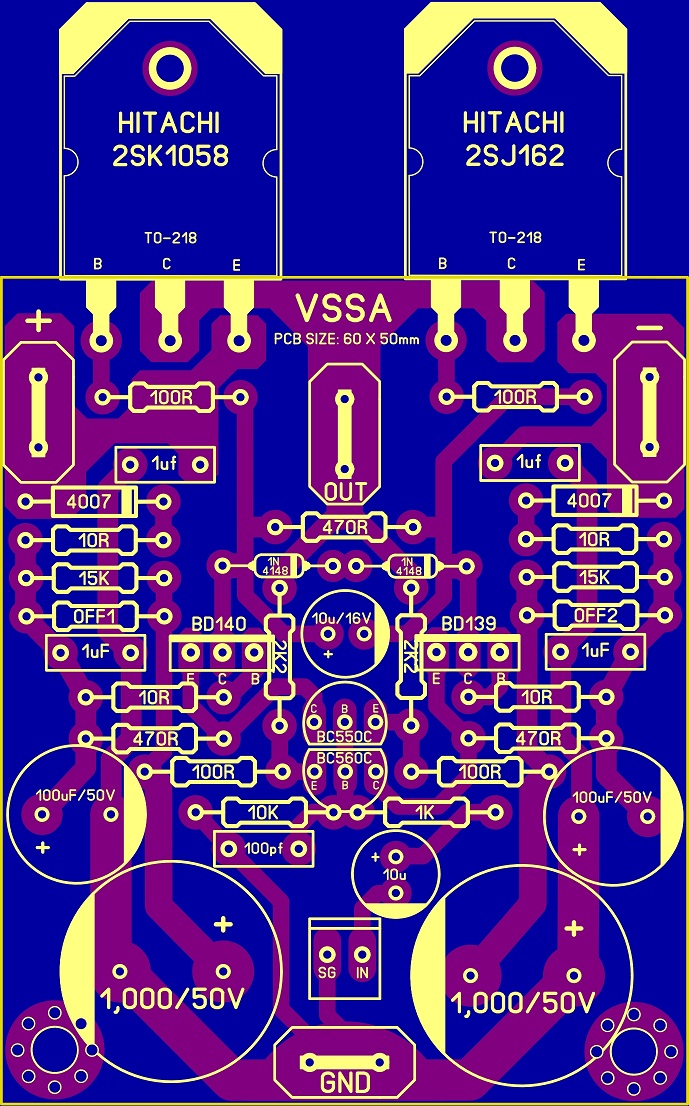

I think your connection between the BC550 and BD140 is wrong. It should be Collector to Base, it isn't it?

Thanks for the comments, PCB base on Shaan layout.
.... please clarify.

nikosokey,
This is very useful information concerning TH version of VSSA.
Very nice!, and thanks for posting your results.Really not need gate resistors Only 100pf colector to ground .Comp cap 5,6pf but when pull out 100pf and no comp cap i have oscilation with 1K and 47 Ω but with 2,2k and 100Ω no osc at all .All these with bd 139 and 140.
However, I am not sure I agree with the conclusion. My logic is this: If using 1K in the feedback can cause oscillation with fairly slow drivers (BD139/140), and if everything else was the same, then we should be a bit careful when using other, faster drivers.
If eliminating the gate resistor means adding a 100pf cap, I am not sure what is gained. If you want to leave out the compensation caps completely, and at the same time have to add 100pF elsewhere, and at the cost of a more complicated layout, is there really an advantage?
On my board, a compensation cap on the driver transistors has almost zero impact on the layout. Adding a 100 pF close to the collector means bringing a new ground track into the middle of the board, using either a jumper, or a very long track. Clearly this makes the layout more complex, even if the gate resistor is eliminated. It also makes it more difficult to allow for a larger footprint for VAS heatsinks, which may be necessary for anyone who wants to raise the current maximum supply voltage.
I would like to have a board that follows Shaan's basic idea to have a VSSA that anyone can build with parts available almost anywhere, etch by himself, or use a professionally made one like I do. I think this is what makes Shaan's approach worthwhile.
If I wanted to make a VSSA just for myself, I would use CRD's, two-sided layout, supply split at the VAS stage and regulated, Exicon or Alfets, etc. I still think about a design for a double-die Exicon...
There would actually be a significant benefit to removing those resistors completely on my board. There is a tradeoff that had to be made: shortest track v. single signal layer v. best component placement... something to be discussed if other people are still interested in another rev of my board.
Even though this may be a stable circuit with any reasonable care, we should also say that it does not take too much to make it oscillate, and the result could be some damaged components.
Gate resistors should be used by diy-ers that do not like to experiment too much, that want their pcb to work immediately without any problems, from the first power-up. This is simple preventive measure.

Hi wiljj78,
I think Tyimo is right (in post #724). While the BD139 and BD140 pinout labels are correct, they appear to have their bases and emitters reversed on your layout. (That is, they connect to each others destinations).
Could it be that there is error on Shaan's pcb? It seems to me that Tyimo is right. Usually the error is on pcb and not on the schematic. I checked PMI's pcb, compared to the schematic, and to me everything seems fine.
You're right ivan! i found it thanks...
Hi wiljj78,
Yeep! BD139/140 have to rotate 180 degree, thanks guys....

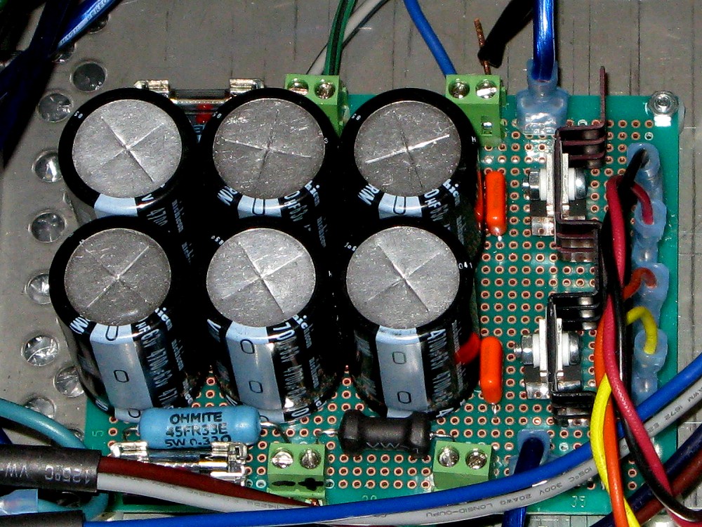

Is there any rule of thumb for PSU sizing for Class AB amp?
Greets:
Tyimo
Not really. There are various considerations. The type of load, 8 ohm or 4 ohm, peak power v. continuous power, and the amount of acceptable noise and ripple.O.K. I see.
Greets:
Tyimo
I originally sized my power supply for low-to-moderate power into 8 ohms.
250 VA transformer 25V AC, rms, dual secondary
Schottky diode rectifier w. minimal heatsink
3x 4700uF per rail, in CLCRC passive filter configuration
+/-35V DC nominal, 37V max rail voltage
3A fast blow glass fuses in power supply rails
Since then I decided to use a power supply with an active filter, capacitance multiplier type, from a circuit posted by MrEvil here in the power supply section. I did that because I gradually realized that this amplifier needs much cleaner power supply rails for best performance than I first thought, especially without CCS.
