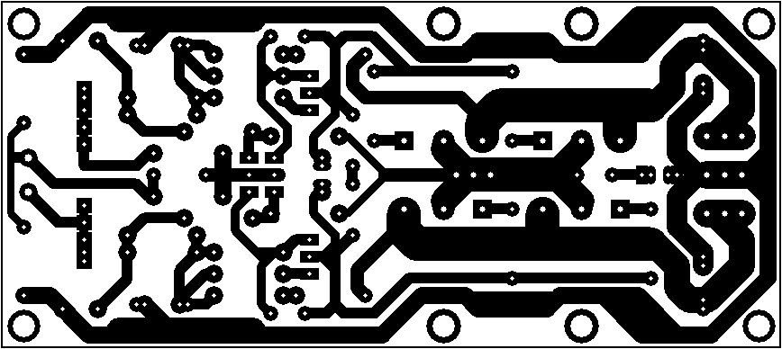

For the input ground reference, I think that is a good idea.
I have to think about the bias ground.
In some other applications I am familiar with, a ground trace which circles the board can (although not necessarily will) cause some issues which then have to be overcome in other ways. What I am referring to is that as the load shifts from one rail to the other, an alternating current is generated in what is essentially a loop, and a loop antenna. The current reverses direction when the output signal crosses zero. So if you bring a small signal on a pair of wires close to that without additional shielding, there may be an issue. (note that I say "may", not will).
So splitting the ground trace in whatever way would help with that too, I think.
Once the caps after the diodes are charged the total AC current in the onboard ground traces will be very small as the speaker return will go to the star ground and not on-board ground. Still, this very small AC can cause great problems with the perfect combination of C and L and damping the L is what the two 10R will do. I think input bias current will not face any problem and RF suppression through 100pF won't be significantly affected either as total resistance from input 0V to ground will be ~5R.
Make sense.Once the caps after the diodes are charged the total AC current in the onboard ground traces will be very small as the speaker return will go to the star ground and not on-board ground. Still, this very small AC can cause great problems with the perfect combination of C and L and damping the L is what the two 10R will do. I think input bias current will not face any problem and RF suppression through 100pF won't be significantly affected either as total resistance from input 0V to ground will be ~5R.

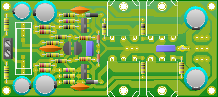

The holes for the elcos and diodes will be made 1mm. Also the VAS and FET holes will be appropriately enlarged when finalizing the layout. It currently looks like the attachment below.
edit: the VAS heatsink can't be in touch with the board. I can't move the diodes anywhere without significantly increasing board width.

edit: any comment on the layout? can we publish the pdf?

Layout looks fine to me, but you may want to give it a day so others can comment.
I do not know what track-to-track spacing needs to be for a self-etched board. Under-etch might make a couple spots close, not sure. For example the track which connects the two gate resistors on one side seems close to the ground trace.

Sure. I am not planning to etch it currently. So fellows decide when it will be released.
Thanks for noting. Will be repaired.

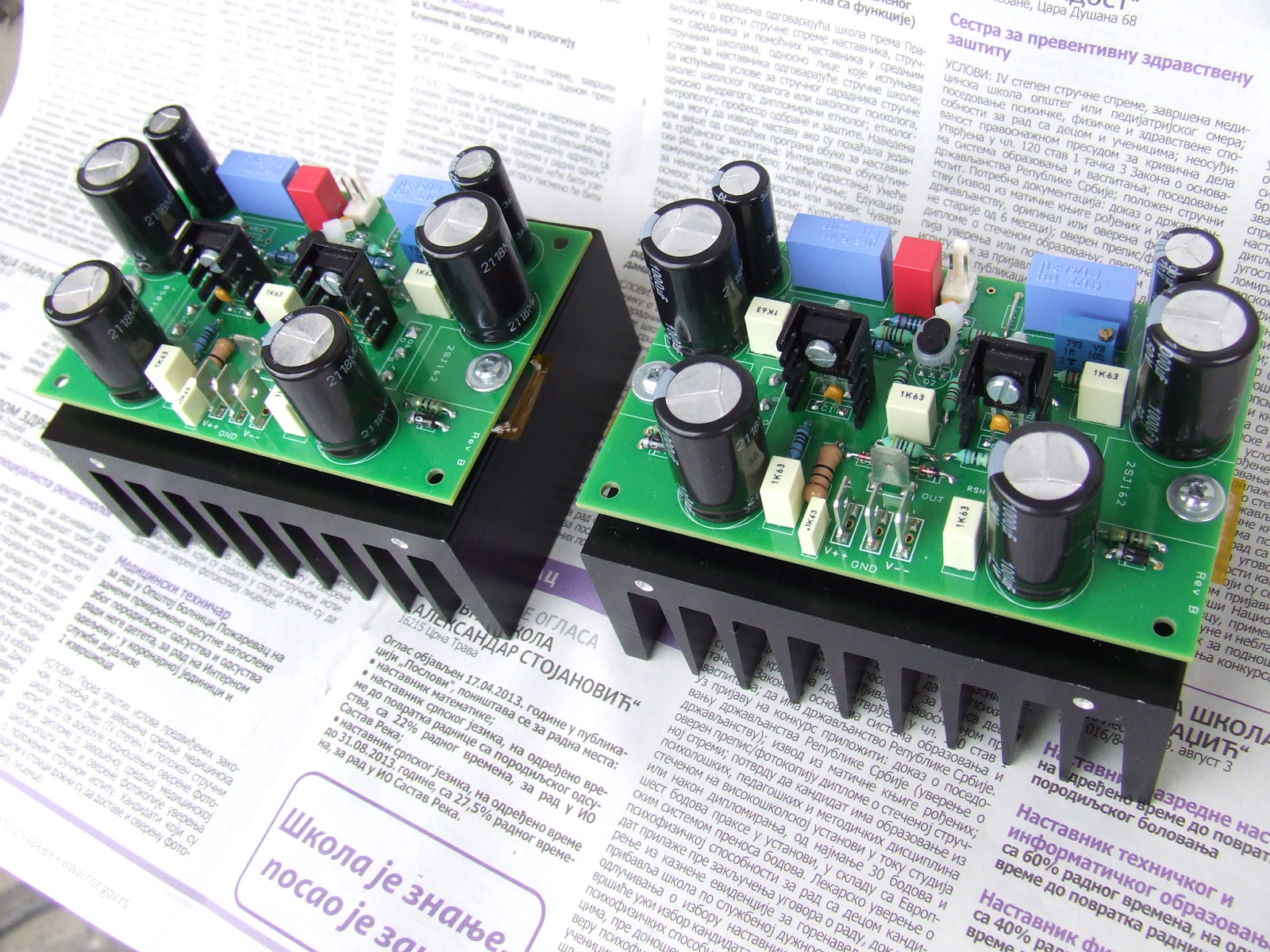

VSSA/PCB/layout by PMI modules
"Modules" are finished. Electrolitics are all Panasonic FR (two 1000uF and one 2200uF). The most important deviation from LC's circuit are that instead of 10uF MKT in the feedback circuit I used Philips 1uF Polycarbonate (these are hard to find because no longer in production for more than decade). Polycarbonate is famous for it's non plus ultra slew rate characteristics. This is not a big deal, circuit will work properly with only 2200uF and no film caps at all.
Heatsinks may seem too small but for my small listening room and high efficiency loudspeakers this is enough. Most of the dissipation will be quiescent so for the time being they will do. I do not expect problems with these 1,5K/W heatsinks.

@IvanLukic: Looks great (well, I am a bit biased...
If anything, the boards look cleaner than mine with the fastons in place than the big green screw-terminals I am using for testing, and the spacing around the cap in the Zobel network looks more correct on your board.
