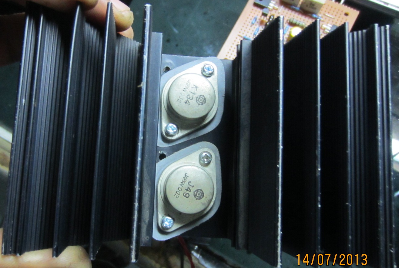

CPU heatsink from local used/recycled goods market. 2 for 1 dollar.![]()
Old Pentium II or celeron cartrige if my memory is good...Shann will be enough or will you adding a fan?

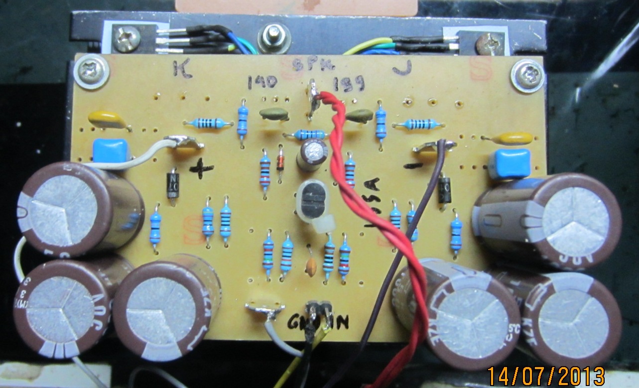

after lots and lots of helping me see this project finally VSSA untum I'm done with components that are still simple, thanks to Mr. Shaan, Mr. LC and my good friend Mr. Jhon Bali, Mr. Naf. I use a transformer 5A - 25AC and get Bias 1.5 V DC offset but still fairly high and I will try to make better.
