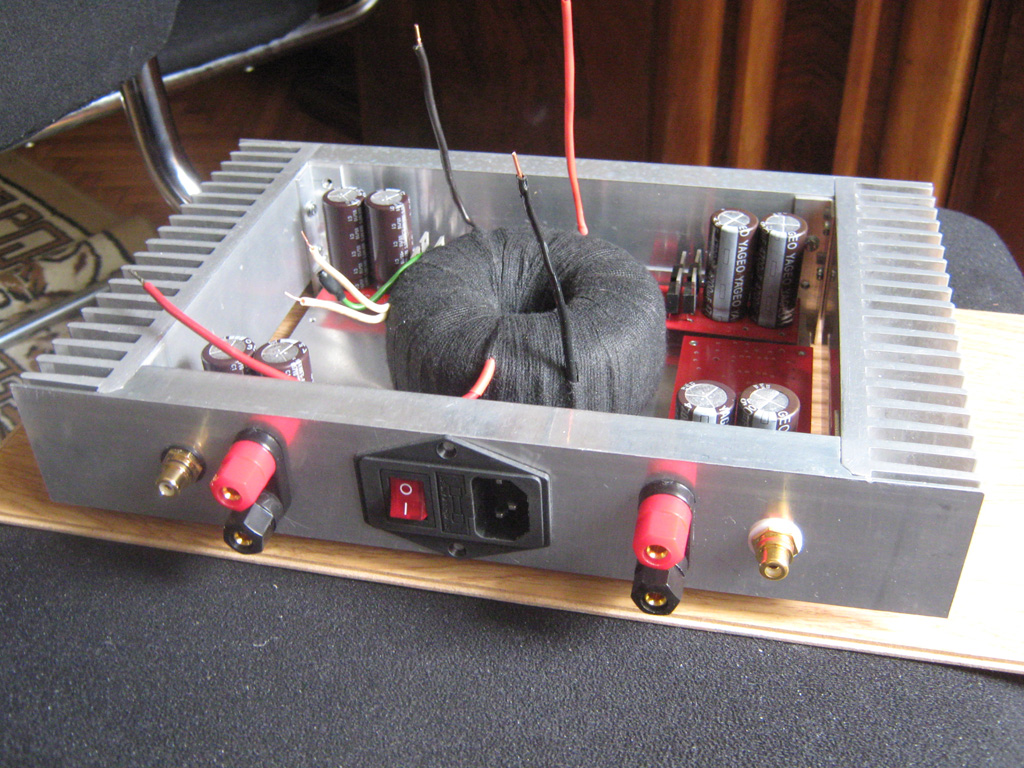

You are absolutely correct. The input cable is indeed sensitive to EMI.
Yes, there are rules that must be obeyed when building amps.
I tried to brake those rules and made very small enclosure, smaller then sheet of paper (290 x 190 mm). Although all components fit inside, I didn't get good result.
Input cap is next to trafo, input and output leads go together over power supply, enough for bad result.
To avoid noise I ordered bigger heatsinks and I'll make standard (17") width enclosure, so components will be at bigger distance.
Then I'll again enjoy in beautiful sound of this wonderful amp.

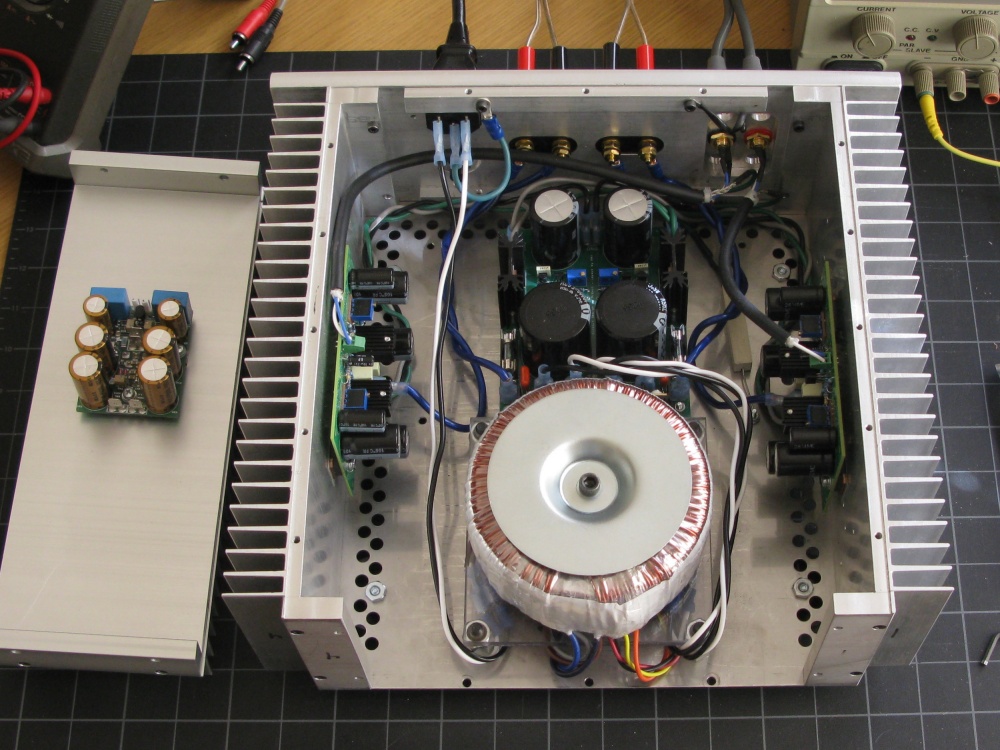

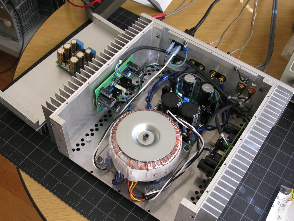

@dobrivoje:
My test chassis is not much bigger inside than yours, with an ordinary toroidal transformer, not shielded. However, I am using a twisted/shielded cable for the inputs, with shield connected to chassis in the back. My power supply is highly filtered, but also quite small. So, you do not always need a big chassis (even though it is nice to have).
The mains wiring is normally twisted, and shorter, but the picture was taken when I was doing some testing on the transformer, so I needed longer wires.
The white/black wires are AC. Grey cable is input. Blue wires are output and return. Transformer primary and secondary connections are at the front, and the extra wire length I needed for the test is tucked under the transformer. One of the modules from LC's group buy is on the left, shown for scale.

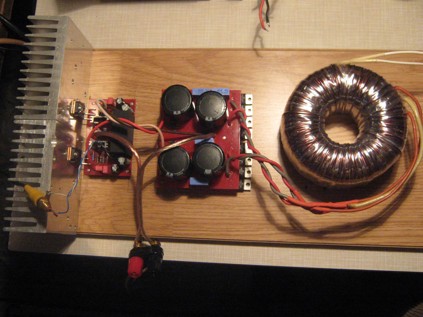

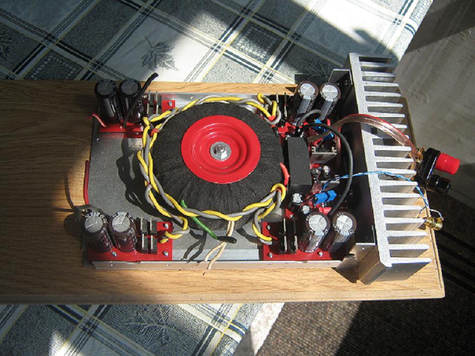

Some space is obviously required, but it is hard to tell how much or how little. Can you hear any noise from the speaker? If you can, the easiest thing to do is just make longer wire pairs, and move them away until the output is silent. That gives you a general idea of how much emi there will be in a chassis.Thank you, PMI.
I also got some advice from Juma and I'll try to fix the problem.
You have three inches between trafo and amp's input. I have ... khm ... zero.
That's what I'm talking about.
I hear some buzzzz from speaker.
When amp was on a board, I heard only "sound of silence".
Even now, when I move amp an inch or two away from trafo and divide input and speaker leads, there is no buzz.
I hope this weekend I'll make progress and solve the problem.

Hi Dobrivoje,That's what I'm talking about.
I have same problem if the transformer is too close...
that's why it is still naked
Try lift the transformer like PMI did, use non metal/non inductive spacer if that can solve the problem
