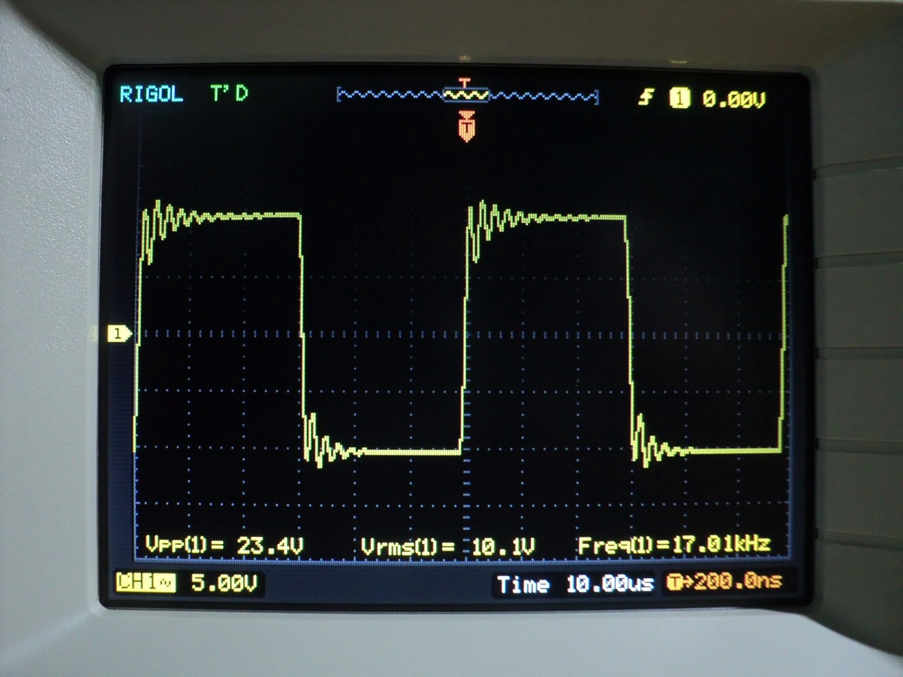

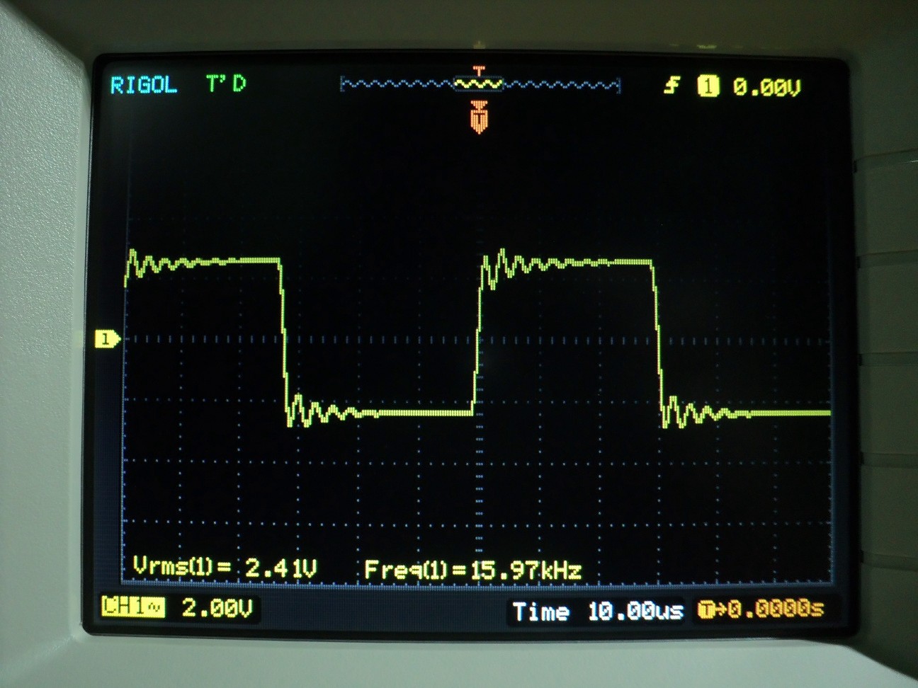

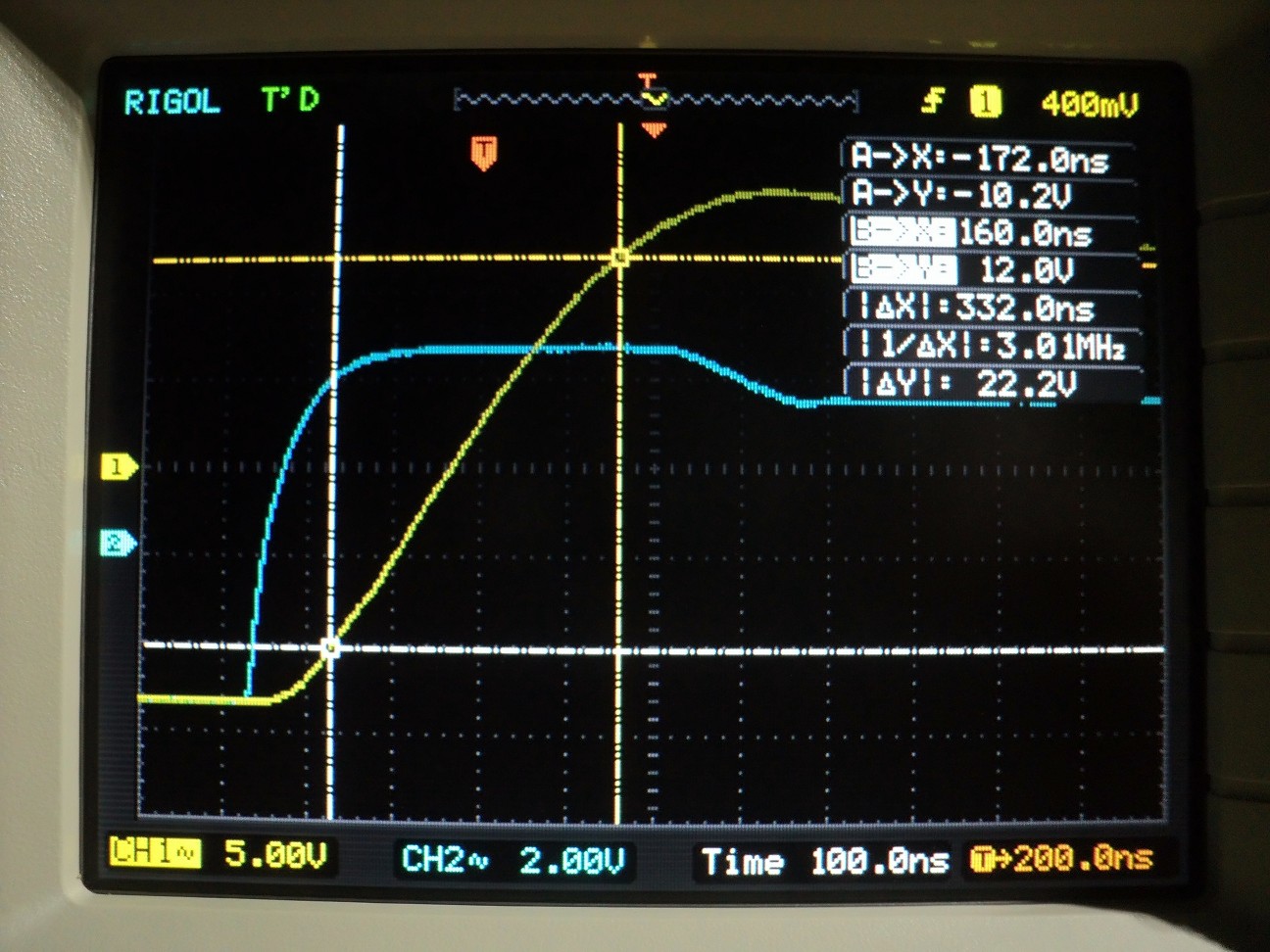

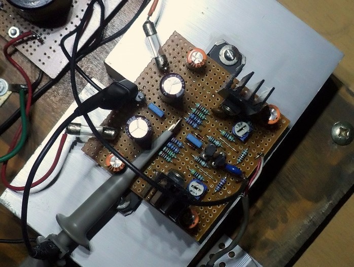

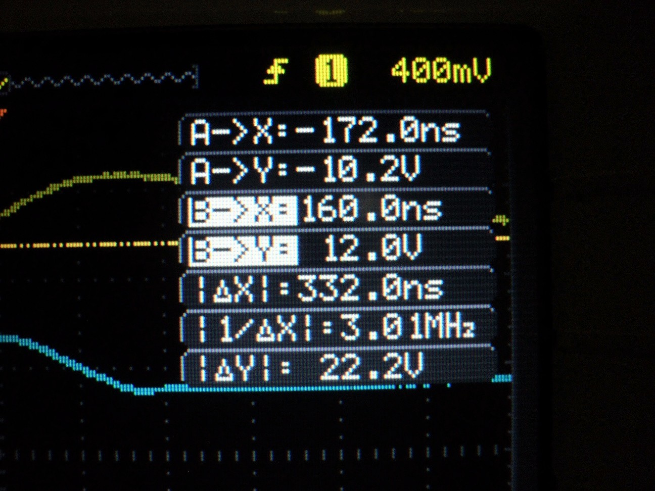

Hi guys! ![wave2 :wave2: :wave2:](https://files.diyaudio.com/forums/images/smilies/wave2.gif)
Here is a scope shot of one of my PeeCeeBees amplifying a 140KHz uncleaned square with 60nS rise time. Two 22pF Cdom installed. Input RF shunt and zobel removed.
Happy New Year!!!
(more traces coming)
Happy New Year!!!

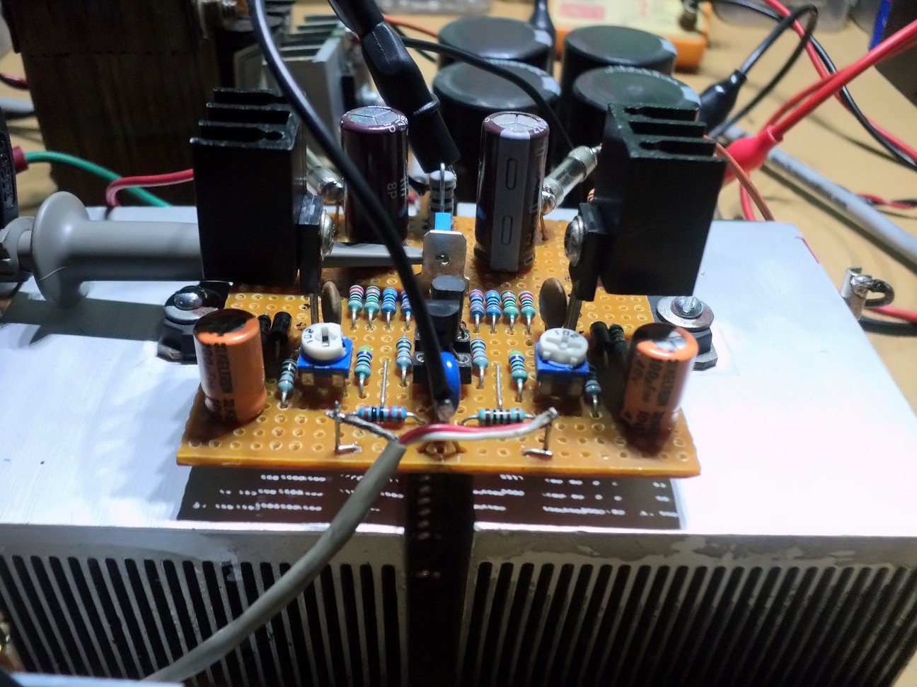

looks a bit like mine, with four channels on strip boards. I'm building two channels of stereo amplification, although I will build a prototype first, to check on CCS and Cdom cap values. I have split the power supplies, so that the output transistors have their own supply, and the Vas its own. I'm wanting to give the input pair their own, too, from a 12 - 15v supply. Total cap count is nearly 100 per stereo channel, with about 10,000uF per rail per amplifier, with much bypassing with poly caps, too.
Pics when I can![snail :snail: :snail:](https://files.diyaudio.com/forums/images/smilies/snail.gif)

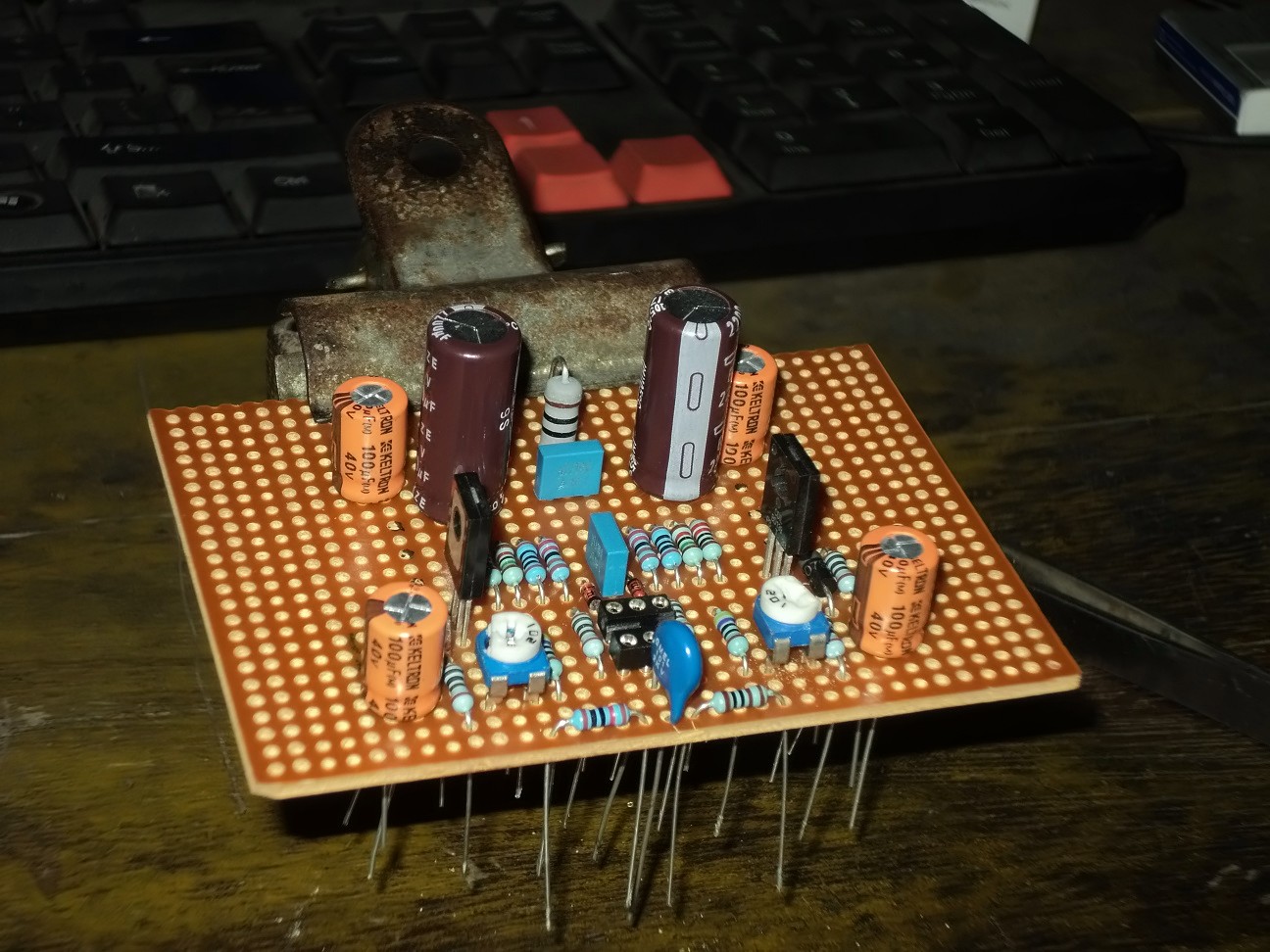

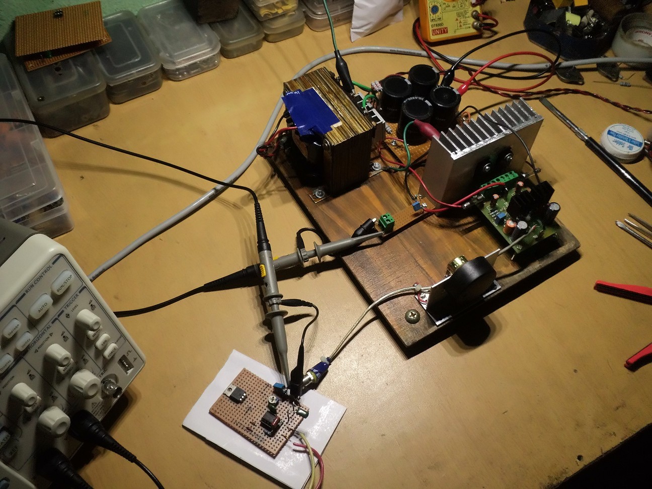

In the meantime...

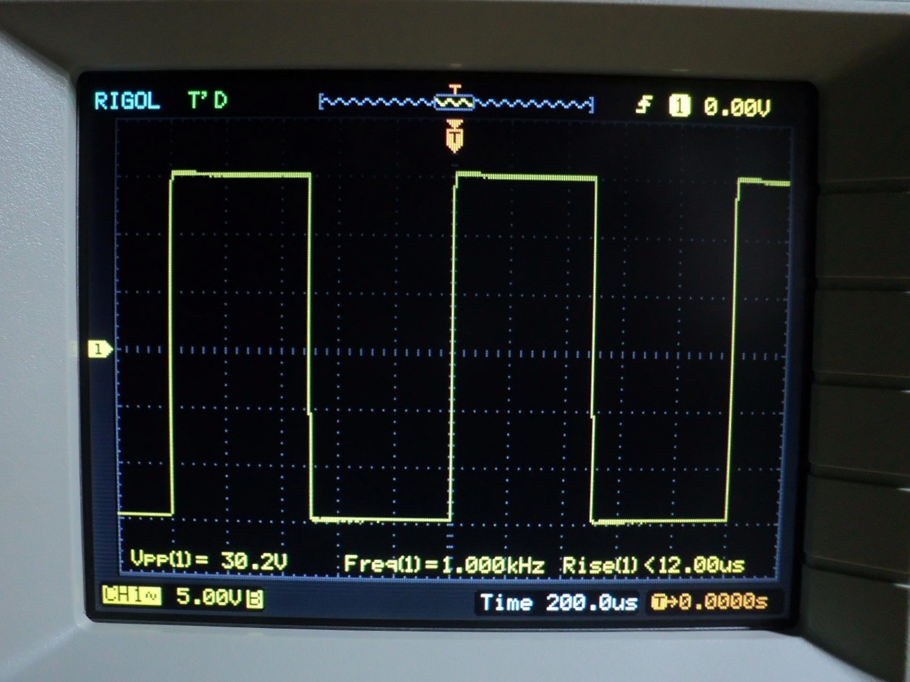

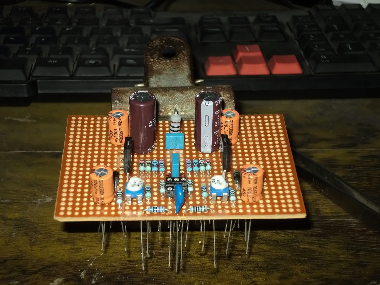

The new layout is significantly different from the previous PeeCeeBee and the FETs and VAS are targeted to be mounted laterally with the board. Also the feedback caps have been moved to the opposite side of the board. Input is direct coupled.
At power-up 40mV offset without setting. Manually set to zero by turning -ve side trimmer. Picture shows 1KHz scope probe calibration output amplified and no sign of ill behavior.
Load tests are next and will be uploaded tomorrow. If successful then layout will be sent to printer for batch printing.
A new pcb is on the road!The new layout is significantly different from the previous PeeCeeBee and the FETs and VAS are targeted to be mounted laterally with the board. Also the feedback caps have been moved to the opposite side of the board. Input is direct coupled.
