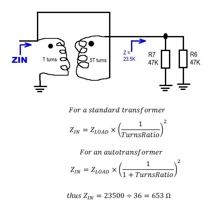

I've been simulating the signal currents that flow in the primary of the First Watt M2's input transformer. And this has led me to a discovery: I might be badly mistaken, but I think the circuit is discussed erroneously in the user manual. Here is the pencil and paper explanation.

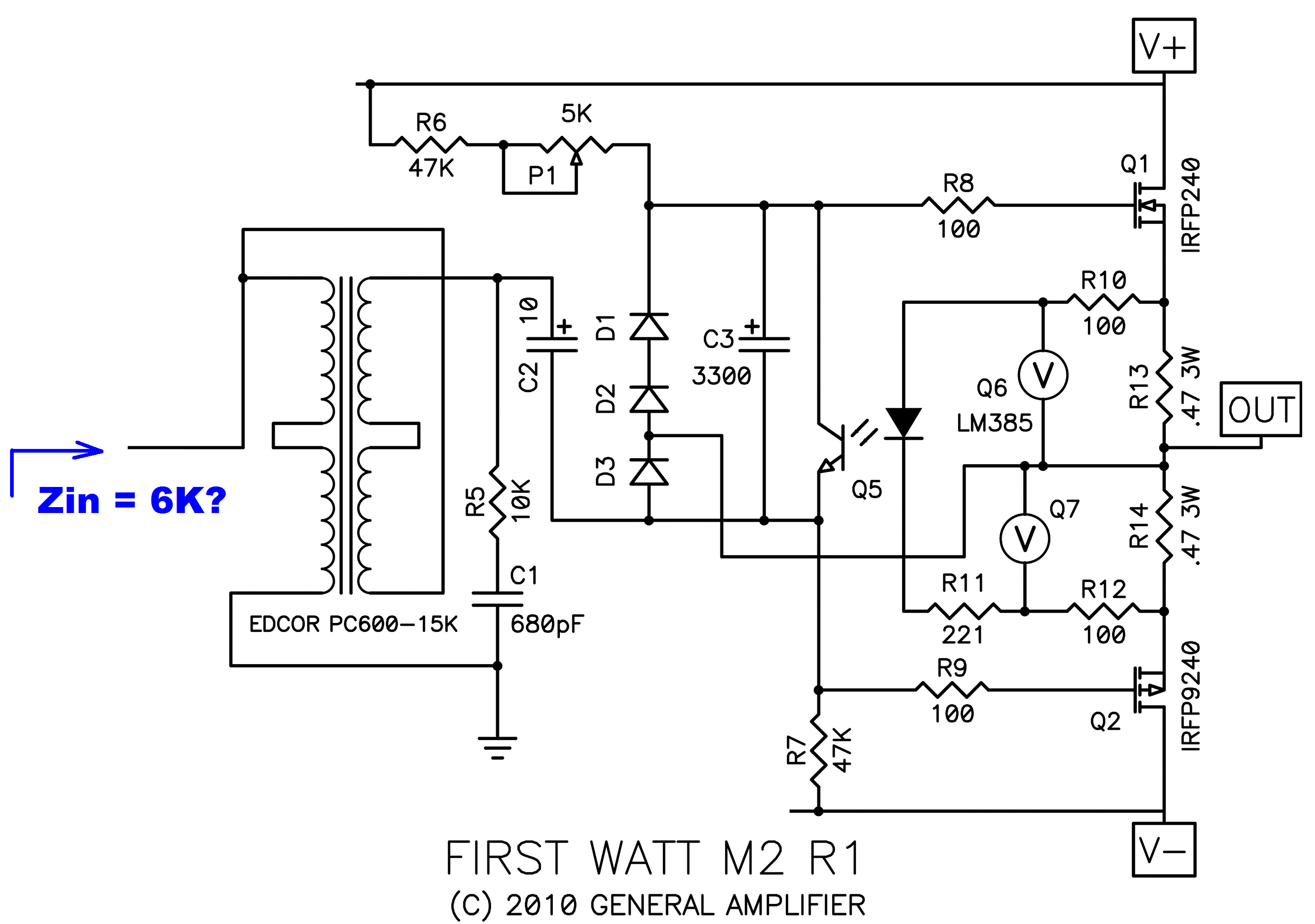

The relevant piece of the M2 schematic is attached below as figure 1.

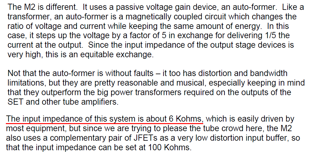

I think the user manual describes this, in the passage which is attached below as figure 2. Please have a look at the red underline. I think this is saying that the impedance looking into the primary of the transformer, is 6K ohms. That's what I drew on figure 1 above.
To analyze the impedance we treat C2 and C3 as short circuits, and we treat V+ and V- as AC-grounds. Then the transformer secondary is loaded by R6 and R7 in parallel, plus another big nasty mess caused by the Cgd's of the output MOSFETs, which I will assume is super high impedance and thus negligible.
What I get is displayed in figure 3 below. The Edcor transformer has a turns ratio of 5-to-1. {Math check: 600 = 15K / (5*5)}. So the impedance on the secondary, 23.5K, is reflected back to the primary, by a factor of 6 squared. Thus Zin = 23500/36 = 653 ohms.
But the manual says 6000 ohms. Where have I gone wrong?

In the first paragraph Nelson mentions "input impedance of output stages".In the 3rd paragraph he mentions "input impedance of this system" which I think are the same meaning. 1/47k+1/47k+1/10k=1/Zin=about 7K ohms.I think you are mixing up input impedance looking into the primary of the autoformer vs. input impedance of the output stages.
If you're talking about R5=10K, that's part of a Zobel network that shapes the HF response of the transformer. Notice that the R5+C1 Zobel only begins to have an effect at 23.4 kHz and higher.
However: IF the transformer DOES happen to drive 7K, then the impedance looking into its primary is 7000/36 = 194 ohms. That's a mighty heavy load for a couple of dinky little TO-92 source followers to drive, especially when you notice that the amplifier's I/O spec says "3VRMS input needed to deliver full rated power to the load". 3V/194ohms = 15 mA RMS output of the source followers (21 mA peak) ... more than their Idss! You'd need to forward-bias the gate/source junction to get that much current. Ugh.
xformer see OS as ~23K
xformer voltage transfer ratio is 6x
xformer impedance ratio is 6^2=36
so , buffer see 23k/36~640
all that using ideal values , not actual measurements , but that will give 10% diff. max
10K-680p is irrelevant at audio freq.

I get notional 652.777 Ohms. As you say.
And he works the 600:15K windings pretty much spot-on the design spec.
The diff 6K versus 653 will not bother most users. Still, it "can't be right", and smacks of a lost decimal place.
But there are two 47K resistors hanging on that point. Mark's math just assumed the 23.5K and neglects Gates and Zobel (which are first-order neglectable).

Reread the User Manual excerpt in post #1, and see if you agree that the dual JFET front end is only needed when driven by a tube preamp. All other preamps could easily (?) drive the 653 ohm input impedance of an M2-without-JFETs, wouldn't you say?
No, I wouldn't say a 600 ohm input impedance is an easy load for all non-tube preamps, that's why I thought he may have been referring to the generic example in the manual, since that is the context.
