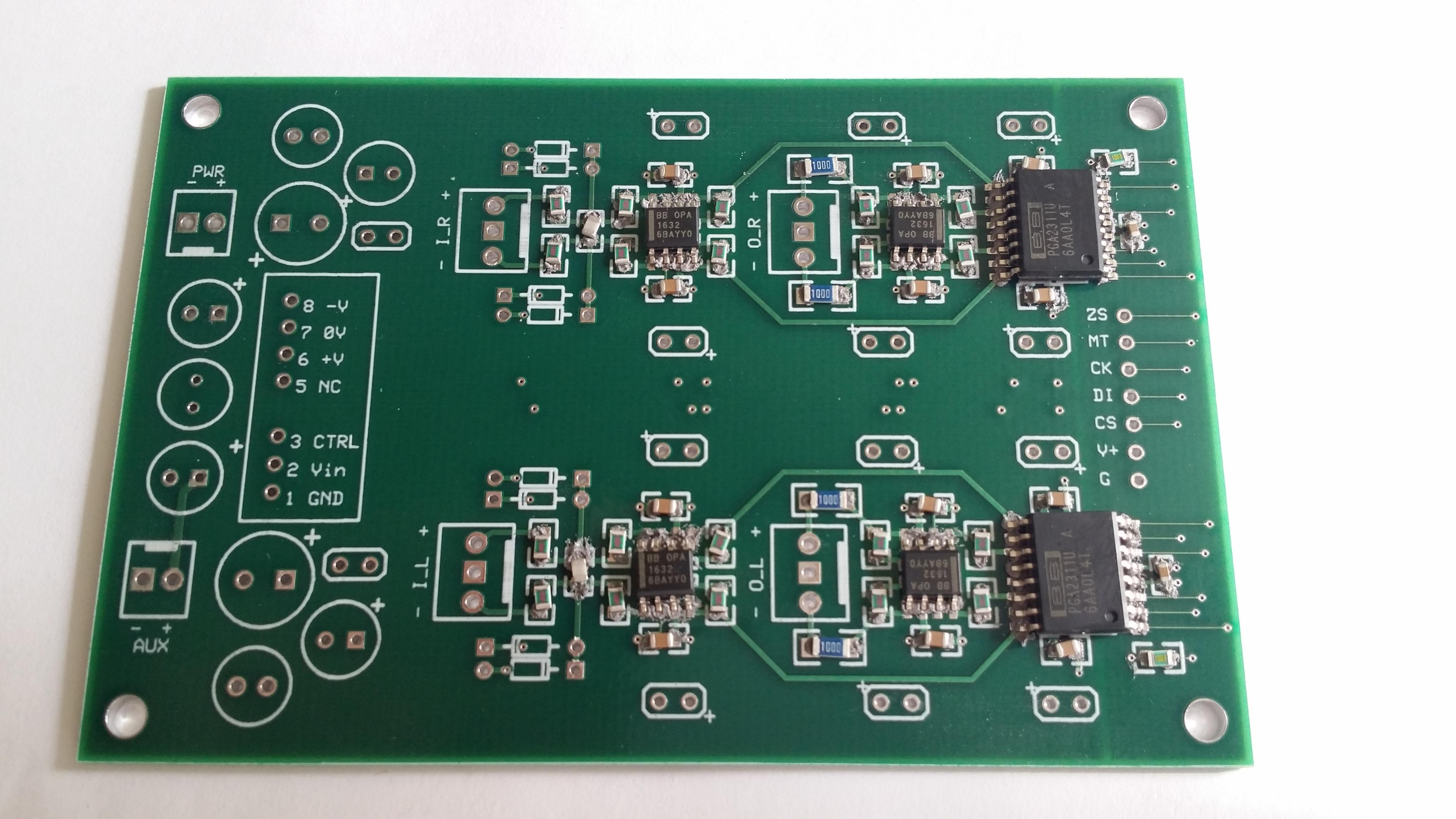

I'm looking for feedback on a first rev PCB design for a PGA2311 volume controller run differentially (i.e: balanced) with OPA1632 as input and output buffers. I don't have a real schematic drawn up as I'm working from the data sheet recommendations. Hopefully I'm providing enough info. I've prototyped the digital side with a though-hole PGA chip and single ended signals.
Here's an album of the PCB layers:
https://goo.gl/photos/3FPrTtyCsy9ceFTo9
- The board will take in a regulated 5vDC supply that will be converted to +/-5vDC using a CUI DC-DC converter that is filtered with caps and radial inductors at the input and outputs. The incoming 5vDC also provide digital power to the PGA chip and can back feed to the uController which is off-board.
- There are 2 circuit grounds but only one ground plane. I split the ground in the lower right corner, the larger portion is for audio ground and the smaller for digital.
- The OPA1632 can take a single ended or differential signal and drive the two inputs of the PGA chip with a differential signal, lowering even-order distortion
- The OPA1632 PCB layouts are based on high-frequency recommendations from the LMP8350 data sheet, including the removal of ground and power planes from beneath the chip and feedback resistors
- The resistors are 0805 package and there are similarly sized caps for PS decoupling close to the pins
- The output connectors are just left of center with 1206 package resistors in series, I'll populate with something around 100 ohm.
- The 2x4 header in the lower right connect to a microcontroller
- The "-" symbols indicate a via to the ground plane. The ground plane is split to isolate the incoming supply voltage and digital.
- The "+" go to the power plane. The power plane is split like the ground plane but part of it is unused, I guess I should ground the unused portion.

I'm surely leaving something out but I've been looking at this for too long and need some outside opinions.

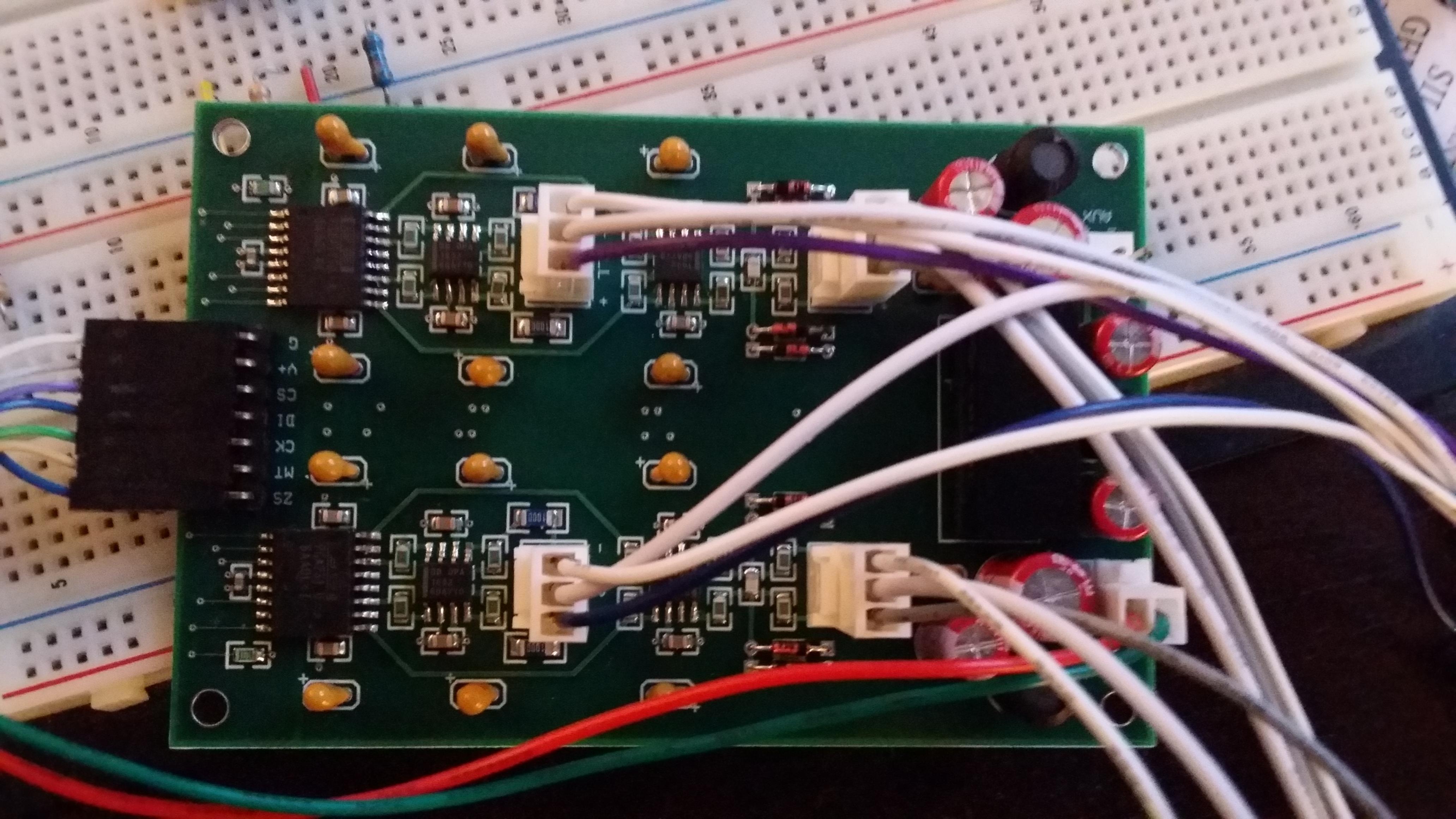

For the record, since I hate when threads trail off into nothing, I wanted to report back that I pulled this through to the finish line. The forum won't seem to let me embed images so here's some links.
Solder paste and components:
https://goo.gl/photos/RVxTCyqsQsmPao4N7
After flowing, through-holes parts and wiring:
https://goo.gl/photos/3FqAZkBcA1SVKz4m9

Are the PGA3211s running reliably for you? Another fellow and I have been experimenting with them for a while trying to figure out why some will lock up and/or burn up on volume changes. We seem to have cured it by changing the write speed of the code and moving the pull up resistors on the SPI lines right beside the PGA2311. I'm always interested in other's experience with these.
What kind of a uC are you using? I've built preamps with the PGA2311 controlled by Arduinos and they're running just fine without pullups on the SPI lines.
I'm also using Arduino. As far as I'm aware pullups are needed just like I2C. Possibly you just have better luck than we do because we've had this issue with a few different designs.
That's strange. I've connected all kinds of SPI peripherals to my Arduinos without ever needing pullups. The same goes for I2C. I've found that the internal pullups most of the times are adequate, unless you have very long cables or a particularly noisy environment.
Internal pullups are around 22K in an Atmega328. One or two devices will work fine with I2C if they are near by. If you are using a bunch of devices it usually won't work reliably though. I haven't found a definite reason for the PGA2311 failures but we seem to have them cured with external pullups and altered write timing.
I am also using an Arduino, specifically an Uno. No pull-ups on SPI, never seen anyone do that before. Before getting to this stage I was using a single PGA on a poorly routed bread board and never had an issue once I worked out the correct SPI settings. Maybe I was lucky but none of the reference designs I followed included them either.
