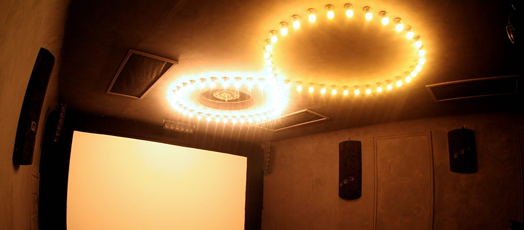

Toole's book was good read indeed. Coincidentally while still reading I've got a chance to build a sound for custom Home Theater room (everything is connected in this world, right?). The book has helped me a lot with this tasks and had already paid off. By now I'm close to finishing it. Speakers set contains 6 full-range drivers in each of three speakers built as curved/shaded/truncated line source dipoles as the front drivers and three same type drivers as four closed-type wide dispersion tripole speakers on the sides plus 4 subwoofers built into ceiling following 25%-from-sides recommendation. This explains a bit of the silence here in case you were following.

Seems I have to apologise for having done less than was expected from community during the period. But hey, did I mention any milestones?
Last four months I was a bit busy building speaker set for small indie cinema in Riga:
![IMG_2376_small.jpg IMG_2376_small.jpg](https://www.diyaudio.com/community/data/attachments/287/287783-27247d1e2ffe45e881f1ce58c858789f.jpg)
If you visit the city I hope you give it a try.
Building hybrid dipole/bipole speakers and testing effects of matching speaker electrical phase curves and physical alignment - coming soon!
I've also wanted to see whether lining phase up exactly between drivers would cause something magic to happen.
